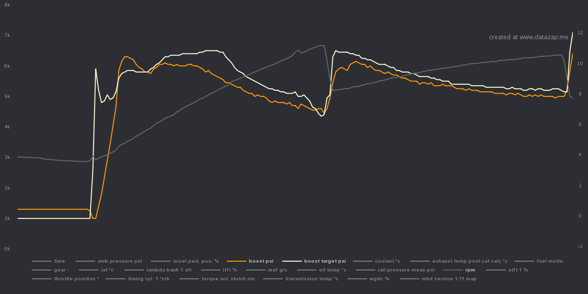

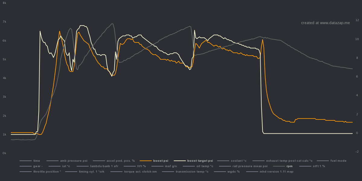

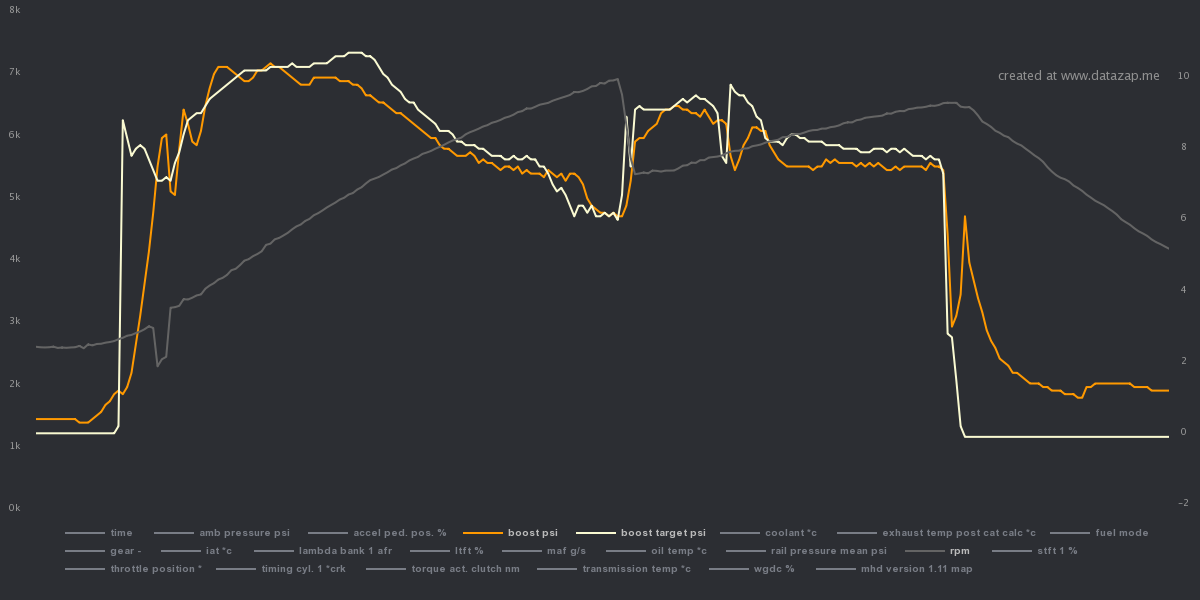

Here are a couple of short runs I did. CSV files above each of the respective graphs. I hope this works.
CSV - 19:49
>>>> MHD Log 19_49
CSV - 20:05
>>>> MHD Log 20_05

I may be reading this wrong but your boost is very eratic and doesn't seem to meet boost requirement very often it always seems to be +1psi less than target?
Next thing I noticed when I compare your CSV log to mine is your torque readings are very low. My car has stock software and I am getting readings of 475nm which equated to 400nm on the HM dyno.

I am quite armature with this, but I just read the first log and fueling seems ok, boost seems ok at all rpm. This log shows peak boost over 10.5psi and these operate quite close to boost target so don't see any turbo issues, or fueling for that matter.
Perhaps someone could assist with interpretation of the timing?

i must firstly say i am not 100% comfortable with mhd logs, however from what you posted i am not seeing anything screaming out and saying there is a problem. my concern is that your about 1 psi below target mostly and that your max wgdc is around 60% at max rpm... that is slightly higher than should be expected for that psi delivered. i would investigate your vacuum pipes, clamps and connectors for wear as a starting point and go from there.

As per Kish. Your logs are normal.
Flash the car with the appropriate MHD fueling stage flash and enjoy the car. Start worry when you lose power at 25psi not 9psi :rollsmile:
