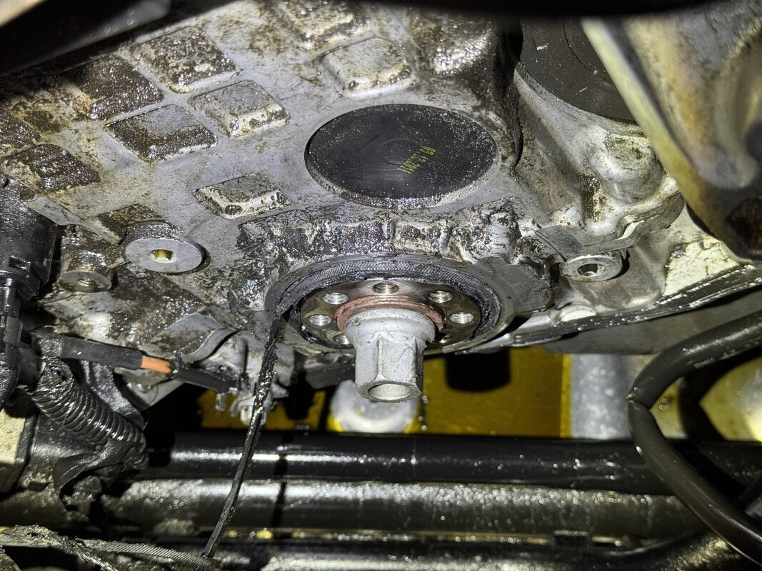

Which brings me to August 2024, where I finally took it to a track day at Killarney. And it was going well, no heat soak, temps all good. Within 2 seconds of my best time with the JCW (which I had more track days and PS4 tyres instead of RFT). Until something caused the belt to go, I'm not sure if the belt killed itself, if it got more oil on it, if the idler pulley went (it was utterly forked, found a ball bearing in my side skirt from it) or what. But it decided it was out and it was gonna take out the transmission oil cooler line and cause me to think I had blown the motor.
Thankfully it seems like the motor is good and it's just an expensive job in terms of replacing seals, pulleys, belt, oil cooler lines, etc.
I did as much as I could at home until I needed to get the oil pan off to ensure no belt is hiding in there or the oil pick up and shipped that off to the peeps that did the suspension install. And told them to fix any other oil leaks they find. Which appears to be rear main seal. So that's also a fun expensive job.
