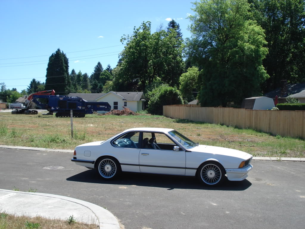

images
Just think... what it will go like when you are done.
PS> Back in 3 weeks... and will be available if you need a hand.
