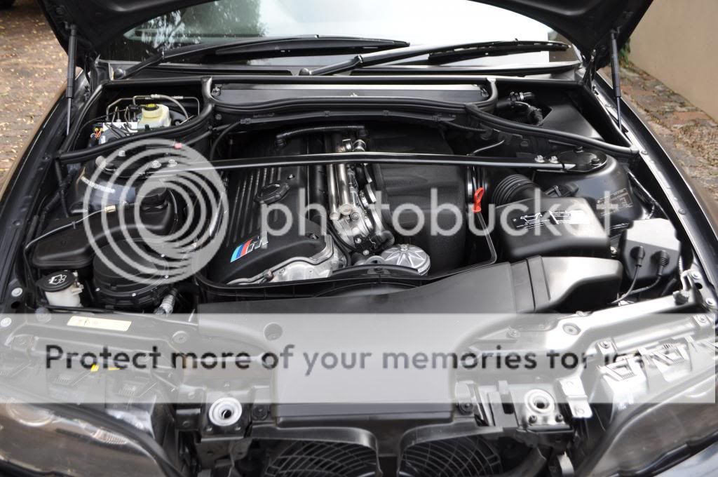

Gents been driving this afternoon and all I can say is if you have an S54 you have to, actually it should be compulsory, to book it in at Axis Engine Works and have the vanos and clearance work done and let Peter work his magic!
I thought the car pulled well before and had a sweet engine but it is now just that much sweeter!! It is so smooth throughout the rev range and the responsiveness is awesome! I can see now what Peter meant when he spoke about the smoothness of the S54 from the factory, my car now feels how it should!:praise:
Thanks again to Peter and Alex for the work done:ty:

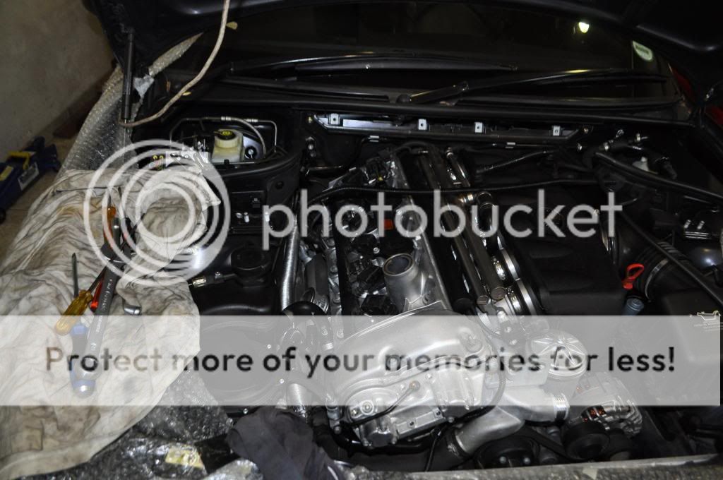

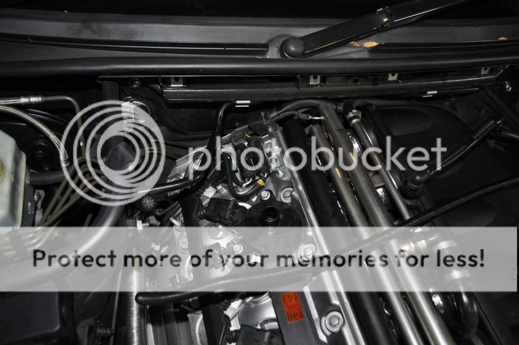

Andy as you well know I am passionate about the M motors as I believe that BMW created engineering art in putting them together.
We have specifically taken close ups and have explained the faults so that owners of these engines may appreciate the condition in which their cars are operating and STILL delivering incredible power for what is ostensibly a sick motor.
I get too much light bounce to accurately photograph the "rattle kit" so that users may see how the needle bearings score the disc.
(You will recall the pattern on your discs,I wonder whether you may be able to experiment and try and take some pics?)
On the next one we do if the owner allows I will post pics of the "rattle kit" as it comes out the spline shaft I doubt though our success in showing the wear pattern.

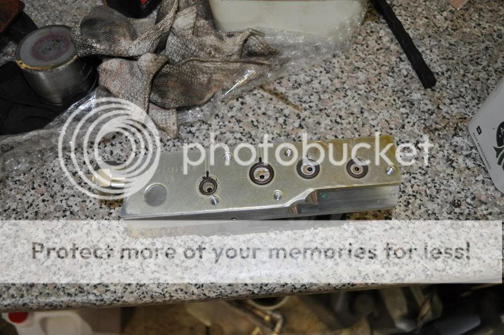

Plate seals changed
All the stuff that makes the engine go Booom fitted
Part of the stuff that tells the engine how well it went Booom.
