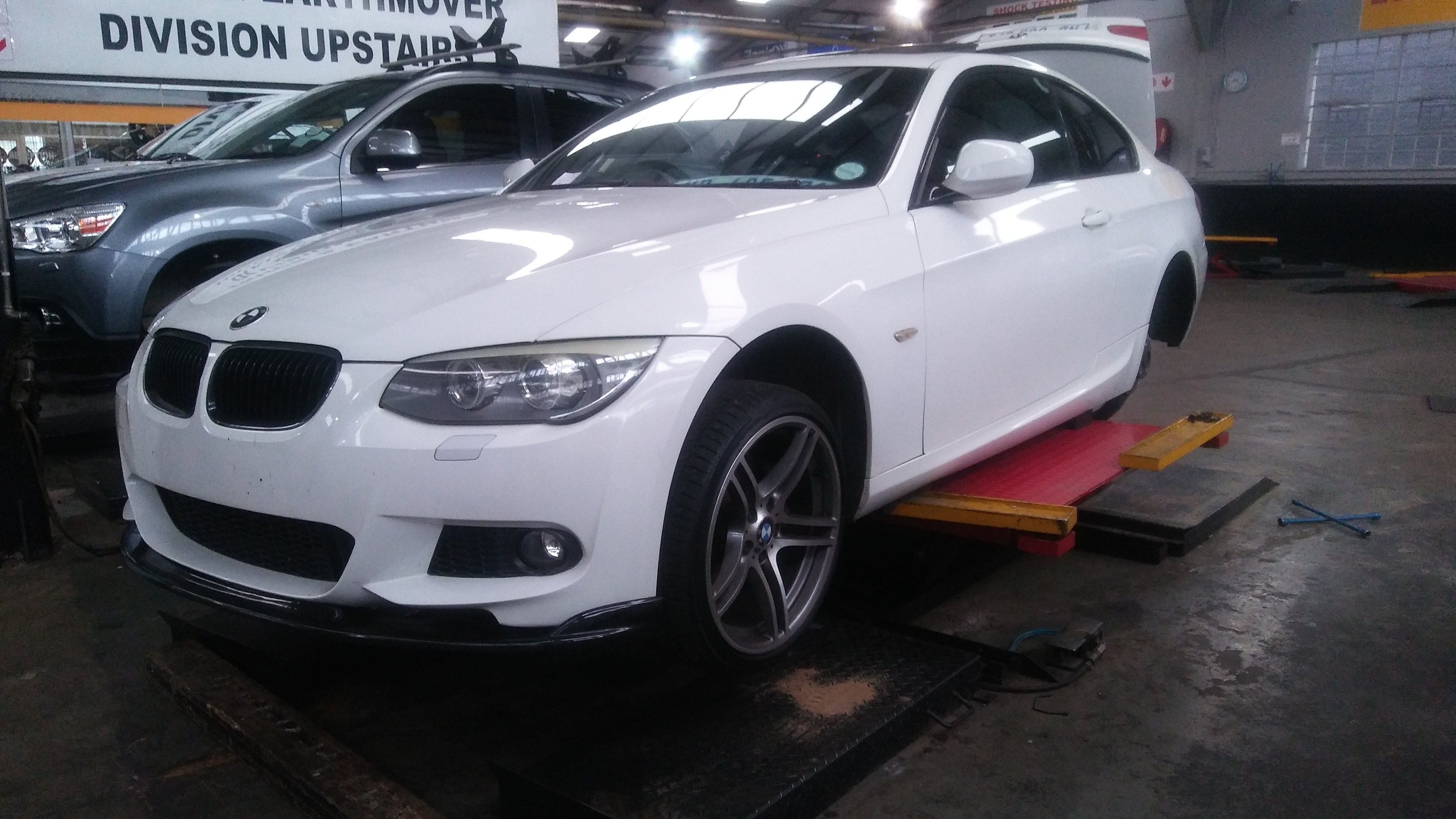

Was up early today. Visited Masterparts in Pinetown and purchased a set of Metelli rear brake pads. Previously had Sure Brake pads from Goldwagen which were average and lasted me all of 15000km :fencelook:
Got the car up and took the pads for sampling. Didn't take any other pics other than this
OBC showed that I had 9000km remaining but the pads were literally down to nothing. No errors were present so I reused the sensor. With the new pads it now still shows 9000km :roflol: But that's a problem for another day. Honestly not too phased with it either so will most likely leave it until the next change of pads :sleep:

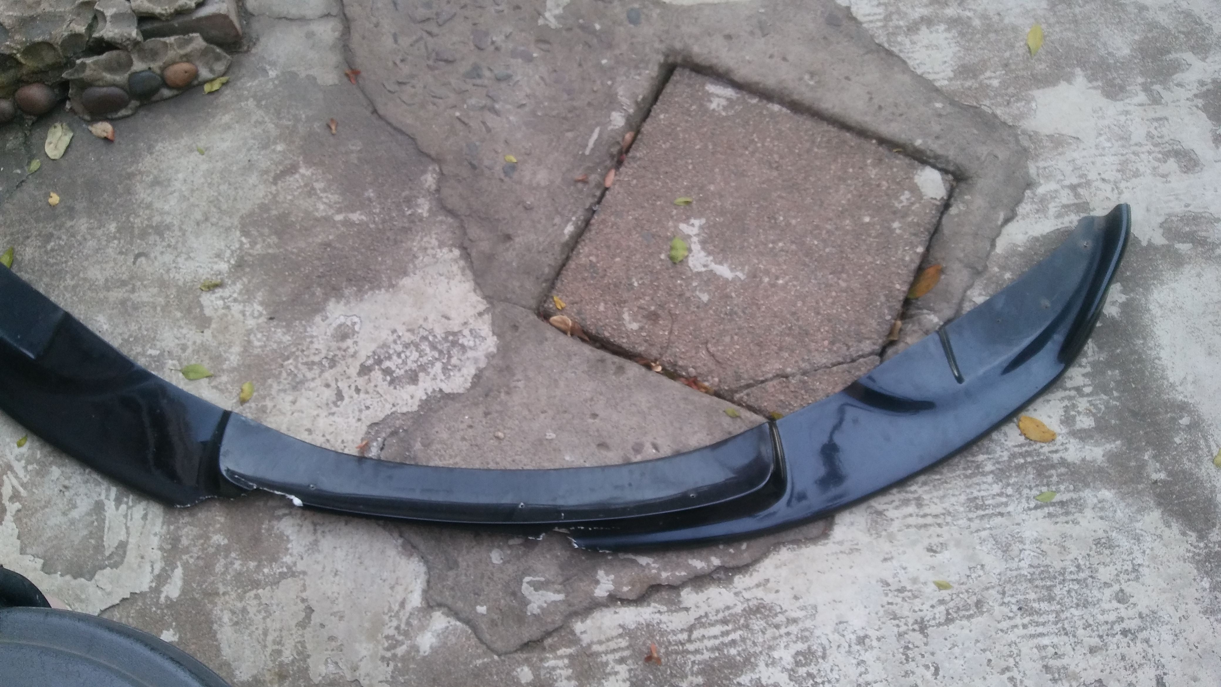

On the way back I noticed a loud clicking sound from the front of the car. Stopped to find out that the lip spoiler/splitter was grazed and the screws had come loose. I couldn't remove it as I didn't have any tools with me. How did this happen? No idea...
Anyway, it was butchered by the time I was back home so I have just removed it for now. Not used to seeing the front end of the car so 'naked'... :hammerhead:

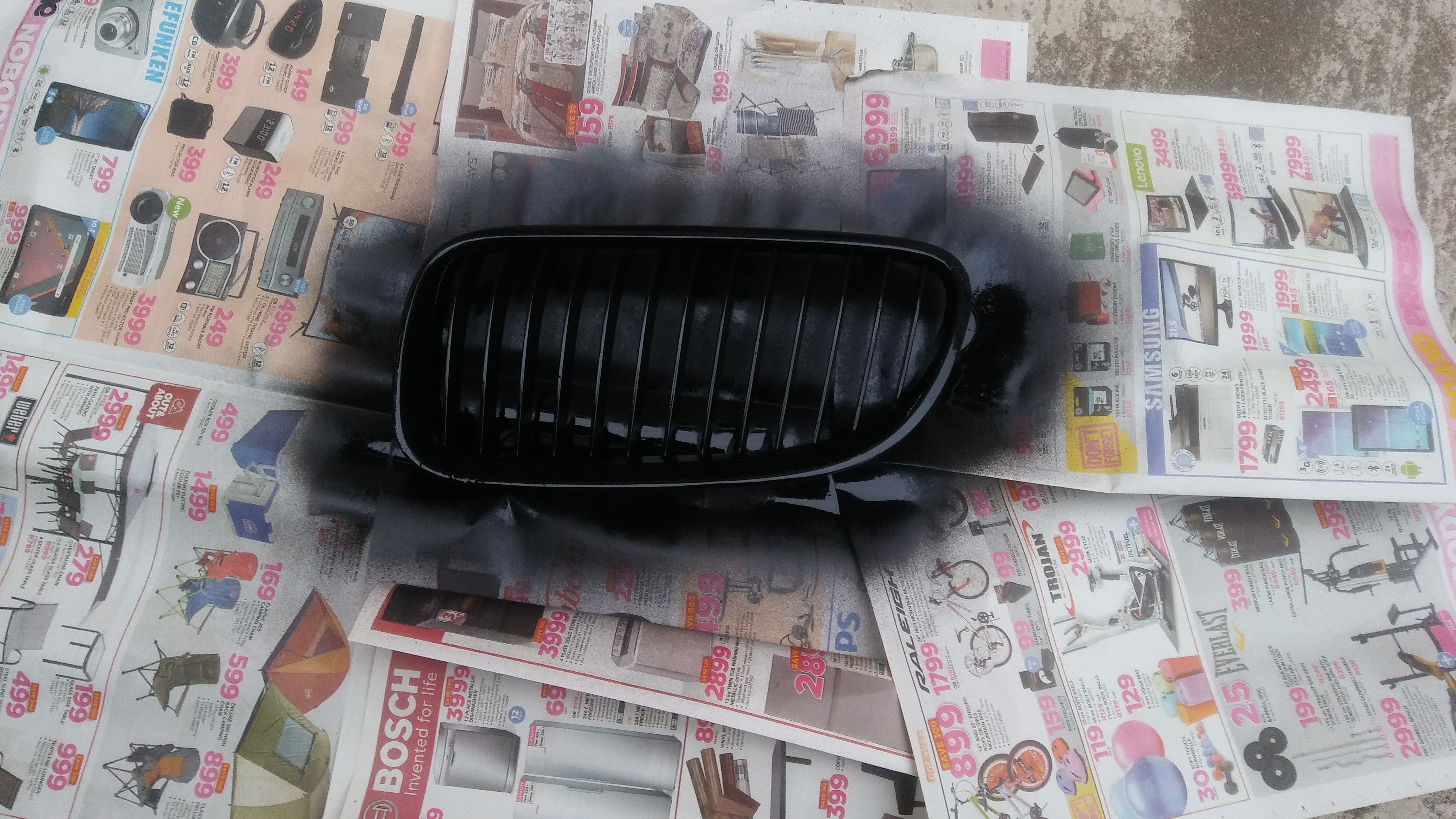

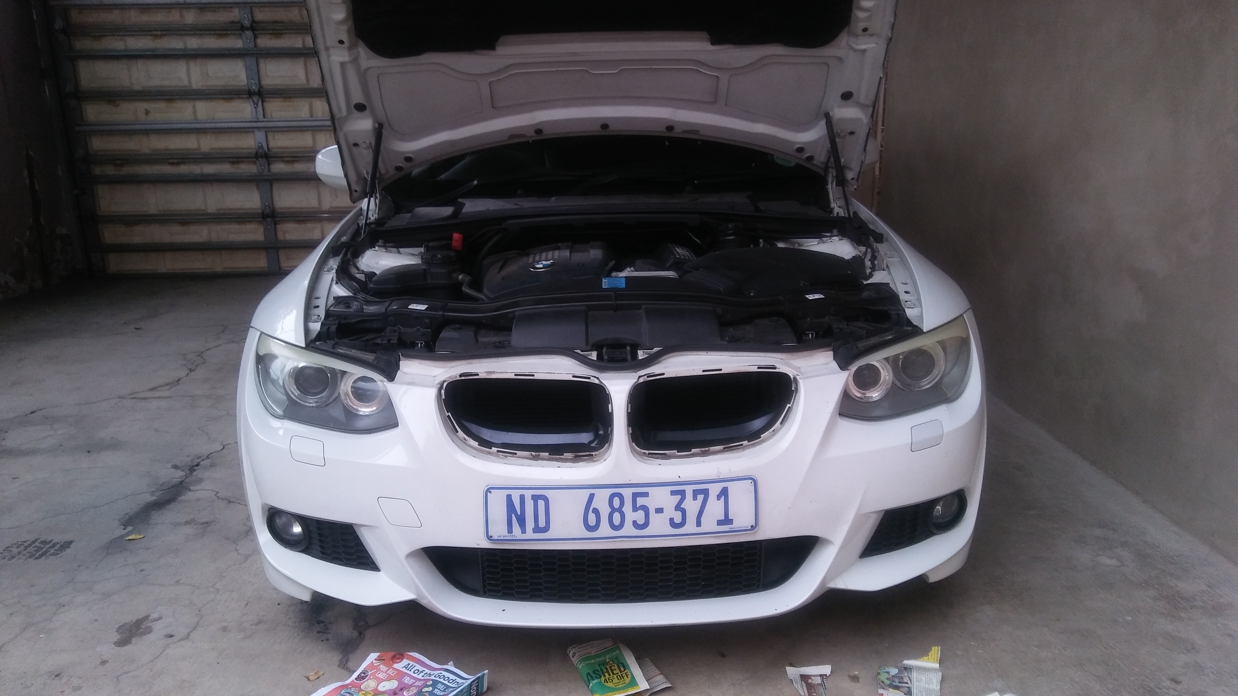

I had initially plasti-dipped the kidney grills (last year) which had then started peeling; exposing the chrome underneath in bits and pieces which was extremely disgusting to look at.
Had some time over the long weekend so I decided to get the paint compressor out and spray the grills in a gloss black. It was time for the matte black to go...
Removed the grills:
Required tools:
Torx Bit (T-30 IIRC)
Short flat head screw driver (which is what I had used)
How to:
1. Open the hood.
2. Remove the 4 torx screws on the upper section of the bumper.
3. Pull the top of the bumper forward to get to the back of the kidney grills. There should be enough play here but be gentle (doh!).
4. Unlatch the grills (each tab has little latch) with your fingers or a flat screwdriver. Be aware of what you're doing so that you don't scratch anything.
Left out to dry after being sprayed:
The result:
