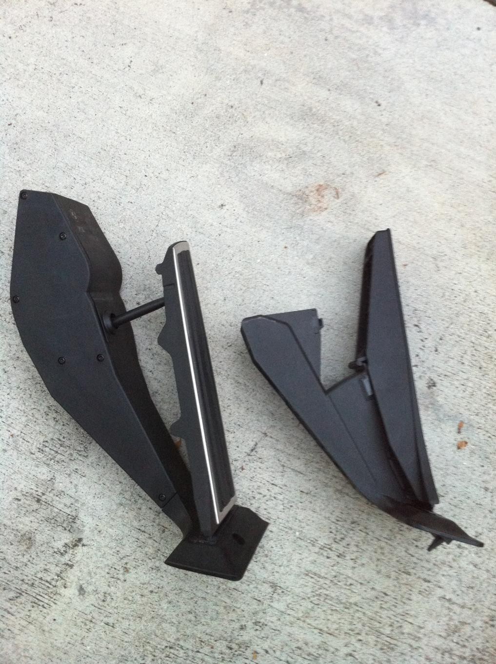

So - my milestone mileage came with an issue as well :hammerhead:
Driving on the highway (with no signs of any issues) and I get a CEL and the car goes into limp mode. :thumbdo:

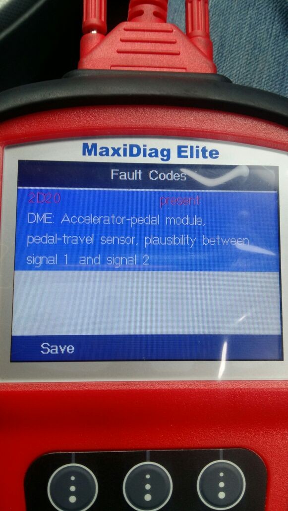

Got the codes read out and my accelerator pedal module had mysteriously given up on me.
I had the car parked off while waiting for a part (car was not used in about a day and a bit more) and once I started her up this morning - she drove fine with no errors or warnings, however, the error was still present in the OBD2 scanner even after clearing it.
Part finally arrived (I went the second hand route as the mech had a part for me and the stealerships price was not justified IMO).
The part came off of a 320i Auto (Apparently the accelerator pedals are the same across the board and can be swapped out as long as it matches the vehicles transmission ie a manual part cannot go onto an auto car).
Code has now disappeared from the scanner and hopefully the car is back to normal.
Noteworthy points:
1. Easy DIY - just unscrew the existing pedal, remove the connector and plug in the new one.
2. New pedal connected fine and is in working order however looks a bit different to my original one. (I didn't get time to take pics as I was rushing out to the office however I've found an image online which basically illustrates this)
Original pedal on the right. New pedal (with exception to silver trims) on the left.
