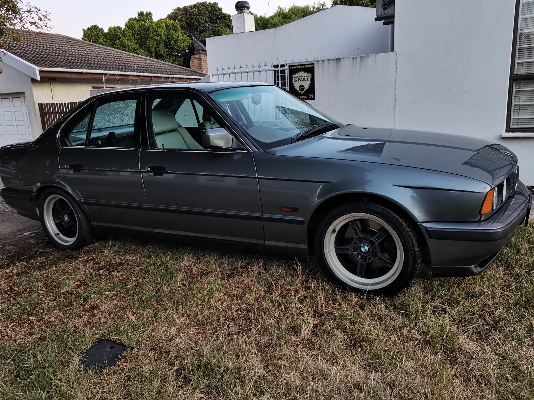

Hi gents, just refitted my loom and connected up some of the loose ends. Picked up a couple gremlins.
Seems like constant power to window switches and boot light. I imagine it's going to be something silly. I did pick up that the cables going to the boot were 41 on the old loom vs 45 on the new loom.
I got the following to work...
Central locking and alarm
Electric windows for 3 windows (I suspect this was due to the break in)
Rear lights all working
Electric seats
Need to sort out
Sound system
Sunroof
Figure out where all the bits go
And the start with restore
