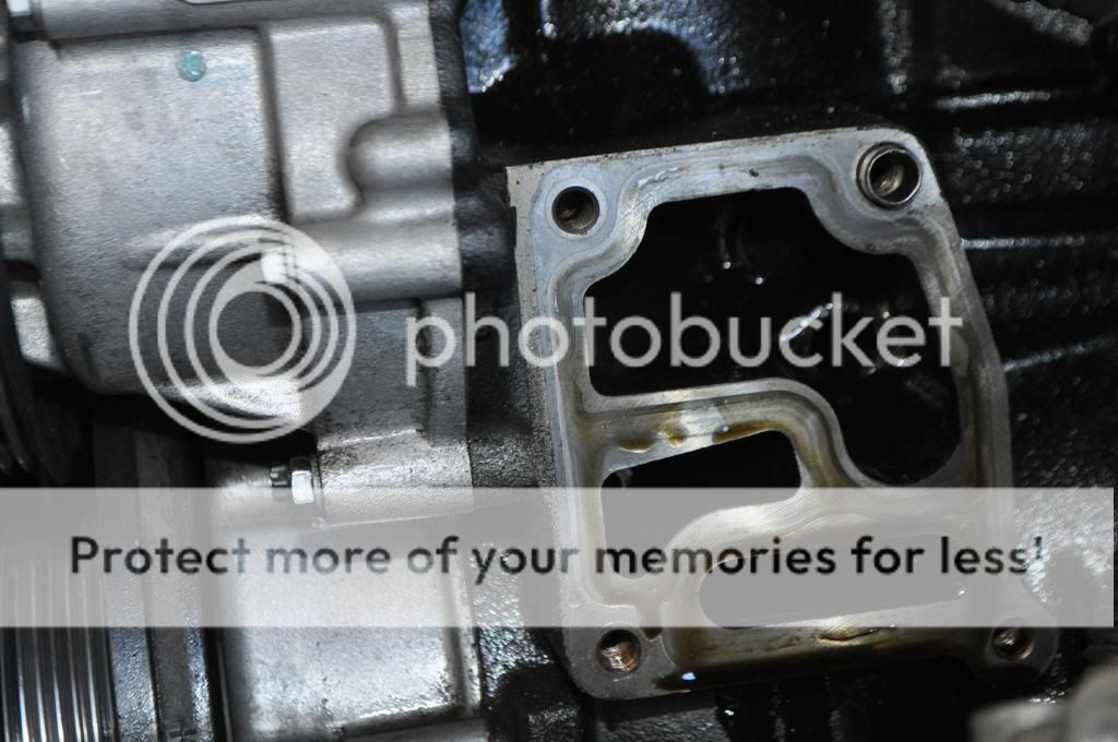

Just a small update.
Car was delivered yesterday afternoon.
Stripped the charger off and we are currently attending to a small oil leak from the oil filter housing.
Have already ordered the gasket and will be collecting in the morning so hopefully by Monday we should be ready to install the other "stuff"
At the same time we will source the correct flow injectors so as not to blow the engine and we WILL also get another air filter (the air filter that was used temporarily is from the small engine that Chris was previously running the charger on) and locate it correctly so that the charger can breathe.
I shall post pics of the progress.
