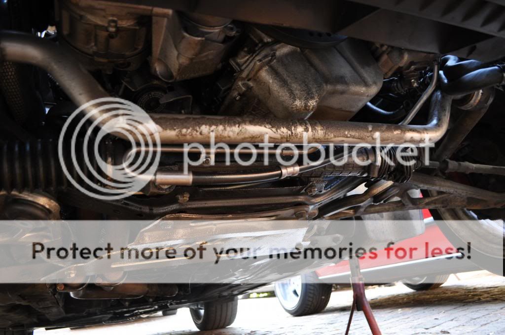

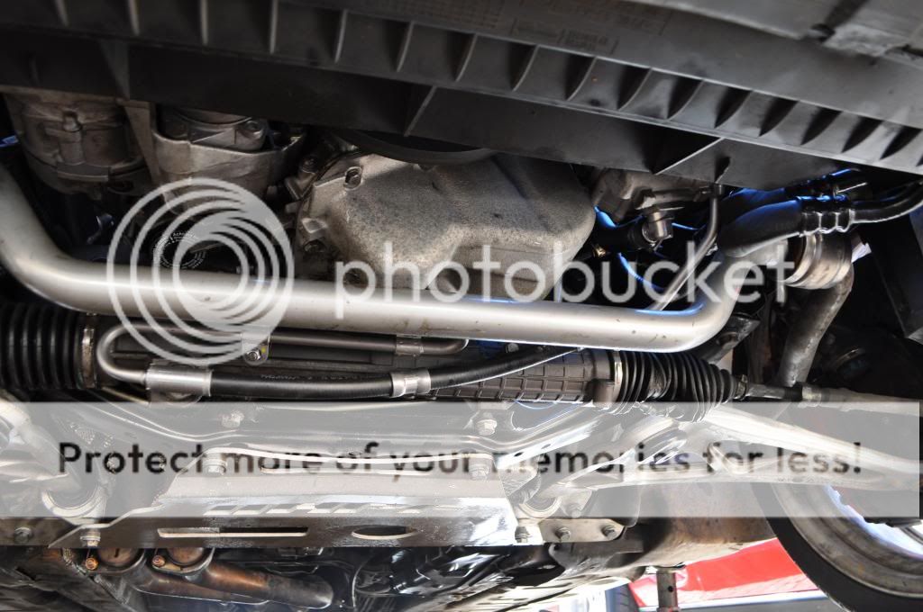

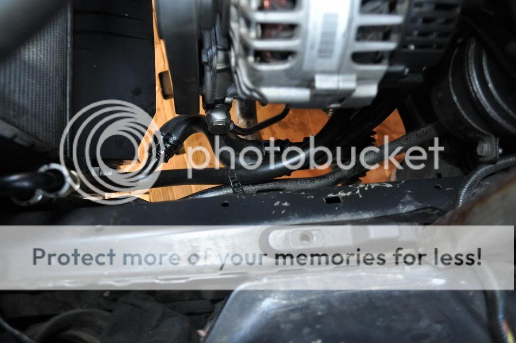

We changed the main power steering hose which appears to be a weak point on the M3.
After 3000Km
Just had a chat with Chris who had a go with a Jeep SRT.
Nita pulls effortlessly all the way to 8K and the power delivery is smooth with no hesitation as was previously the case.
Doubt that she can take 4PiPer however I am now positive that Nita will account for herself with a close to his bumper run.
Let us see........I shall encourage Chris to have another go before the snail installation.

Whats up with the inner left steering boot?Looks twisted or damaged in the photo.
