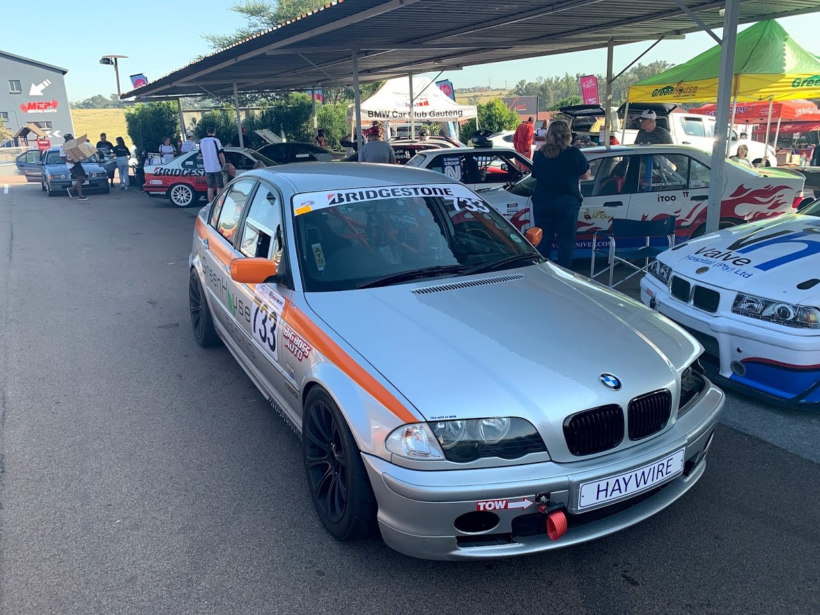

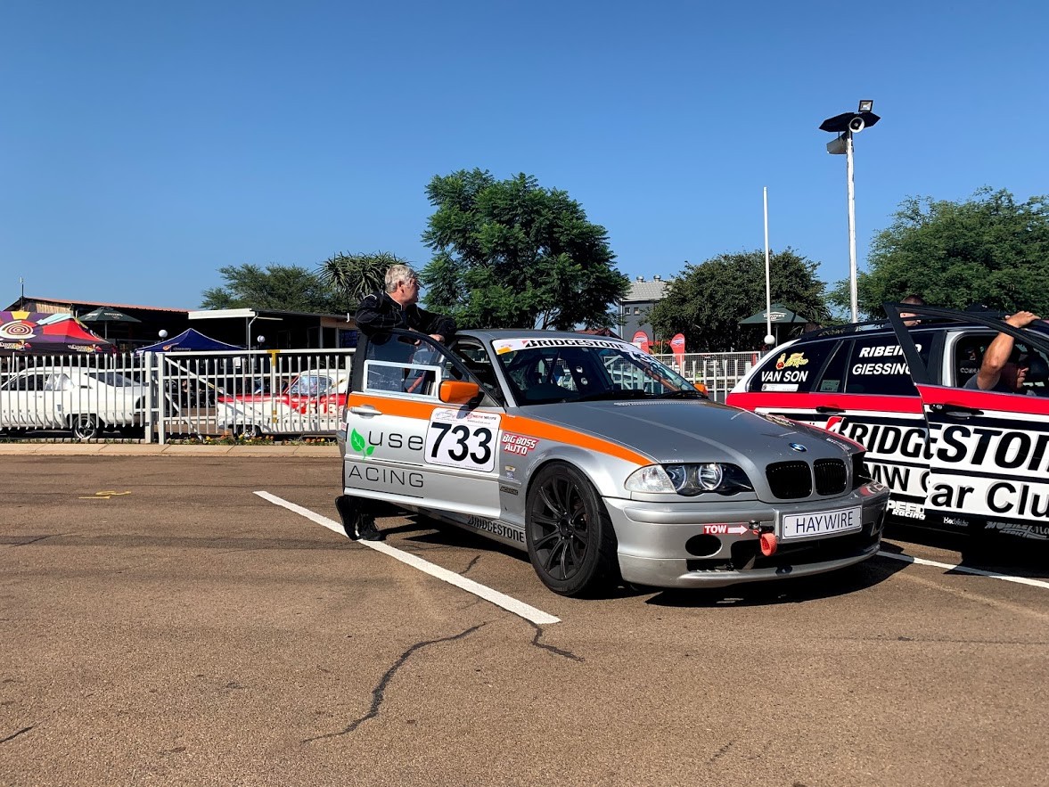

Here are a few photos from the race weekend:

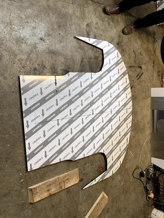

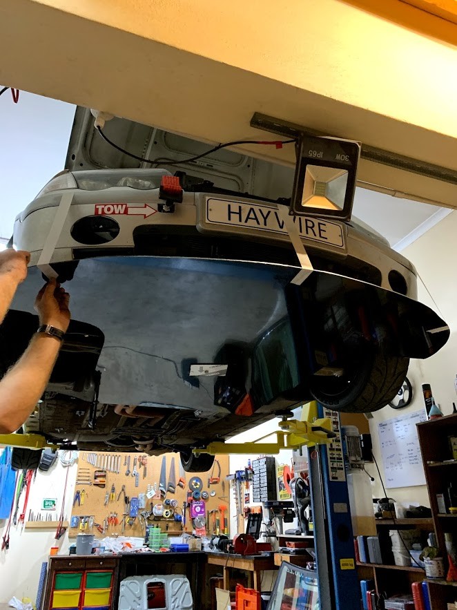

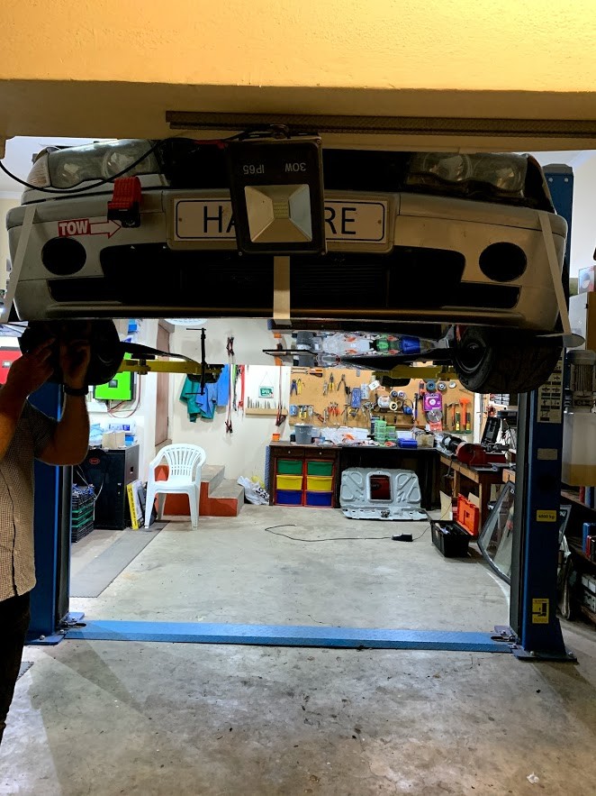

Alright, update time!
We've got a splitter!
Check it out:

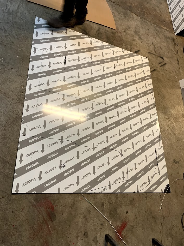

Step 1: Maizey I-Bond (Thanks for the suggestion Ian)

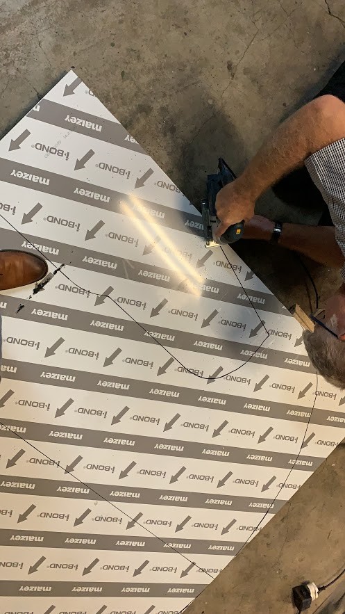

Step 2: Get the jigsaw out

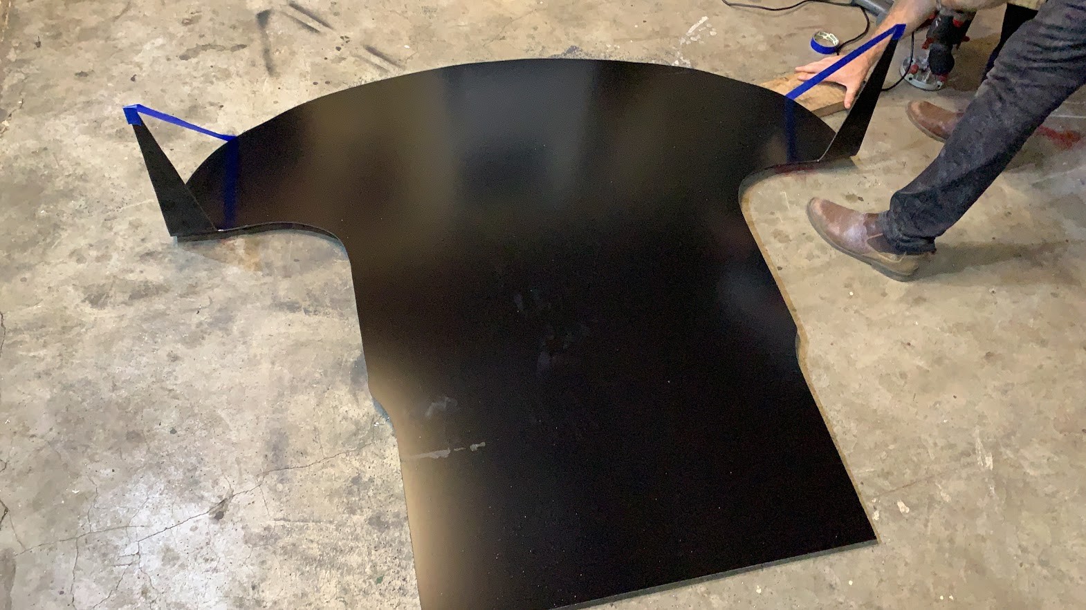

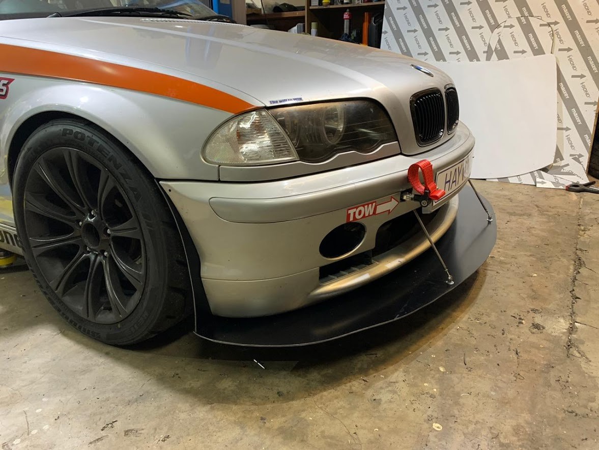

Step 3:
Step 4:
Step 5:
Step 6:
Step 7:
Step 8:

Great progress guys. It's like you read my mind with today's post. I was wondering about the aerodynamics side of things. I see you're addressing it. What else will you be adding after the splitter? Also (out of interest), do you think launch might be beneficial, or is it better-suited for the drag strip?
Salt
I have to ask what the purpose of that splitter install is please - and this is coming from pure ignorance :)
Mainly to look cool?.
But seriously, the splitter is essentially an aerodynamic aid - it “splits” the air
hitting the front of the car cleanly, separating the air which needs to flow underneath the car, from that which flows over the car, and in this case, through the front of the car for radiator, brake cooling, etc. In our case the latter is the more pressing issue - we need to ensure that we have good airflow channeled through the radiator, as we were getting cooling issues at the last race.

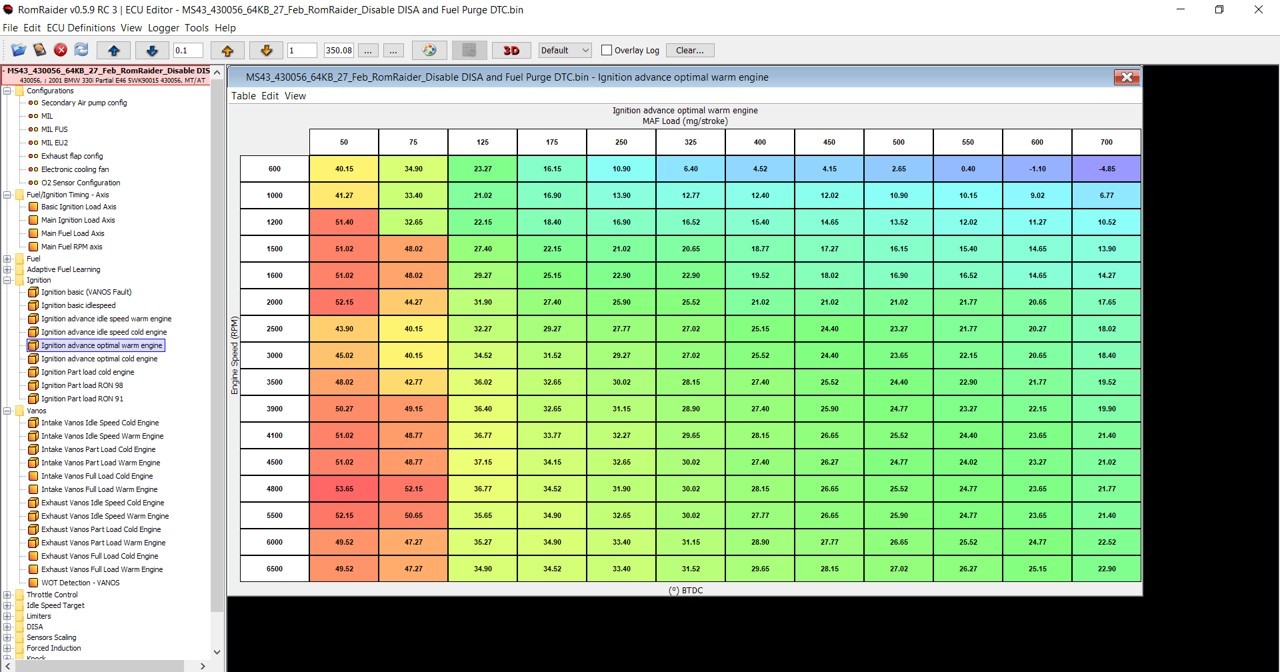

Here's a couple screenshots from Rom Raiders ECU Editor:
1. Ignition Advance optimal for warm engine

Crash_Nemesis
@Salt
A front splitter will also help with front grip as it forces the air under the car to move faster, causing a low pressure zone which sucks the car downward. The front tires will have more grip and you can enter corners faster.
Just bare in mind you would need some more rear wing to balance this out, otherwise the rear will lose grip.

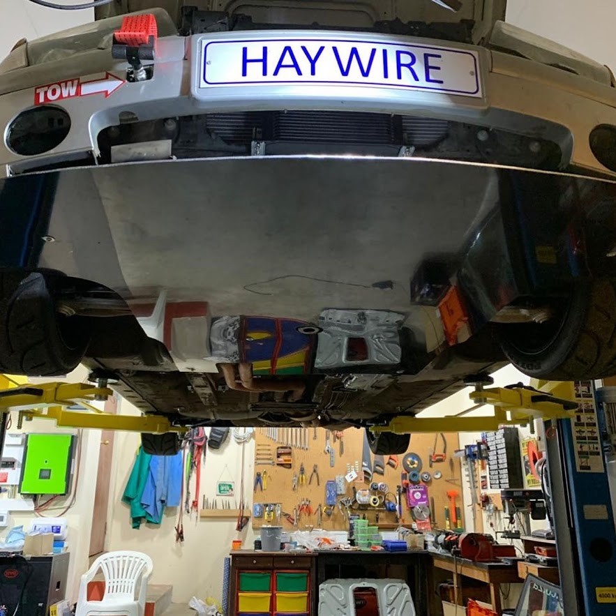

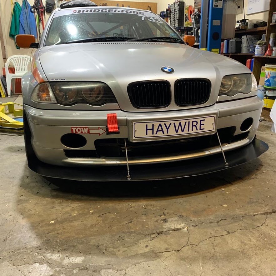

So we're long over due for an update and thanks to the COVID-19 lock-down, we've got some time on our hands to do just that.
To start off, here is a better shot of the car with the new splitter. I really think this is going to be a huge aid to our cooling system and to improve front end grip.

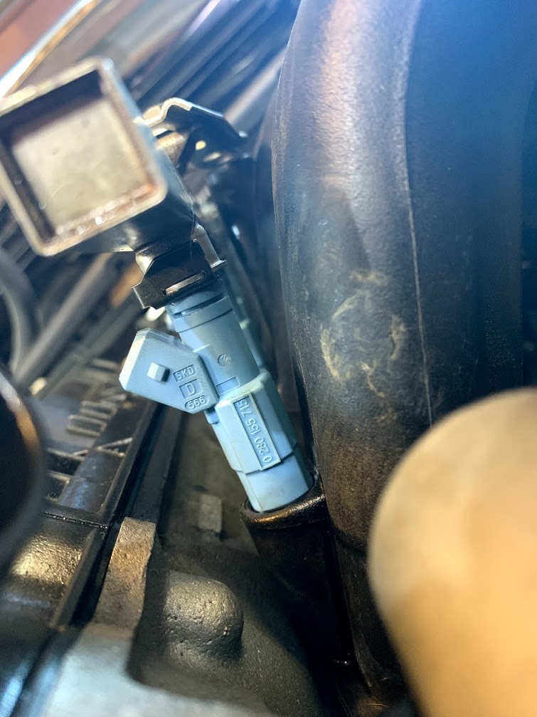

Next up, our new fuel injectors arrived.
We've gone with Bosch 24lb fuel injectors - 0 280 155 715
These injectors spray vertically out at 180 degrees from the injector, as opposed to the old injectors which had a spray angle to direct the spray onto the back of the intake valves. In the M50 manifold, the injectors have to be rotated by 180 degrees, which means that the old injectors would spray up towards the intake manifold and not onto the back of the intake valves as per design.
Here is a picture of the new injectors installed:
When we started up the car for the first time with the new injectors, the car ran horribly rough and sounded like it was misfiring on at least one of the cylinders.
It turned out that we had a bad fuel injector on cylinder 1. Fortunately the kit that we purchased was a bundle of 8 fuel injectors, so we swapped that injector out and the car proceeded to start and run without any problems.
