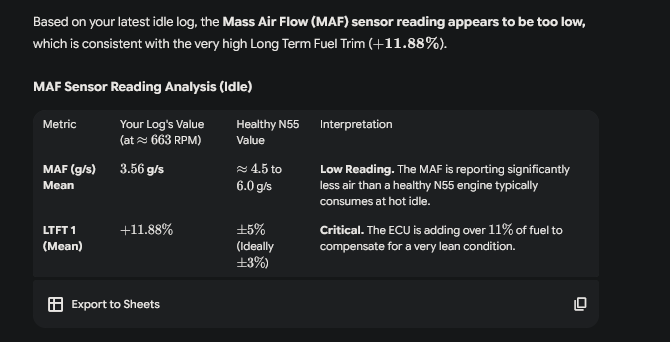

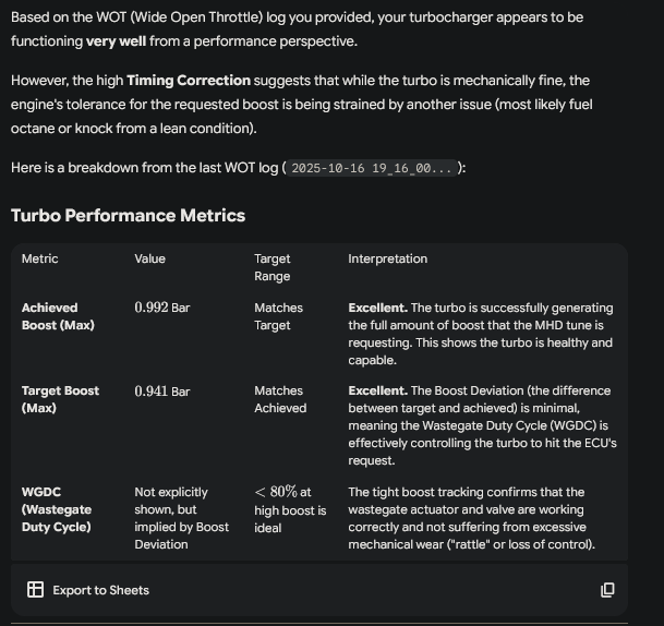

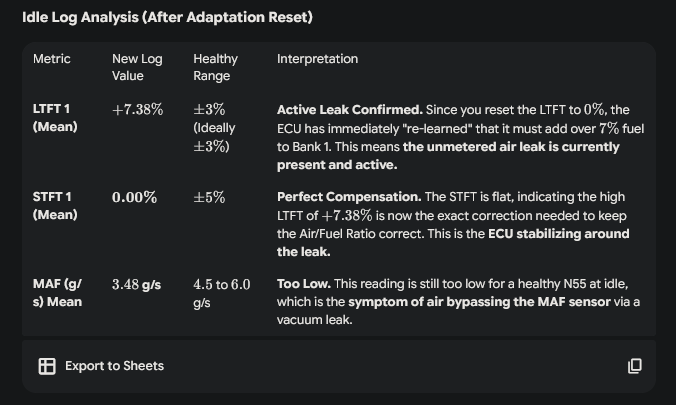

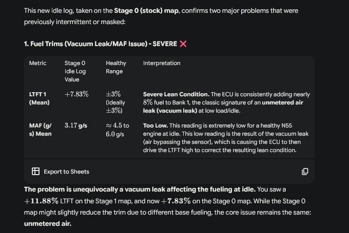

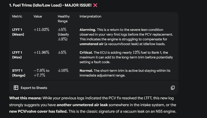

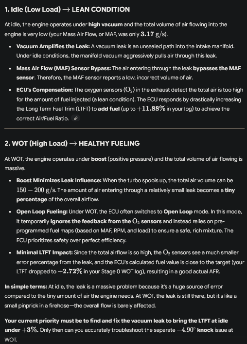

If anyone can help me point out some things to look out for to look at please let me know. I will be posting screenshots and a Datalog link for everyone to look at and to help me know that this is a vaccuum leak and that this would hopefully not destroy my bank account

A vacuum leak is suspected. The fuel trim at idle and lean spikes at low load strongly indicate unmetered air. This can be anything from the charge pipe, diverter valve, intake manifold gaskets, valve‑cover (Yes, I know you just had this done, I've had a valve cover replaced that was never torqued to spec, and it caused problems), etc etc etc

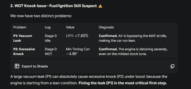

Check cylinder 2 ignition and fuel. During the WOT pull, the ECU repeatedly pulled 2 to 6 degrees of timing in cylinder 2, indicating knock control intervention. While this could also be caused by the shit fuel we have, you should ALWAYS be mixing at least 10% eth at the bare minimum when running a tune on these motors to eliminate that as a possible cause. You can also replace spark plugs and swap the ignition coil from cylinder 2 to another cylinder to see if the knock migrates.
Always reset adaptations after repairs. Clear the fuel‑trim adaptations and perform a fresh learning cycle. This is a must and only takes you 10 seconds. I can't stress this enough, as I've sat with random fuel-trim gremlins that simply go away after resetting adaptations.

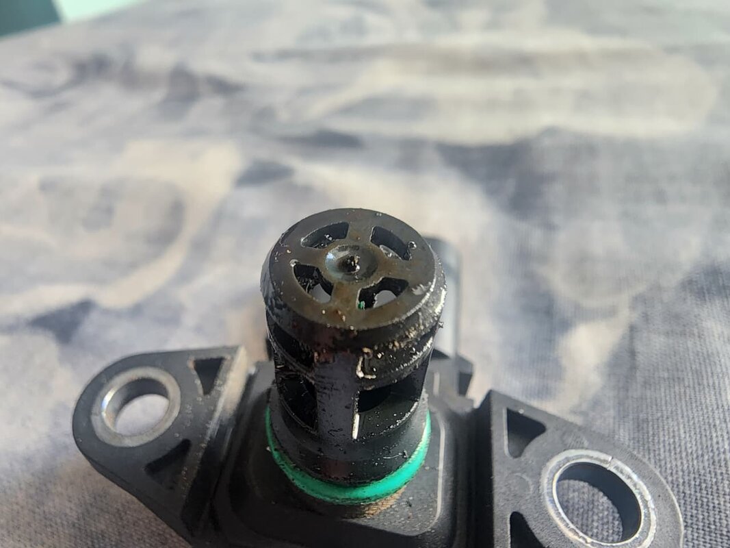

Upade: Today bmw told me that they couldnt find the issue and that the smoke tests showed no leaks. I felt hopeless but then i tried something. So after i had a pcv failure I went to go look at my MAP sensor, it was cooked with oil. Gave it a proper clean with MAF cleaner and put it back in the car and she's back to normal!
