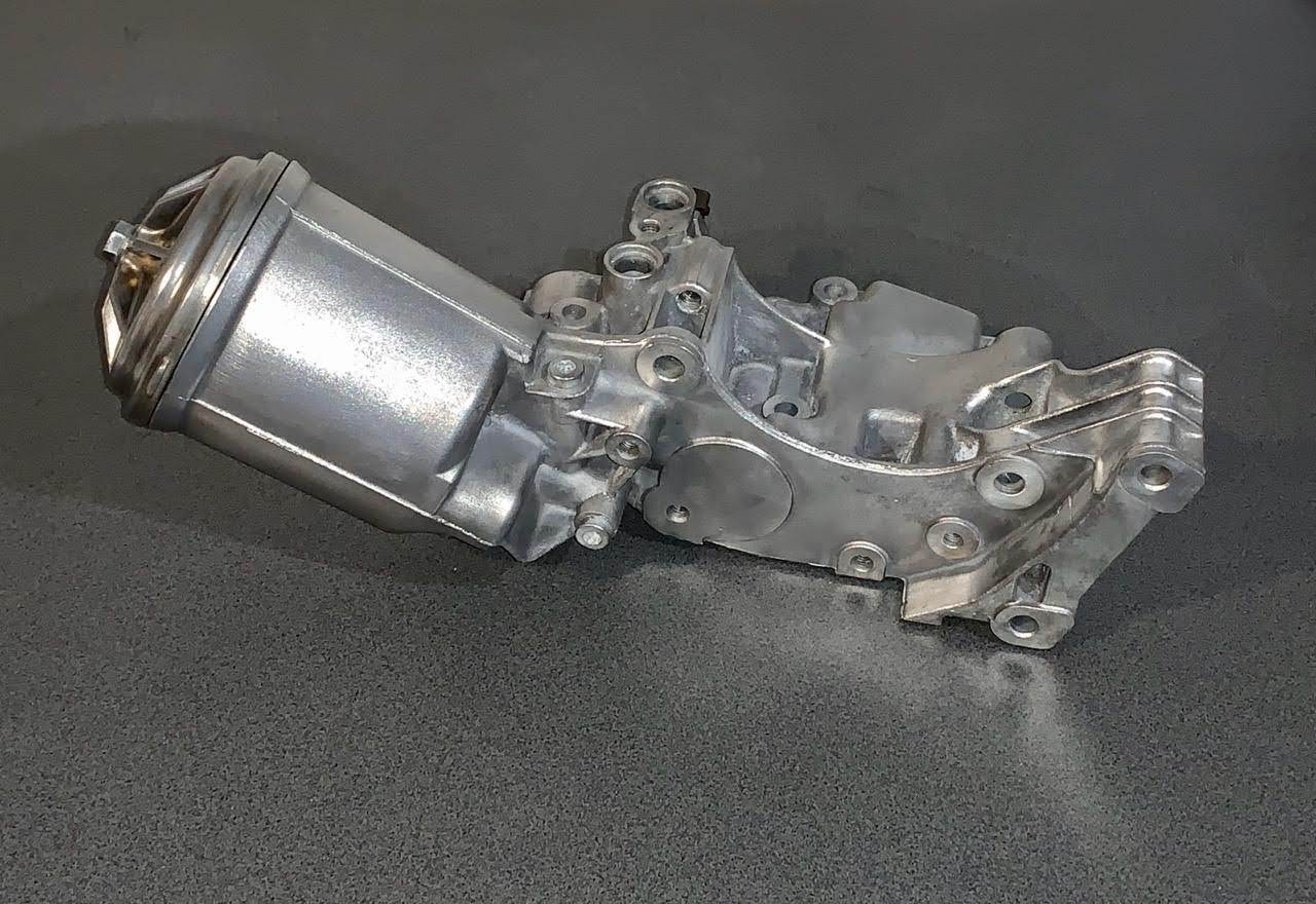

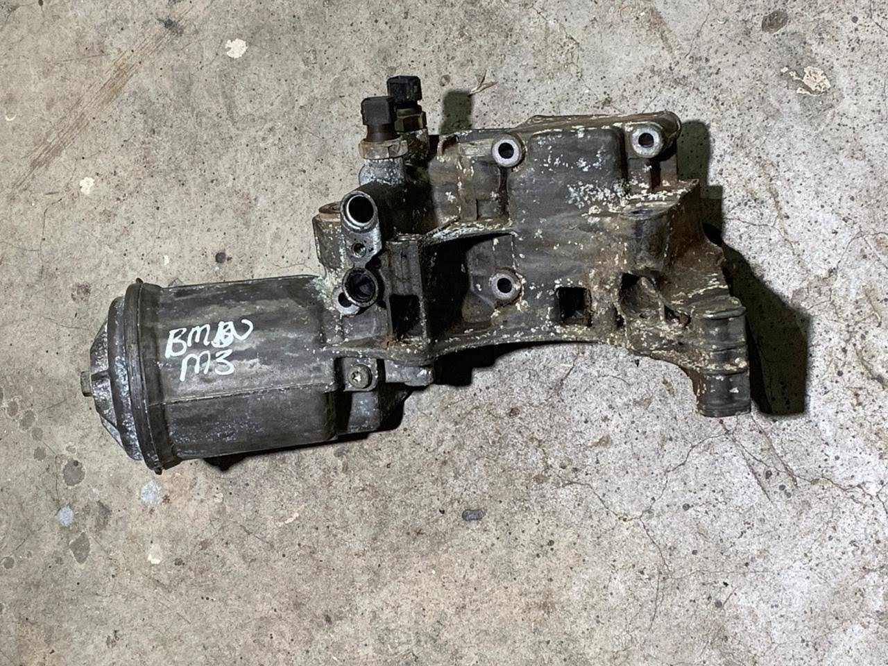

Here's a before and after of the E36 M3 oil filter we found - a common upgrade for M54 track cars in order to accommodate an oil cooler.
A swift wave of the wand and she looks like this:

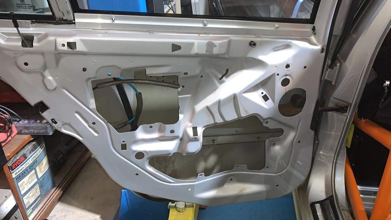

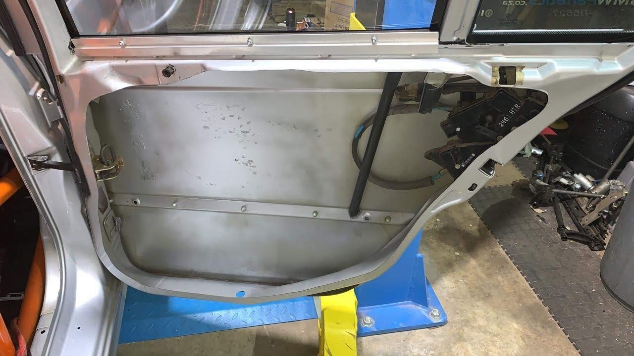

So the race car is still quite a fatty. Need to shed some (more) weight.
Craig got busy with the doors and gutted them some more.
And Ta Da!

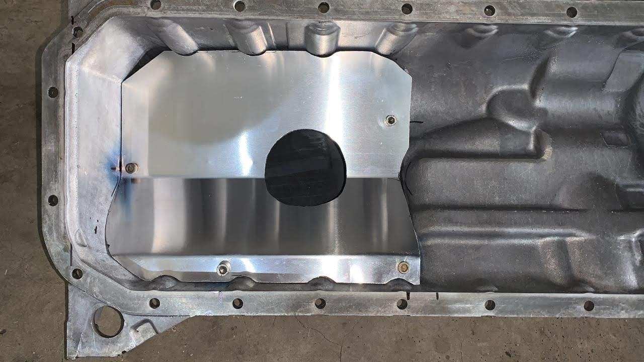

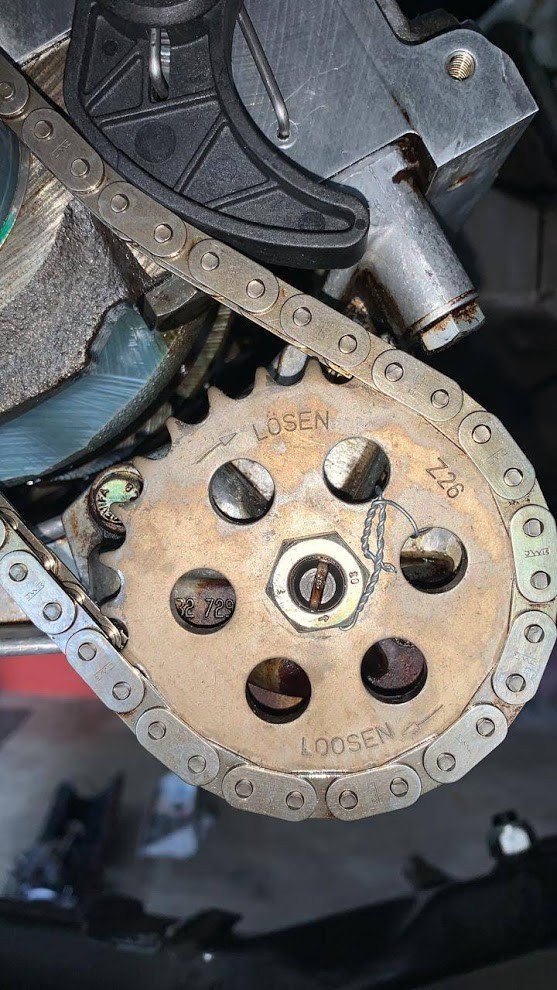

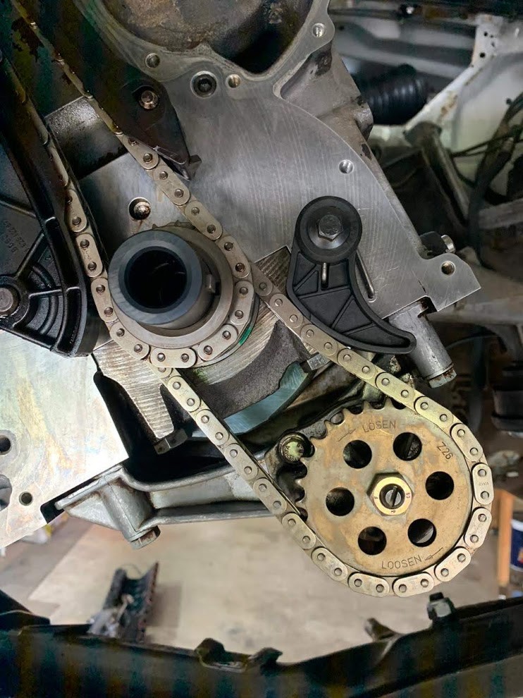

Here's some pics of the drilled and wire secured oil pump nut, as well as the chain tensioner for the oil pump drive.
Oh, and here's the custom oil sump baffle!

Nice stuff bro, I'm assuming you have the 3.0L because of the oil drive nut fastened down. Keen to see what other mechanical mods you're gonna do.

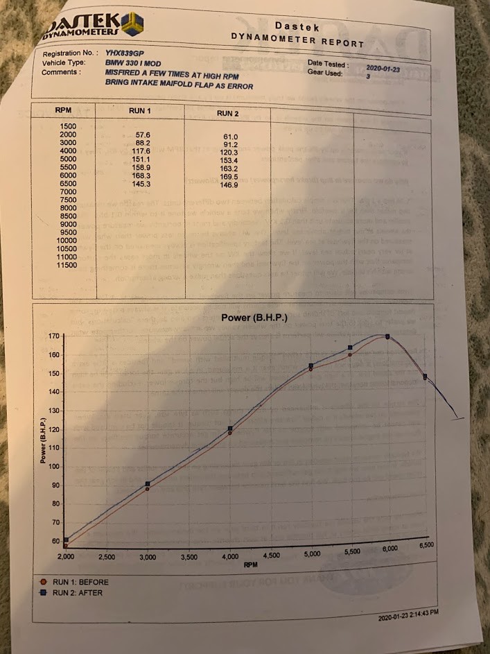

So here is the dyno result from last week Thursday (23 January 2020):

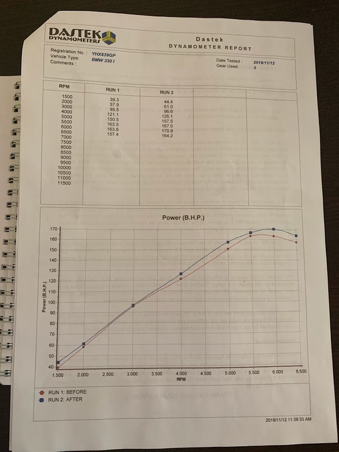

And here is the dyno result from the 12th of November last year (2019):
As you can see, we're making less power (throughout the rpm range) and there's a much sharper drop off in power between 6000 rpm and 6500 rpm.
This is wholly counter intuitive with respect to the modifications performed.
Quite a disappointment after spending a lot of time and money implementing an assortment of "tried and tested" modifications.

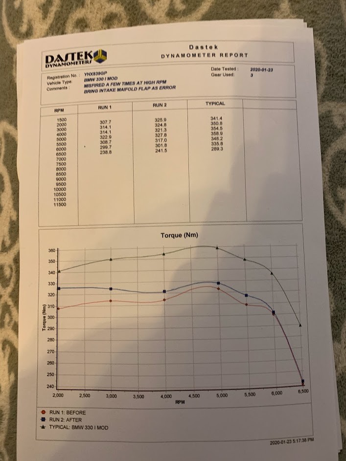

While we are very aware that absolute figures from a dyno are all relative, we're quite certain that the motor is not producing what it could/should. Here is a comparative torque curve of the strongest BMW M54B30 that they had on their dyno, versus our current torque delivery profile:
Again, significant disparity between the power (torque) output of 2 similarly modified engines. The "strong" M54B30 car referenced above did have upgraded camshafts though, besides that, both vehicles were of similar composition.
