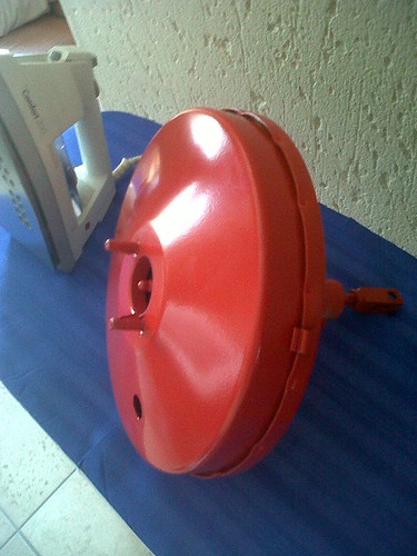

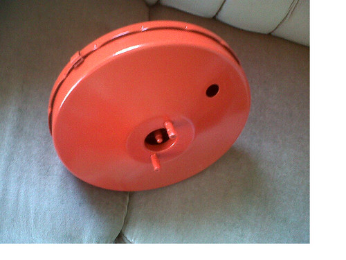

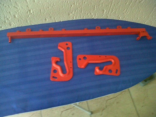

Had some stuff powdercoated red to run a red and white theme through the bay, the white was getting a bit clinically bland.

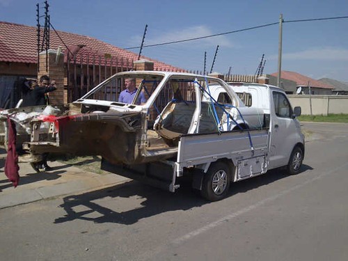

Progress: My car has some rust on the base of the A pillar and the drivers side shock tower. I decided to buy Javeds Shell as it had great condition fenders and the price was right. So we loaded the shell up on a little bakkie and drove it 30 kms home. Later that day i high pressure hosed it and cut it in half sold the rear for scrap metal.

Nic_s said:
Ironing on paint... what will they think of next :):)
Looking good :thumb:
I actually LOL'd at that! HAHAHAAHA
Im the only one who irons my clothes, if there was a way to iron on paint i would know by now:=):
