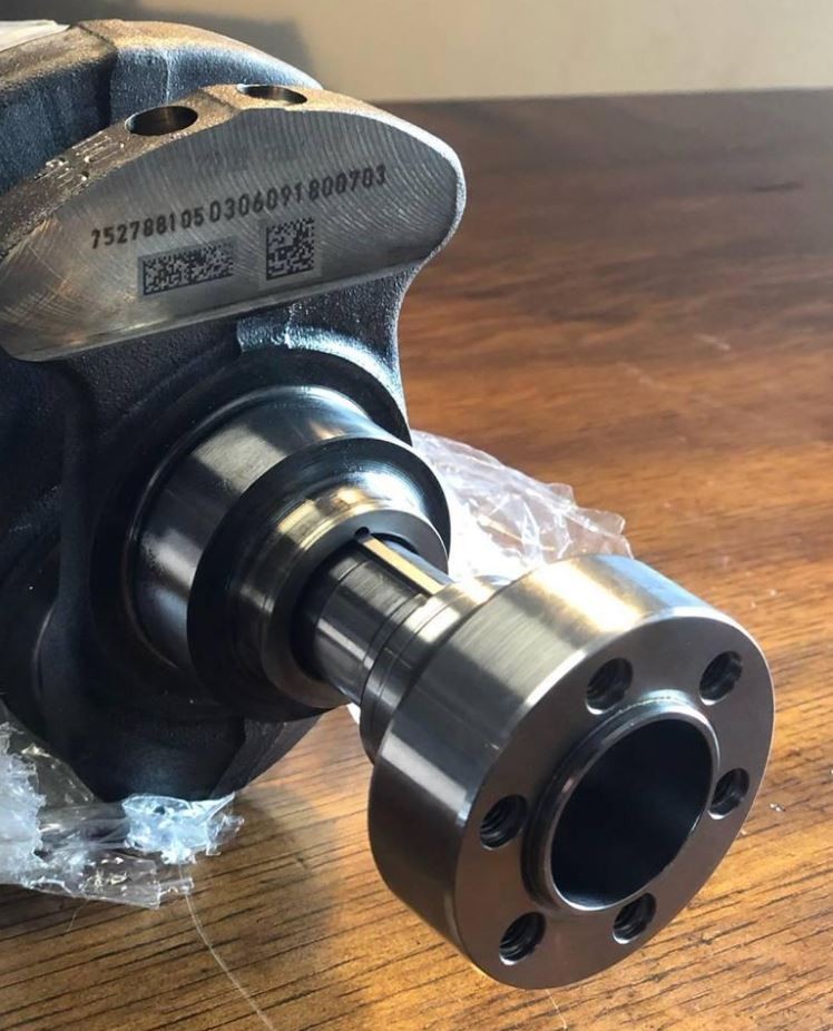

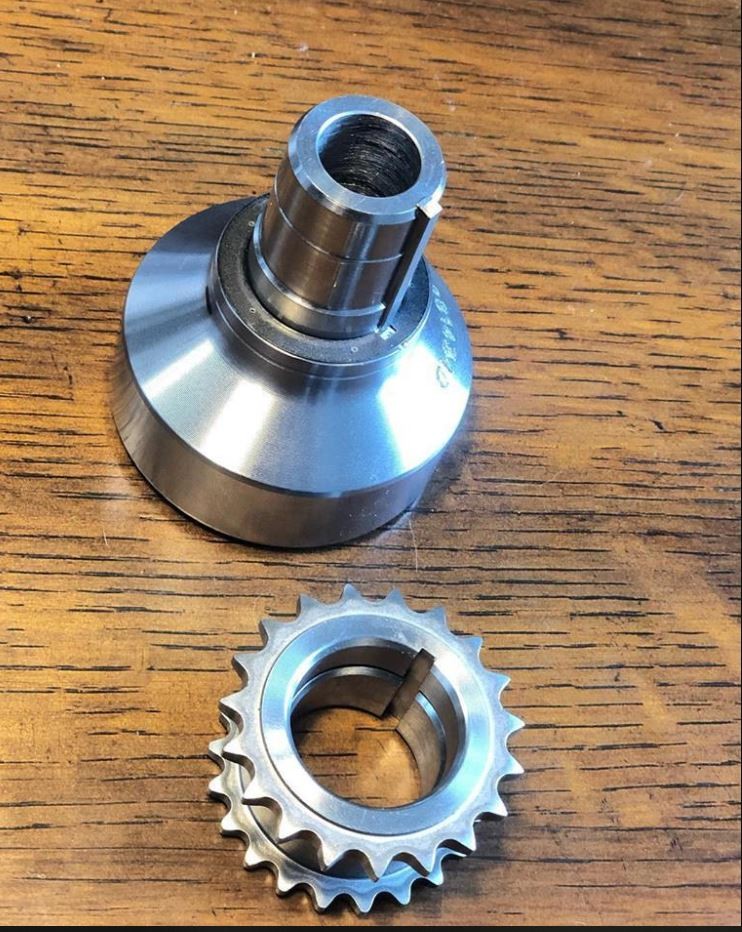

So I decide to bite the bullet and buy an upgraded crank hub.
I chose the VTT one for a couple of reasons, Price and ease of installation that said it would not make a difference because the motor is stripped down.
on receiving i realized the shaft on the upgraded one is +-1.5mm smaller than the original one (Where the oil pump gear fits) apparently i just need to buy the newer sprocket/gear and it will work. I have ordered one so will find out later today.
