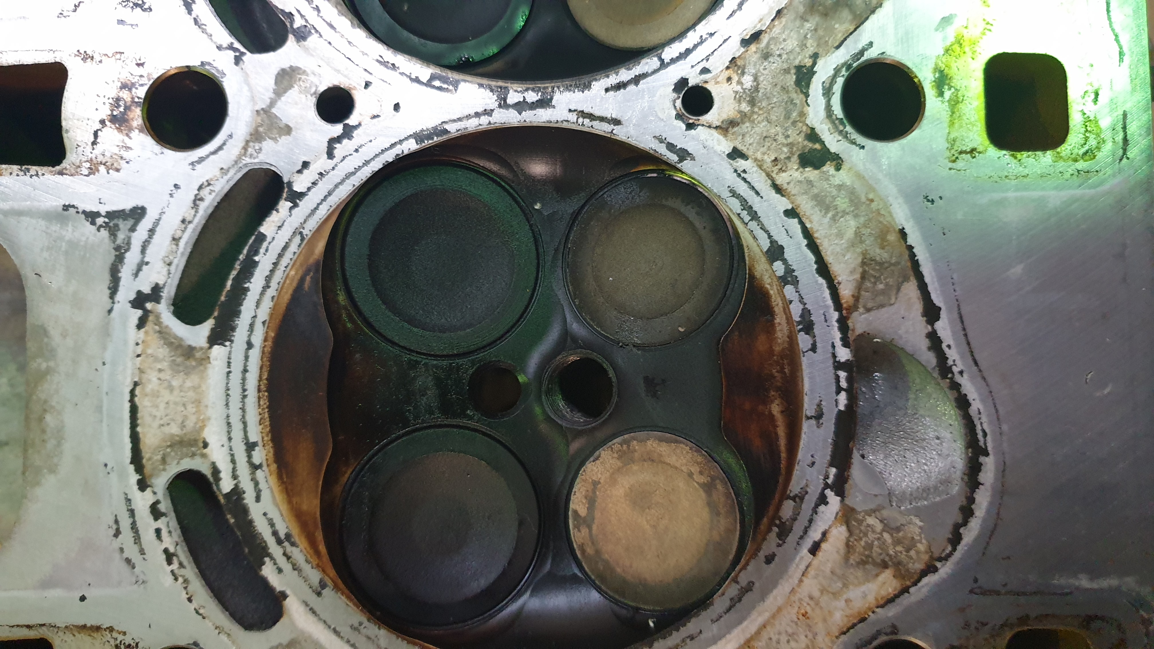

What was wrong with the head in the end? I don't see anything obvious.
I think the valve stems are stuffed, I sent the head up to JHB and I went over to the USA on business, I didn't followup when I got back everything was crazy with the CONVID 19 crap.
if you look at cylinder 5 valves you can see a slight difference in the intake valve color,
I don't have a pic but the inside of the inlet port was also wetter with oil than the rest.

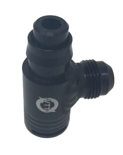

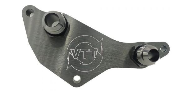

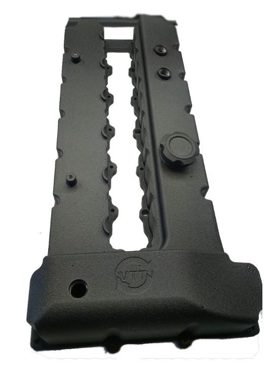

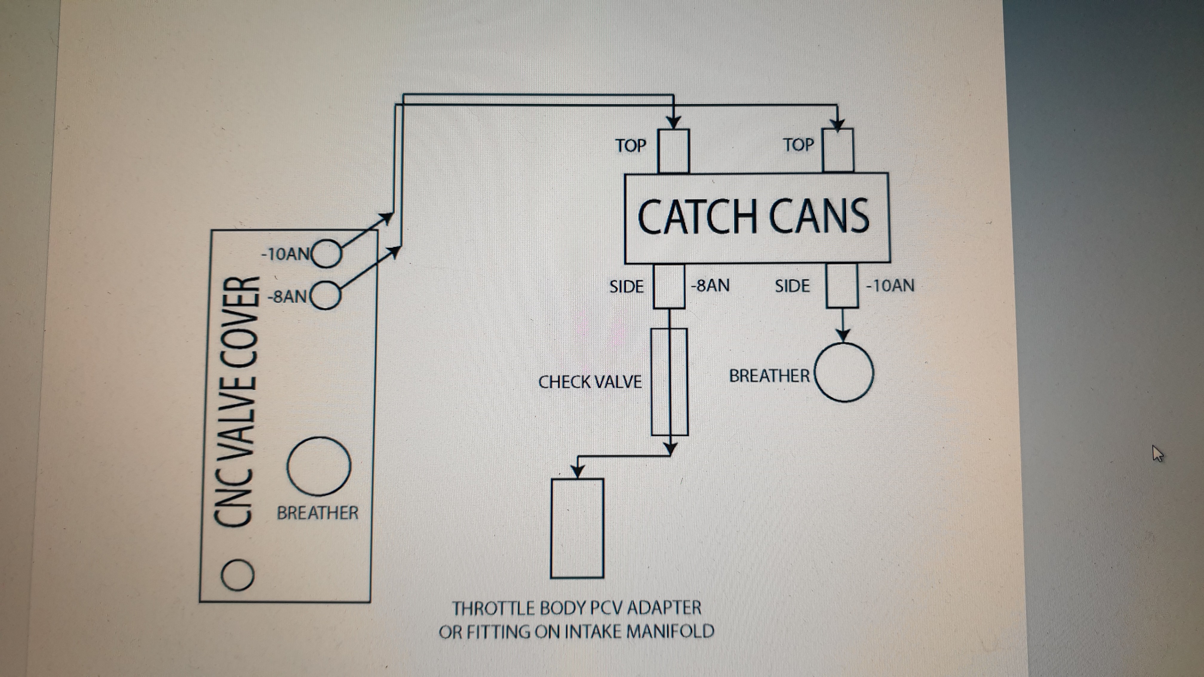

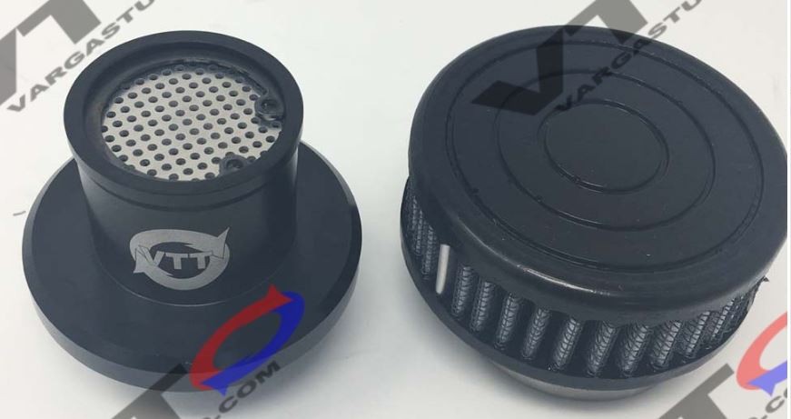

some pics from his website, with the VC I will get a lot of fittings, the main goal here is to make sure I don't have problems with crankcase pressure, my target was 28psi on stock internals but now I will try for 30psi with forged pistons.
I ordered a smooth gloss black VC

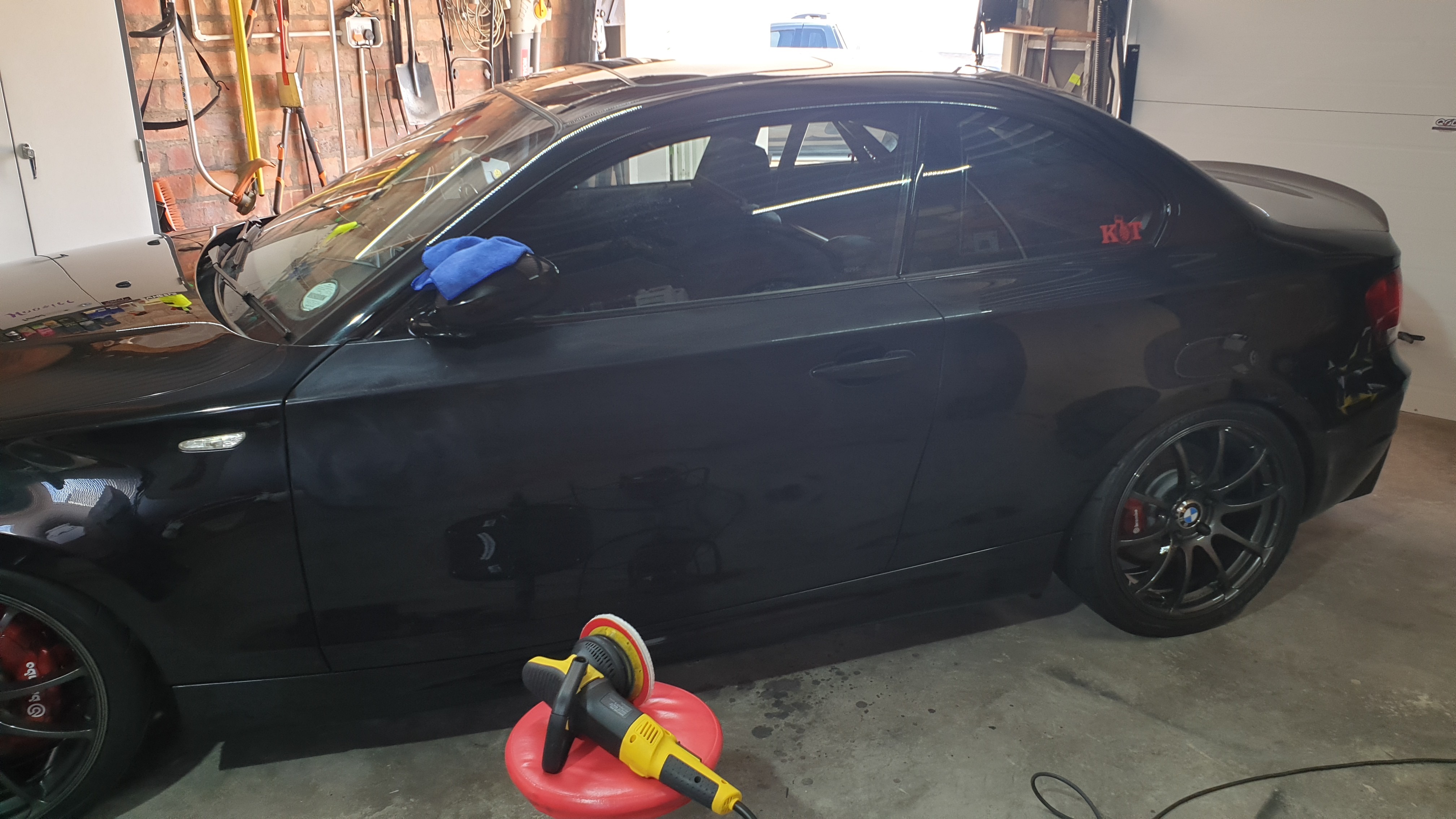

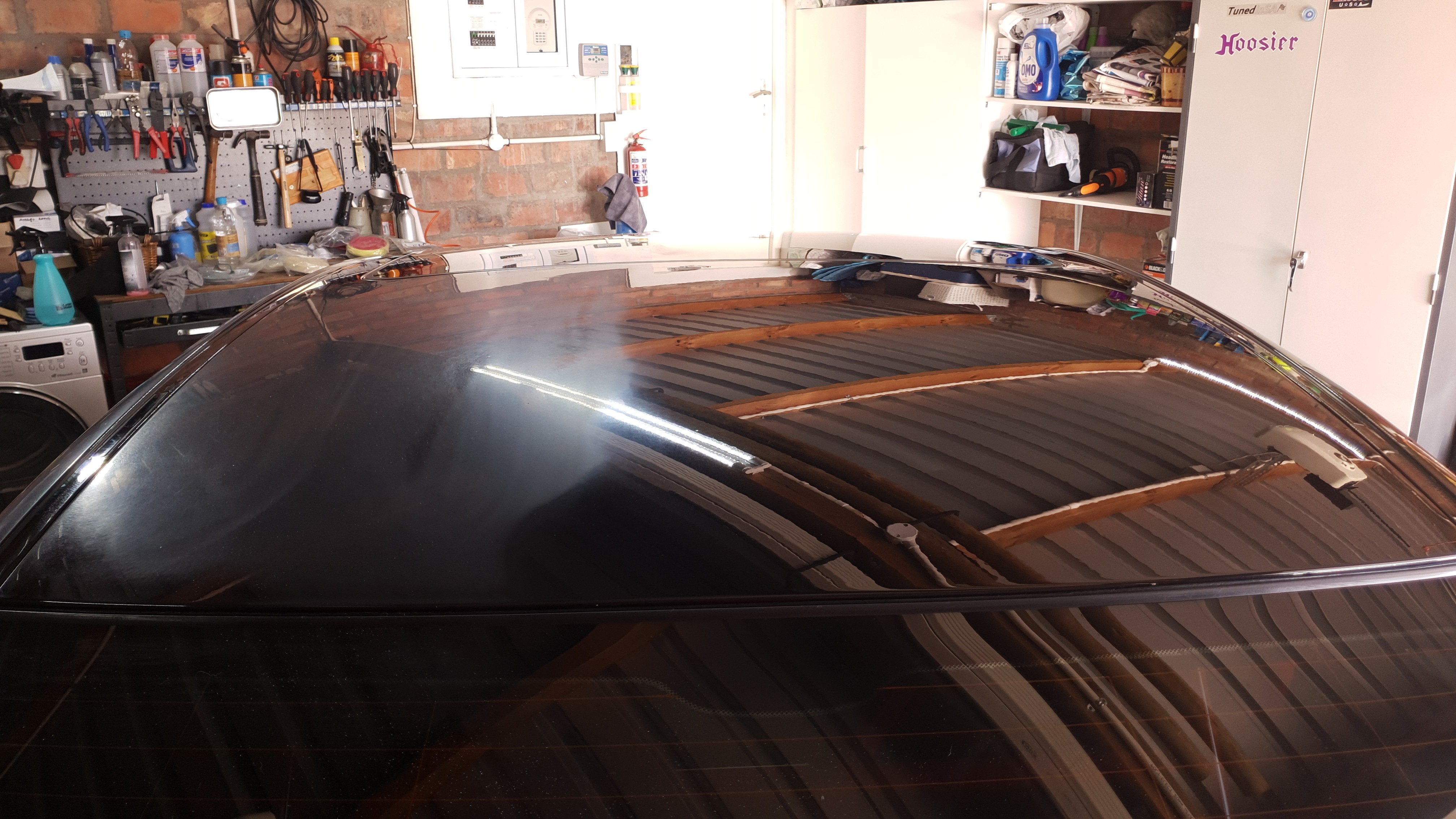

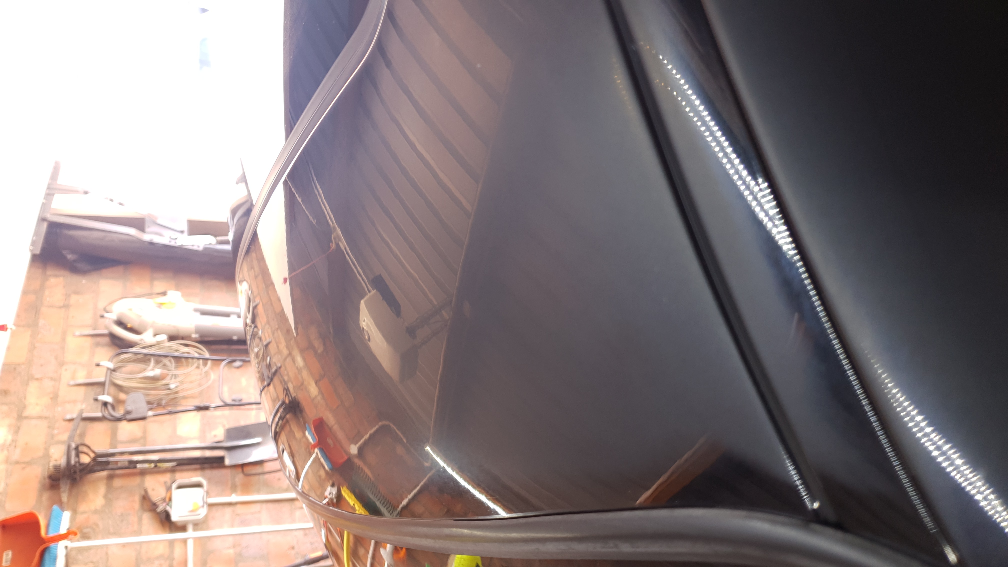

some pics of when I did some paint correction, I had to wet sand the roof, boot lid and bonnet. It turned out OK but not 100%

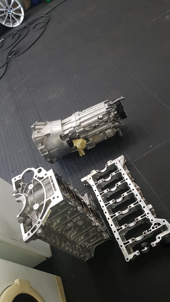

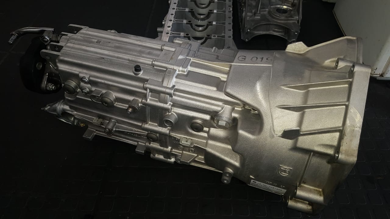

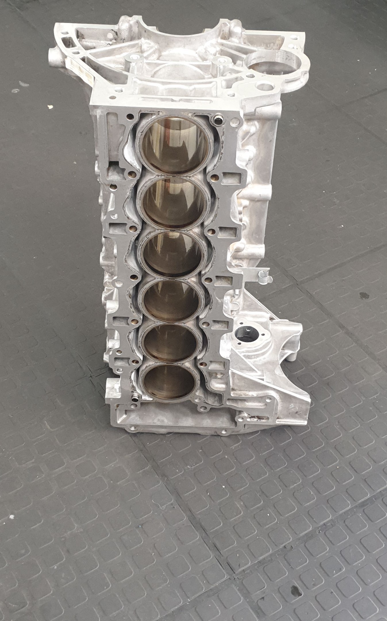

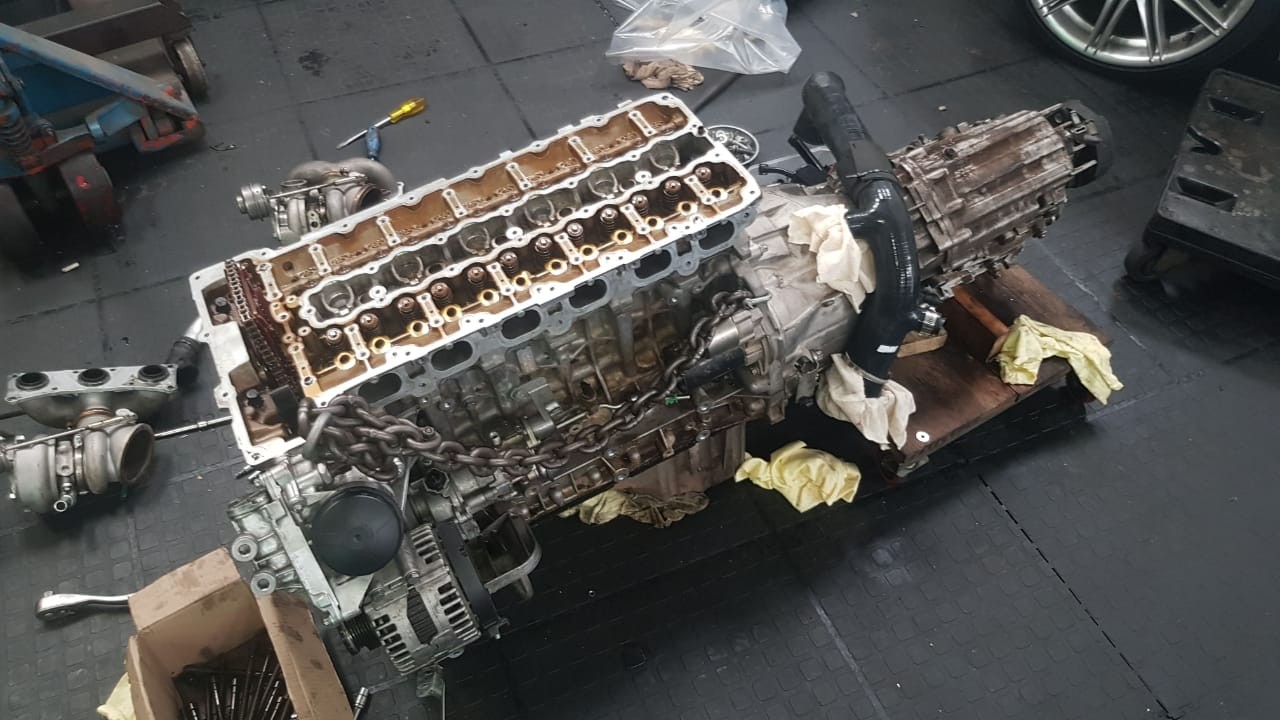

We stripped the motor down first week of March and the plan was to bring parts back from USA and then send for machining, well that is out the window with COVID-19.
the only thing that made it out was the head, that is up in JHB.
some pics of the engine:

This is the setup I want with the new Valve cover
hopefully this will curb the smoking.

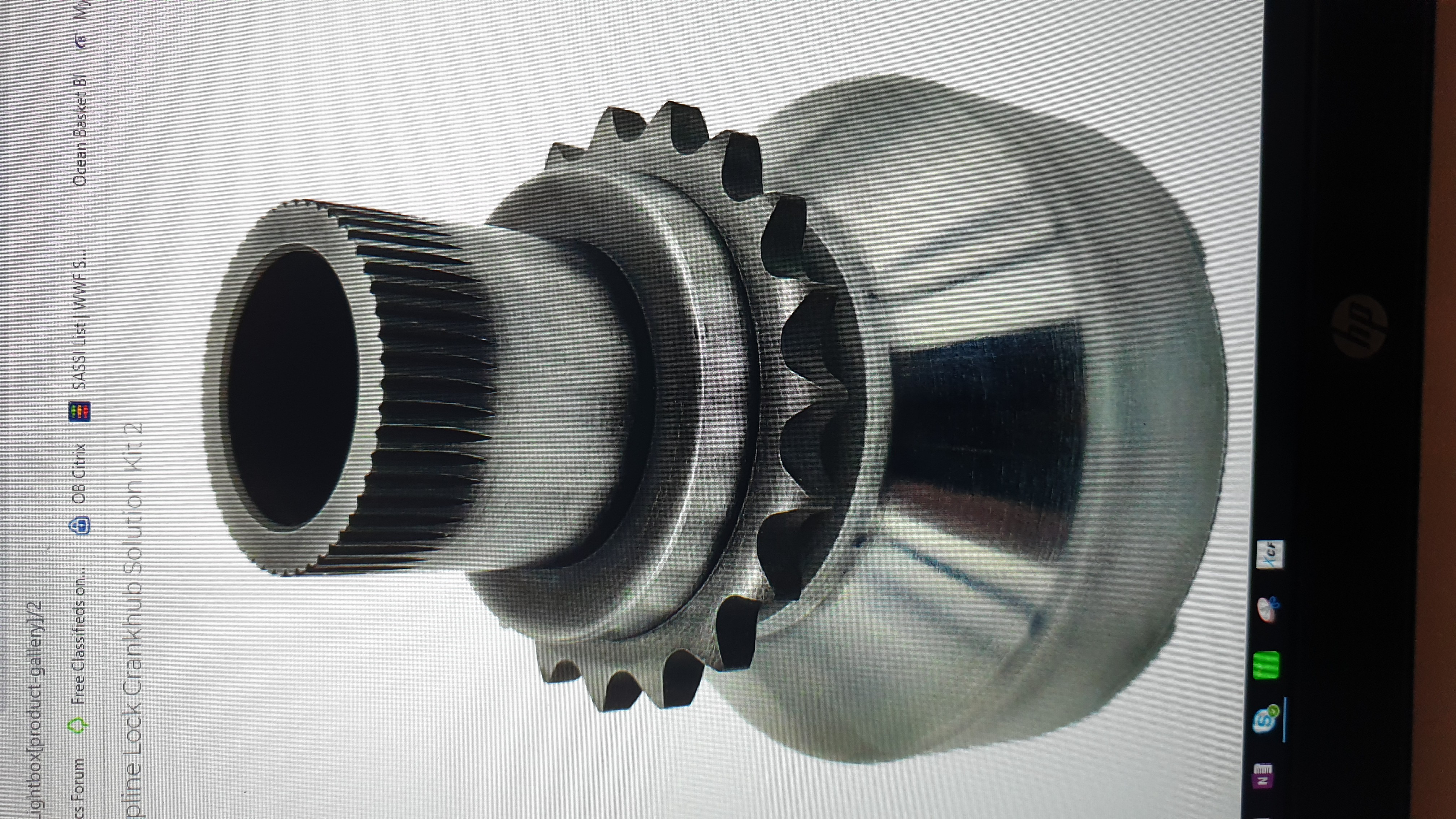

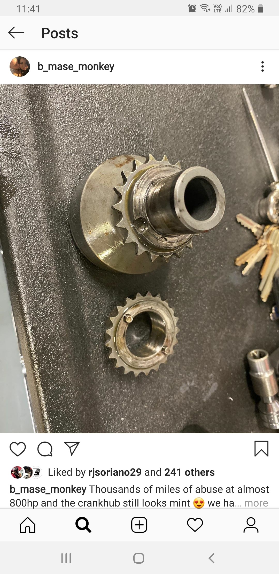

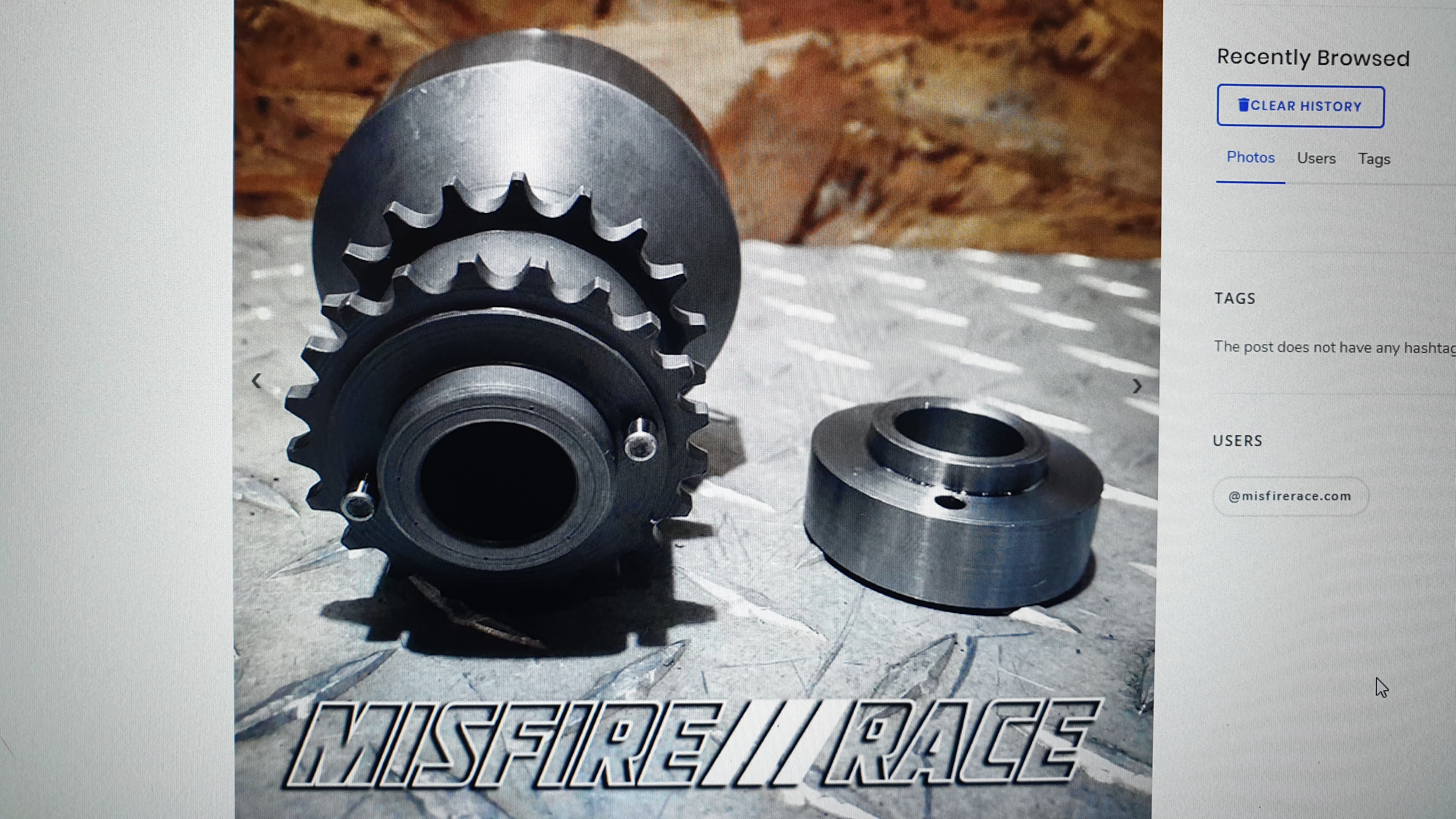

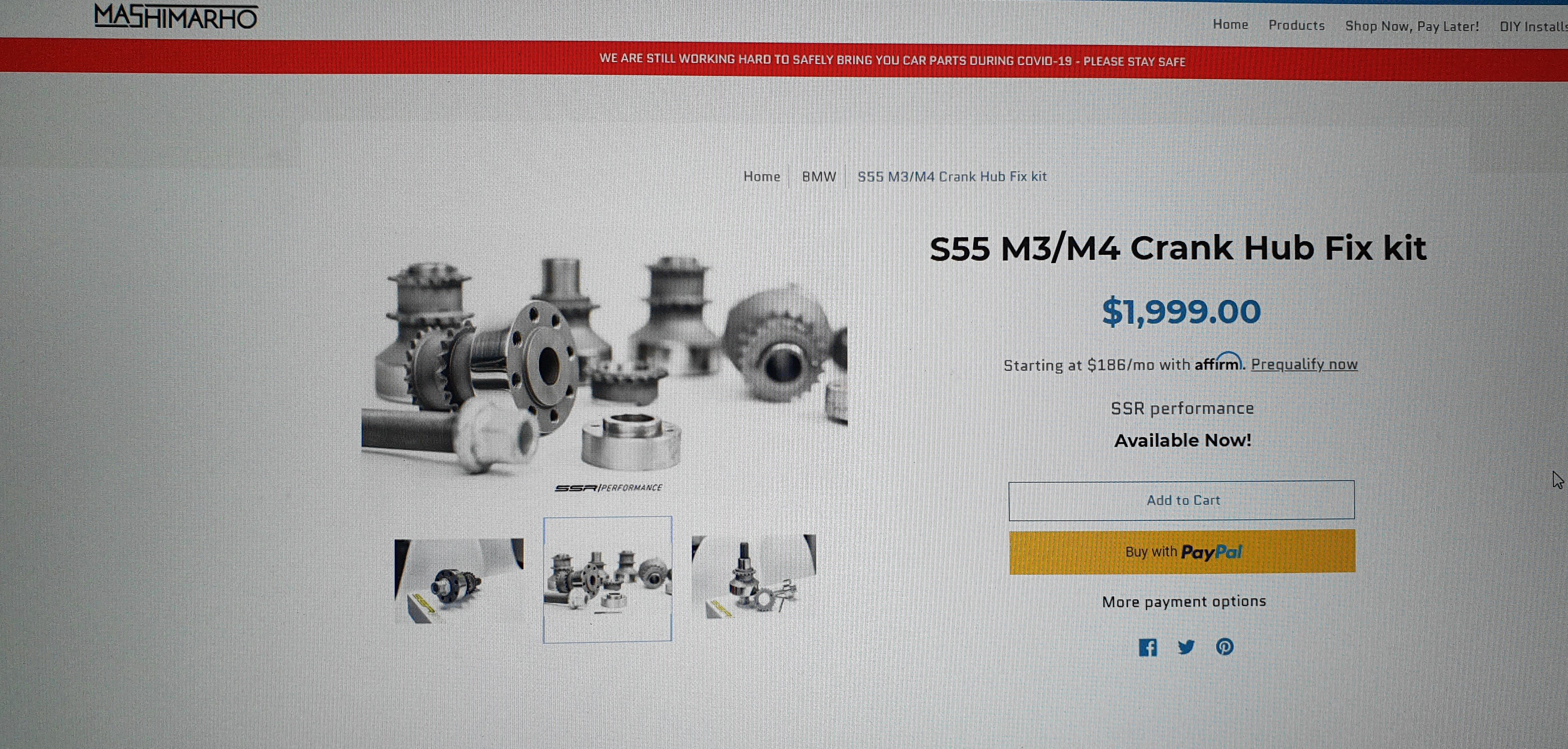

I got most parts just a few remaining things to get, my biggest concern is the Crankhub
Has anyone had any experience with modifying/pinning the crankhub?
I have been looking and have found a few aftermarket ones but wow they are pricey and with ROE today it is crazy to buy, ranging from $699 to $1999
Thanks

N54 didn't have any crank hub issues from my knowledge, only the S55's.
Also, if you are looking for a kit, Rennzport has had a kit put together for a long time, but again, quite sure it's S55 only.

Hi,
thanks for your reply, N54's have lots of problems with Crankhub spinning when you go big on power hence all the aftermarket options.
thanks for the info on Rennzport will defiantly contact them.
