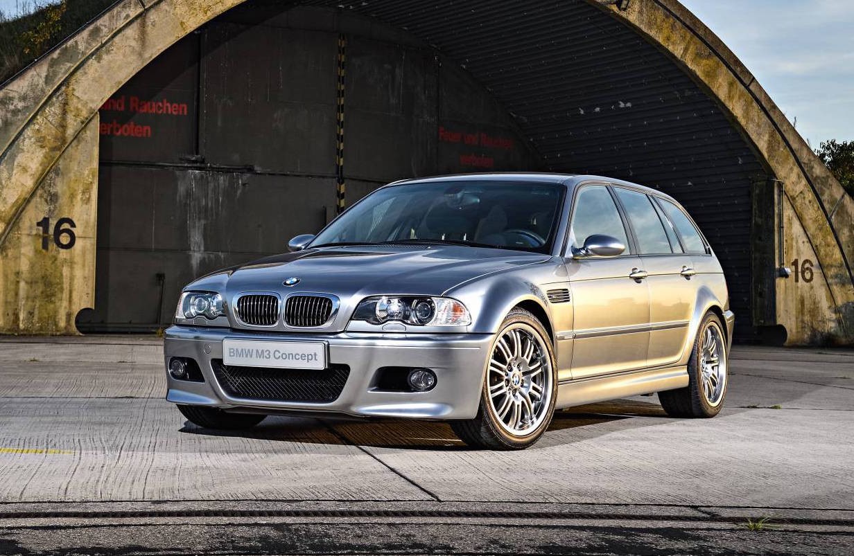

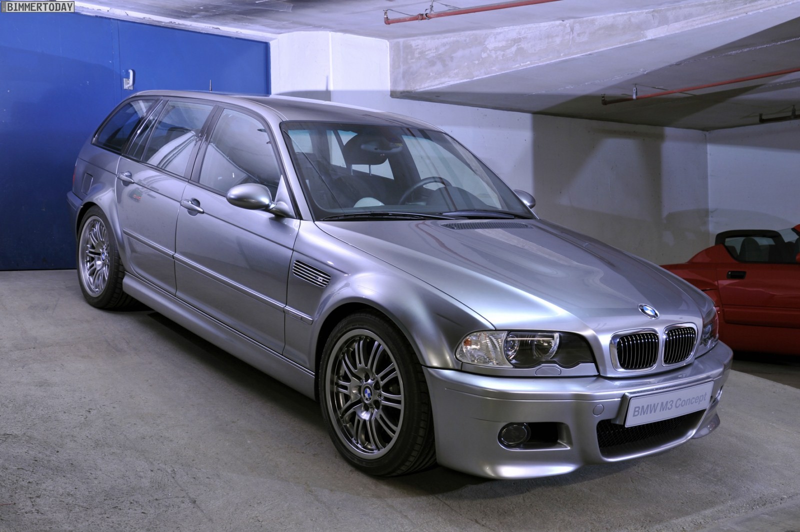

Impressive work as always warren!
How about... you make an E46M3 touring and use this M3 I have? Manual conversion in the process as well...

Scrap the 330d Touring... The next iteration should be the M3 Touring.
Gizmo, it amazes me how easy you make this seem

There might be a M3 touring in the pipeline later this year, awaiting confirmation from a certain moderator.
