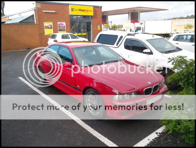

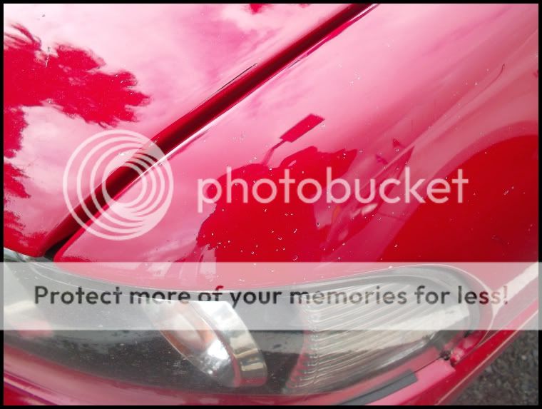

Well this morning Jeanre and I collected Clownshoe's E39 M5 from him to do the spraywork on the front end.
Having worked intimately on the car whilst still in Jeff's care we knew the condition of the car and we knew that whilst the rest of the body was not too bad the front end needed some serious love.
The issues raised in no order:
- Bad Paint Match, the front looks Ox Blood Red whilst the rest of the car is original BMW Paint.

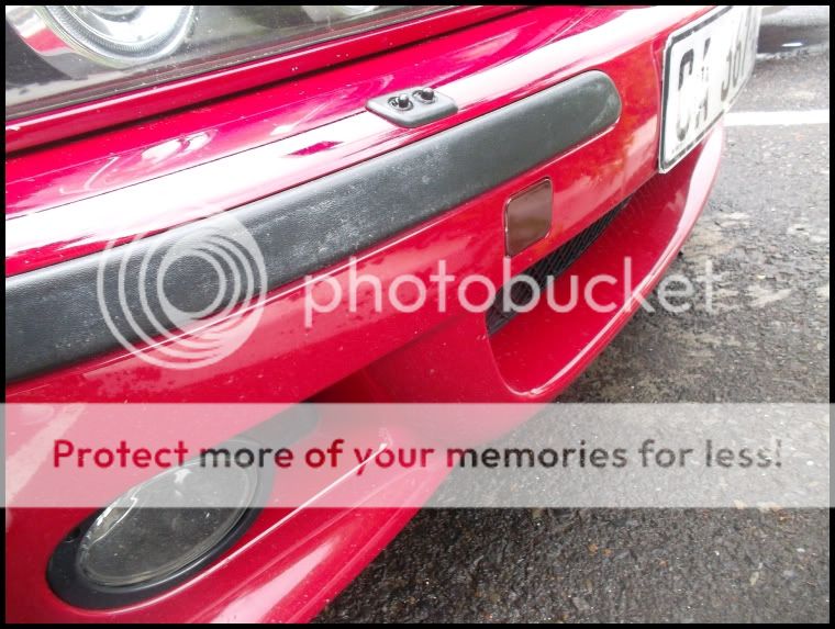

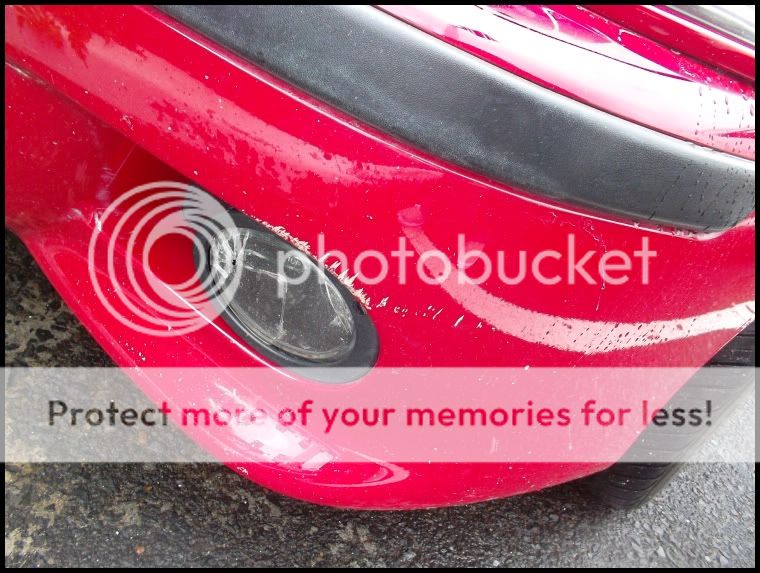

- Multiple Stone Chips
- Damage near the foglight
- Stone Chipped Fenders

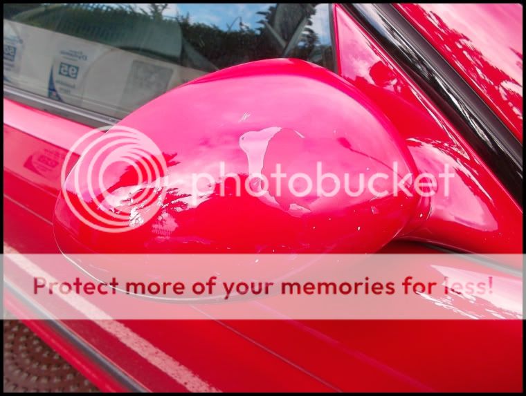

- Clear Coat Failure on the mirrors

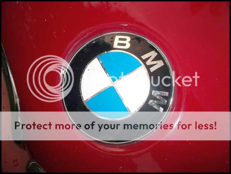

All of the above is being repaired today, we have also ordered a new set of foglights from our JHB Supplier as well as a new front badge to finish off the re-spray.
