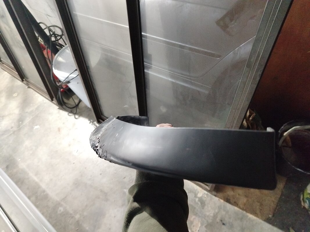

I recently killed 1 of my ClubSport Mtech 2 Splitters. :(
Damn pavement cam out from nowhere .....

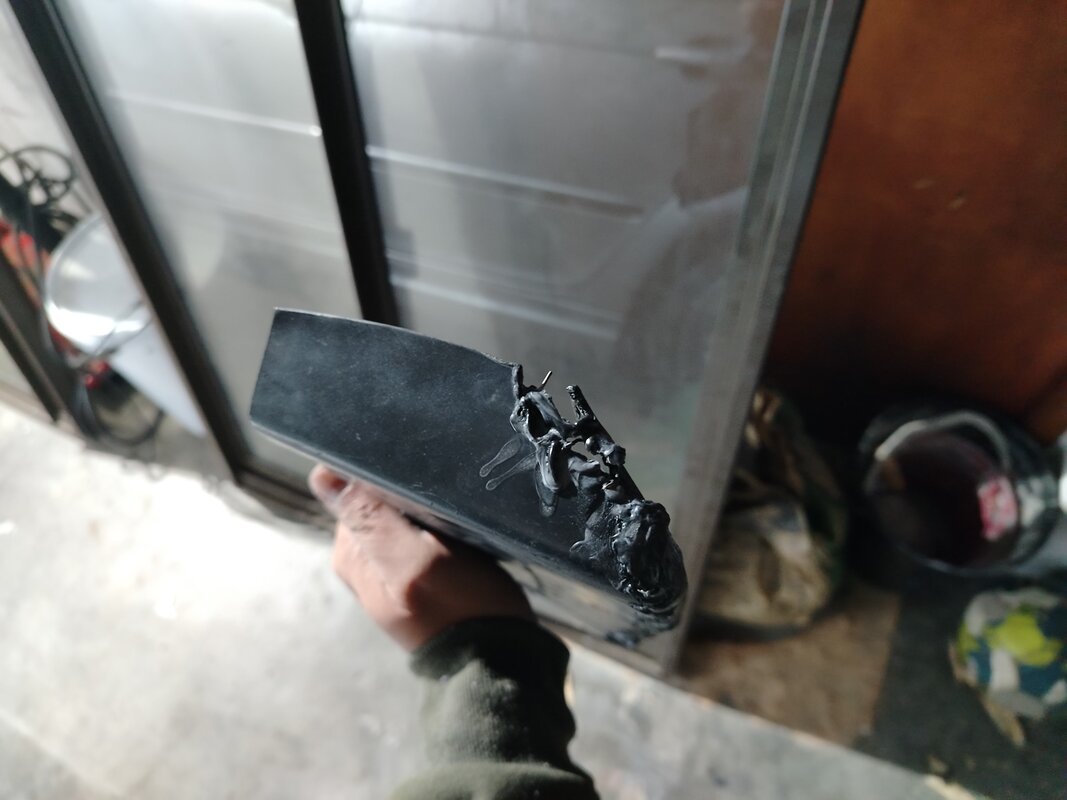

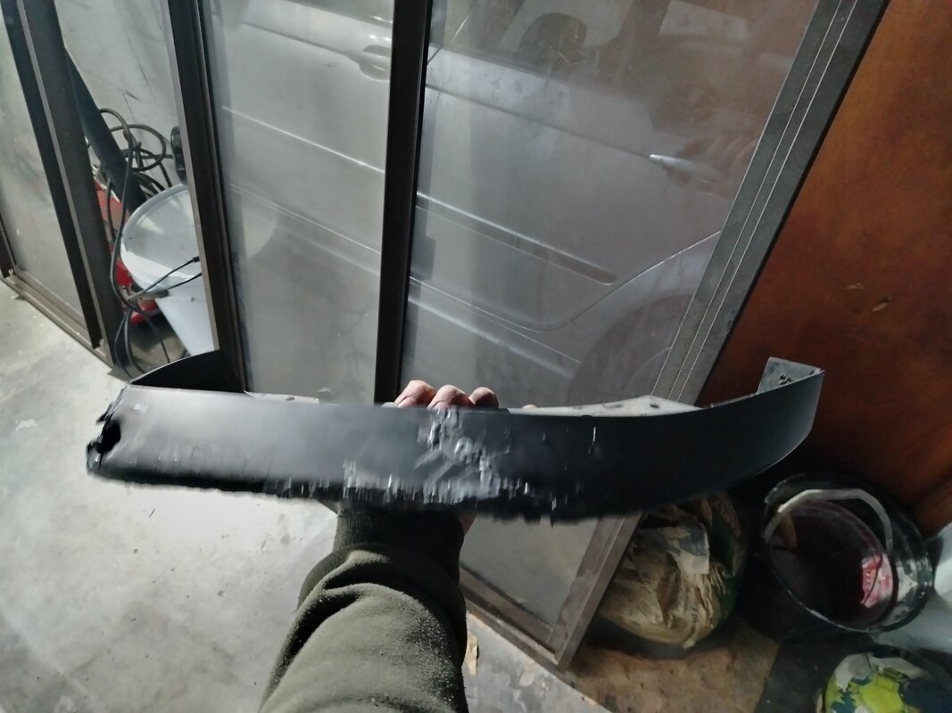

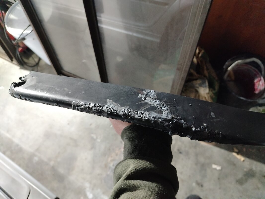

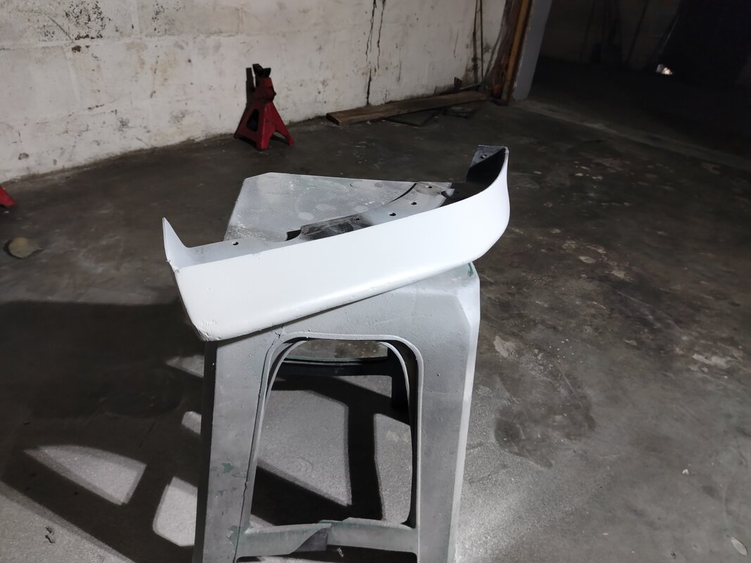

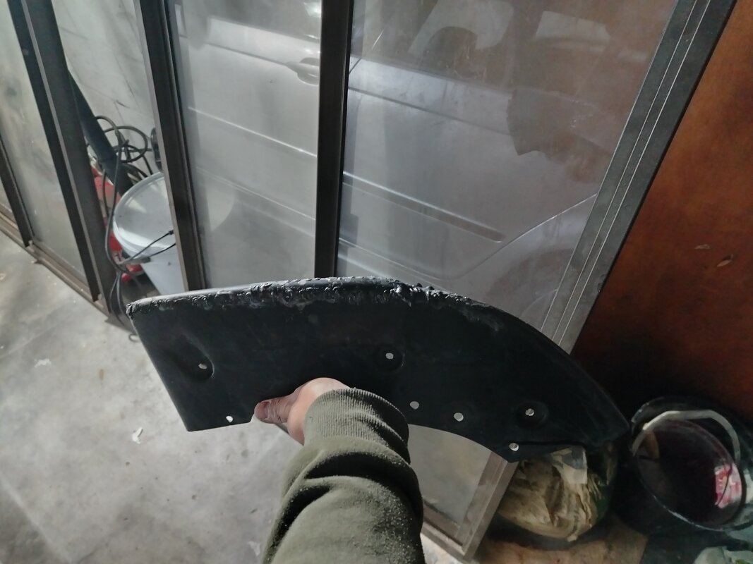

Bordom is sometimes a good thing. What seemed Irreparable i repaired.
Need to fine tune it properly but the main damage was repaired and Strengthened for now
Some Staple Plastic Welding.

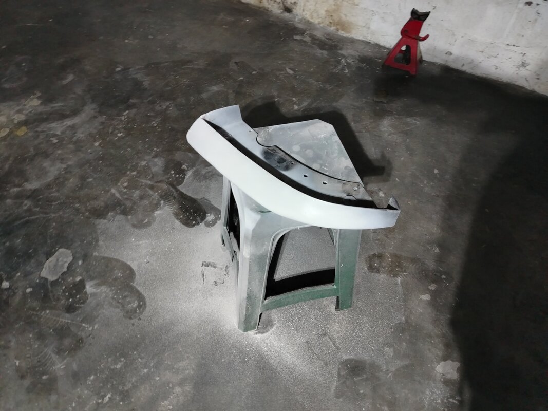

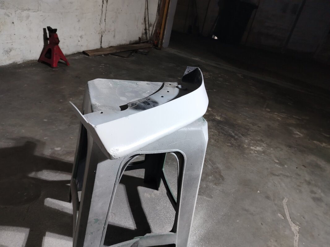

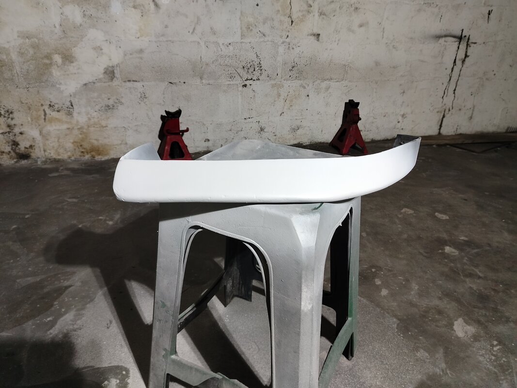

After some fibre filler and Plastic filling/Smoothing, I done some sanding to get it all in shape.
Primer i put on to see any of the imperfections.
Will do that During the week.
At least i can sport these for a little while longer. lol
