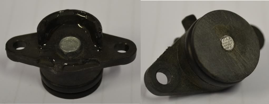

Hellas
I removed the flaps from the spindles and simply replaced the 'empty' spindles. No need for blanks or anything.
You have to lightly grind the little screw holding the plate to the spindle as the screws have been clinched a bit.
tito1
You seem to have a great plan, hellas. I was even thinking of sawing off the stubs. This way one do not have to worry about blanking off.
moranor@axis
should work, but most epoxy tends to let go when you heat it... super glue is more suited for something like this...
tito1
Q-bond maybe? I would be more comfortable with just removing the plates from the spindles.That way everything remains intact except for the actual flaps.
