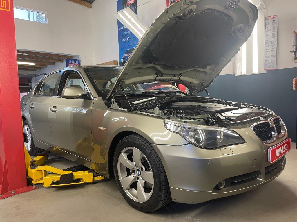

We began with the usual protective covers (driverโ€™s seat, steering wheel, footwell) to keep everything spotless.

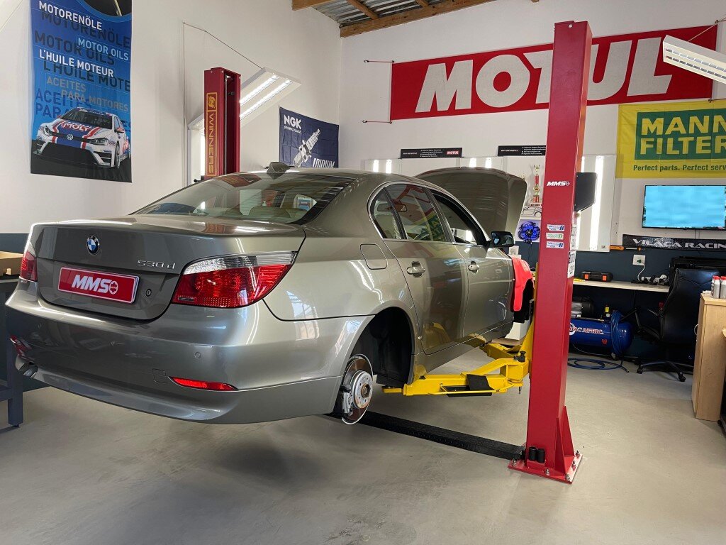

  • Vehicle moved onto the lift
  • Full undercarriage inspection covering suspension, engine, transmission, drivetrain, brakes & tyres
  • Noted and documented issues with photos/videos for the customer

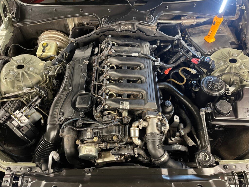

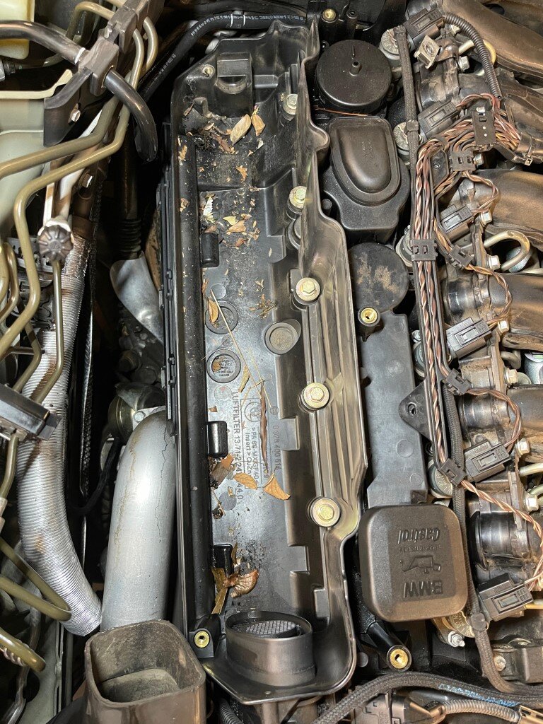

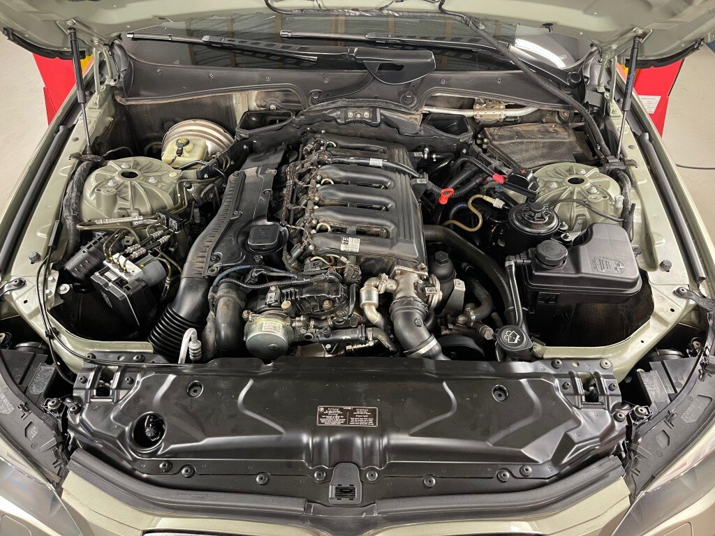

  • Removed engine bay covers & checked filters + brake fluid condition
  • Shared findings with the owner and ordered the required parts

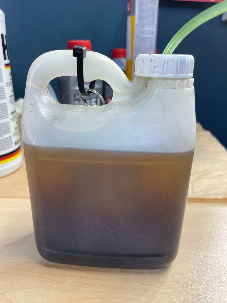

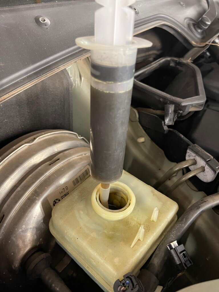

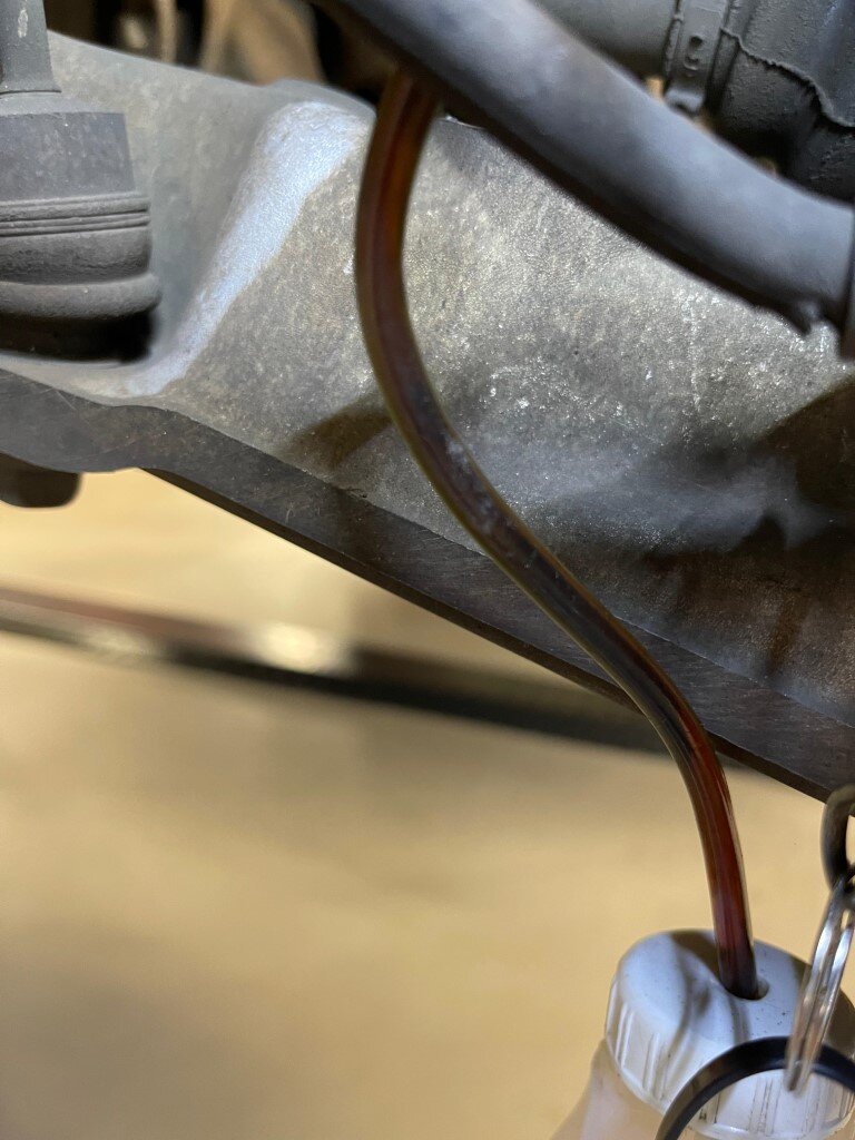

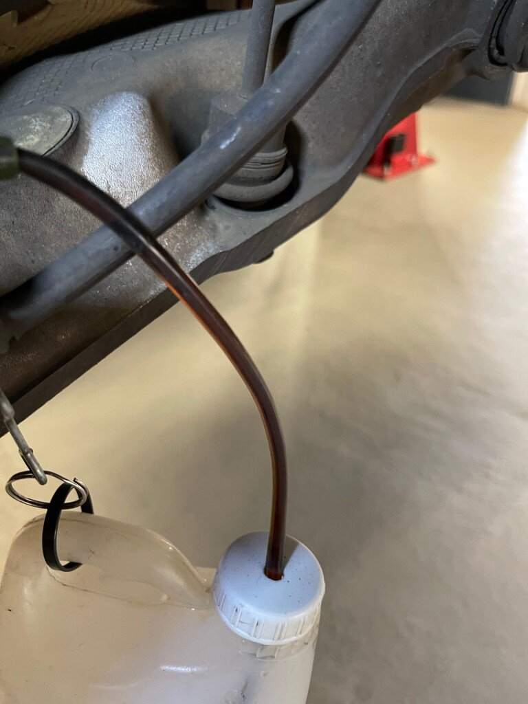

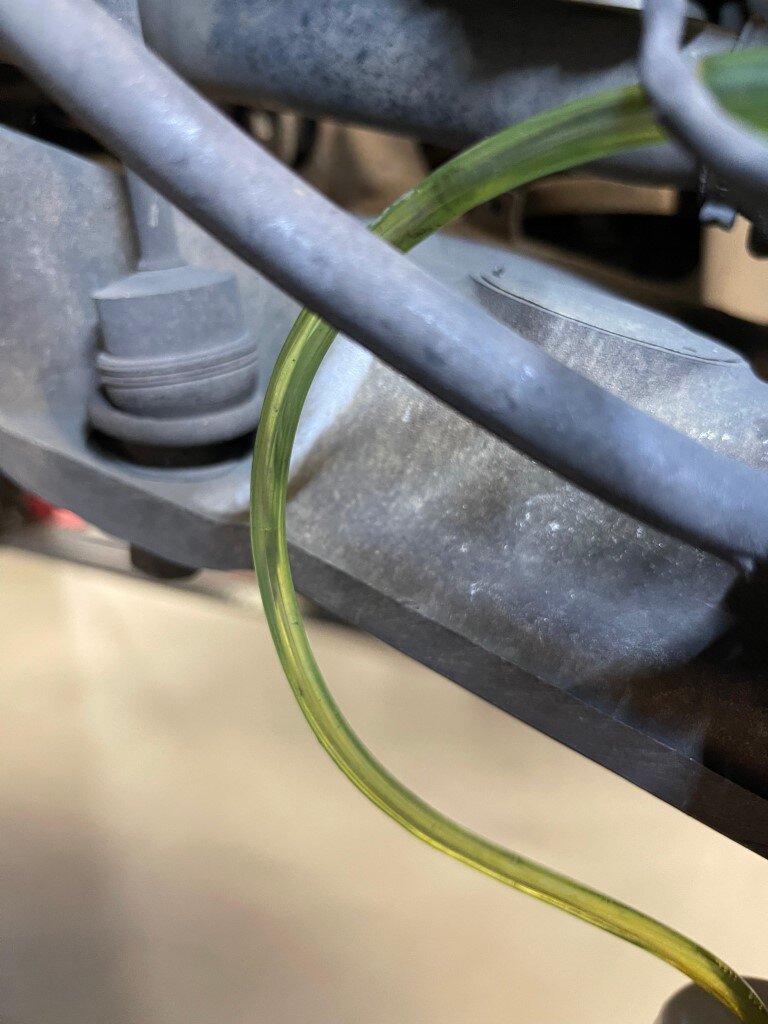

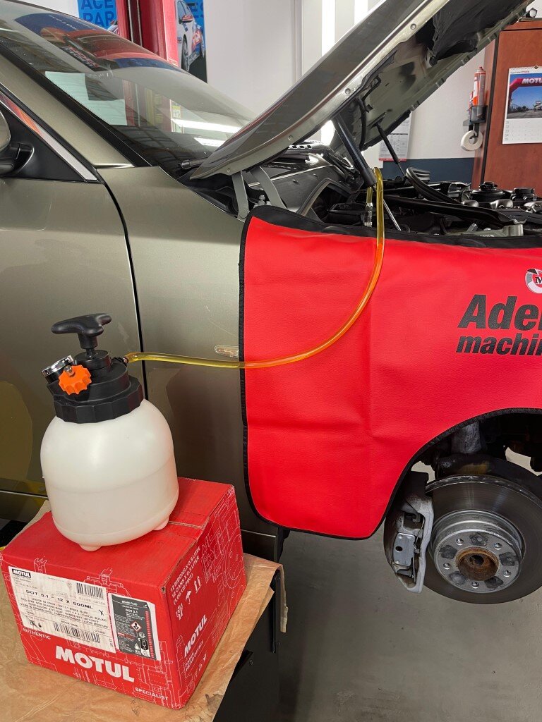

๐Ÿ”ง Brake Fluid Flush

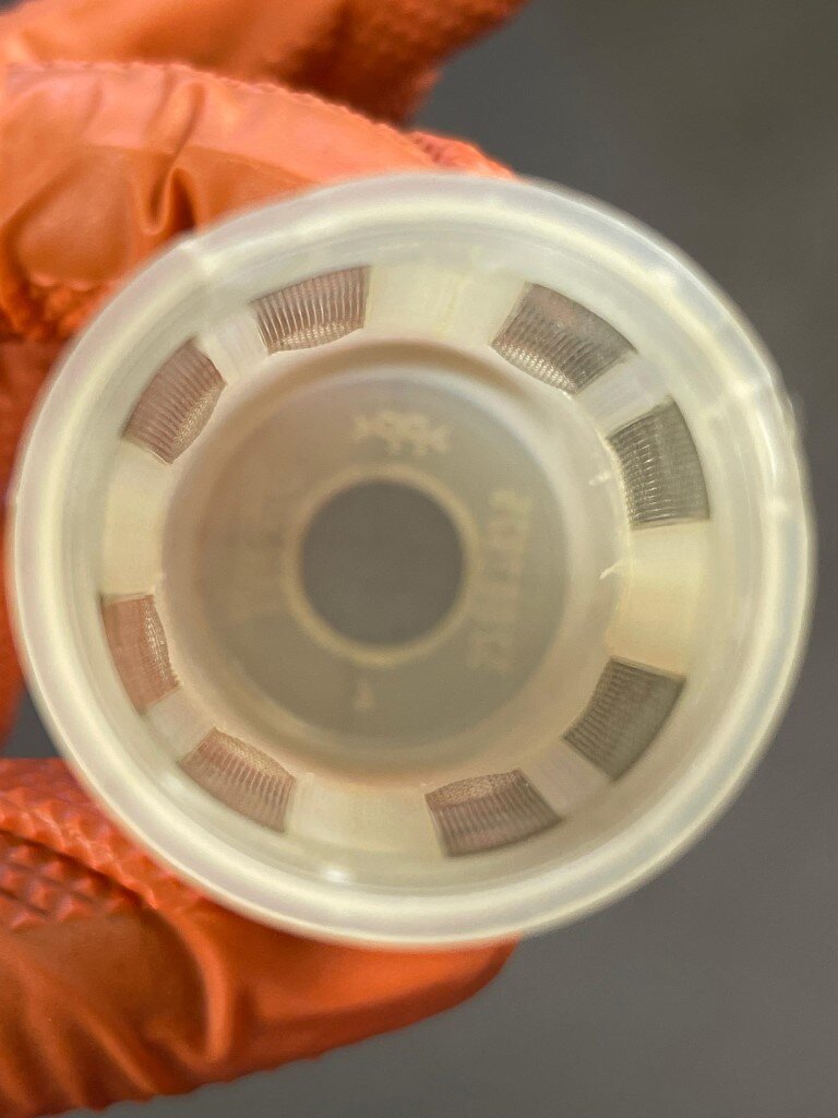

  • Cleaned the brake fluid reservoir cap & plastic filter

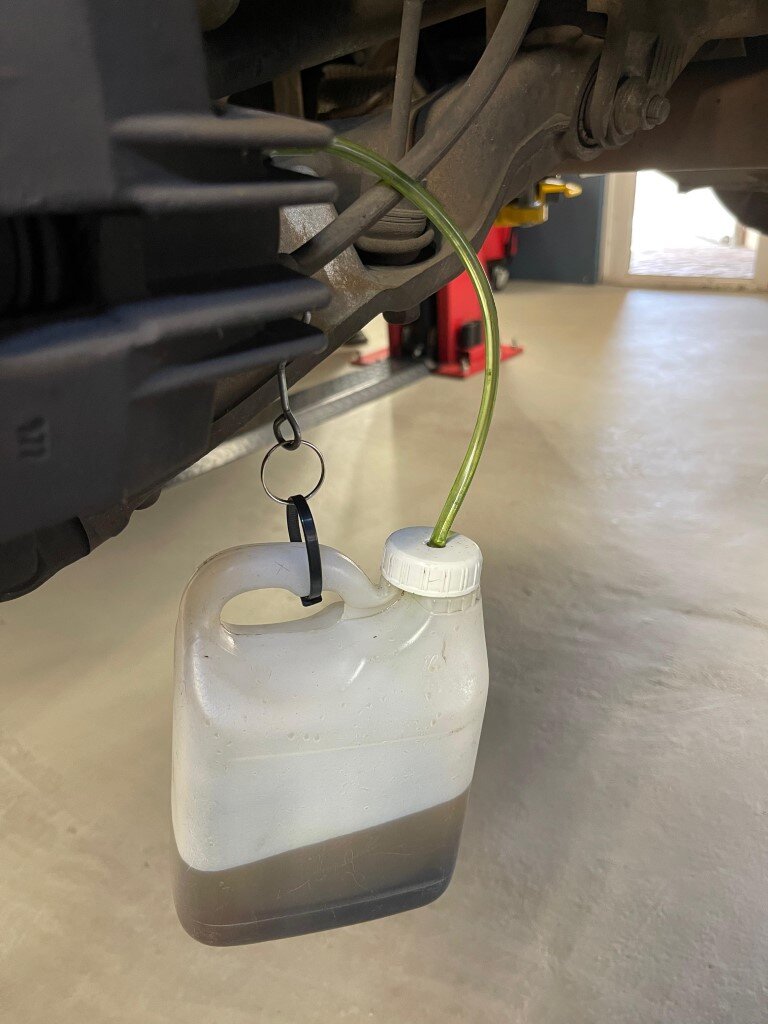

  • Extracted old fluid

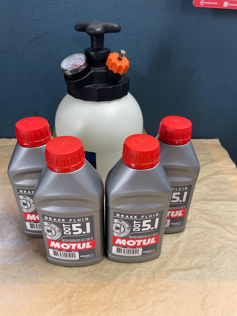

  • Filled pressure bleeder with 4 bottles of Motul DOT 5.1 brake fluid ๐Ÿ”ฅ
  • Bled all four corners until clean fluid was through and no air remained

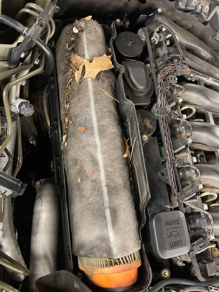

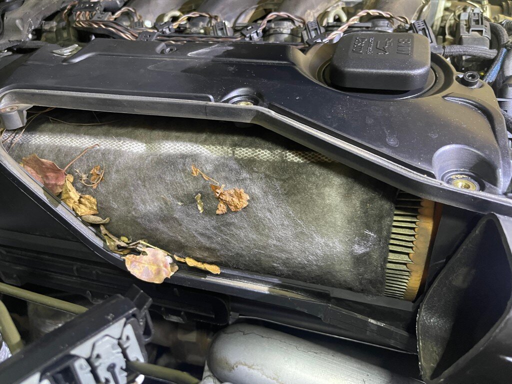

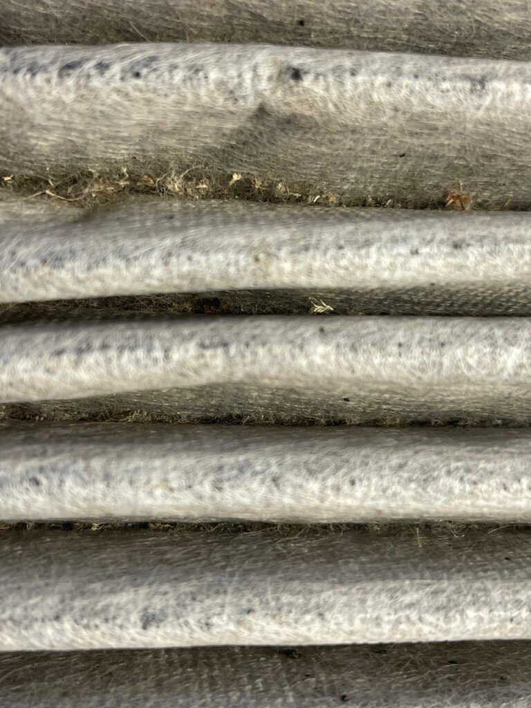

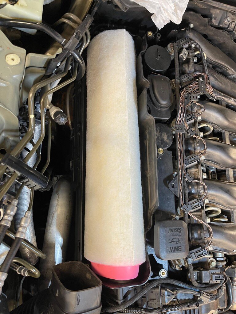

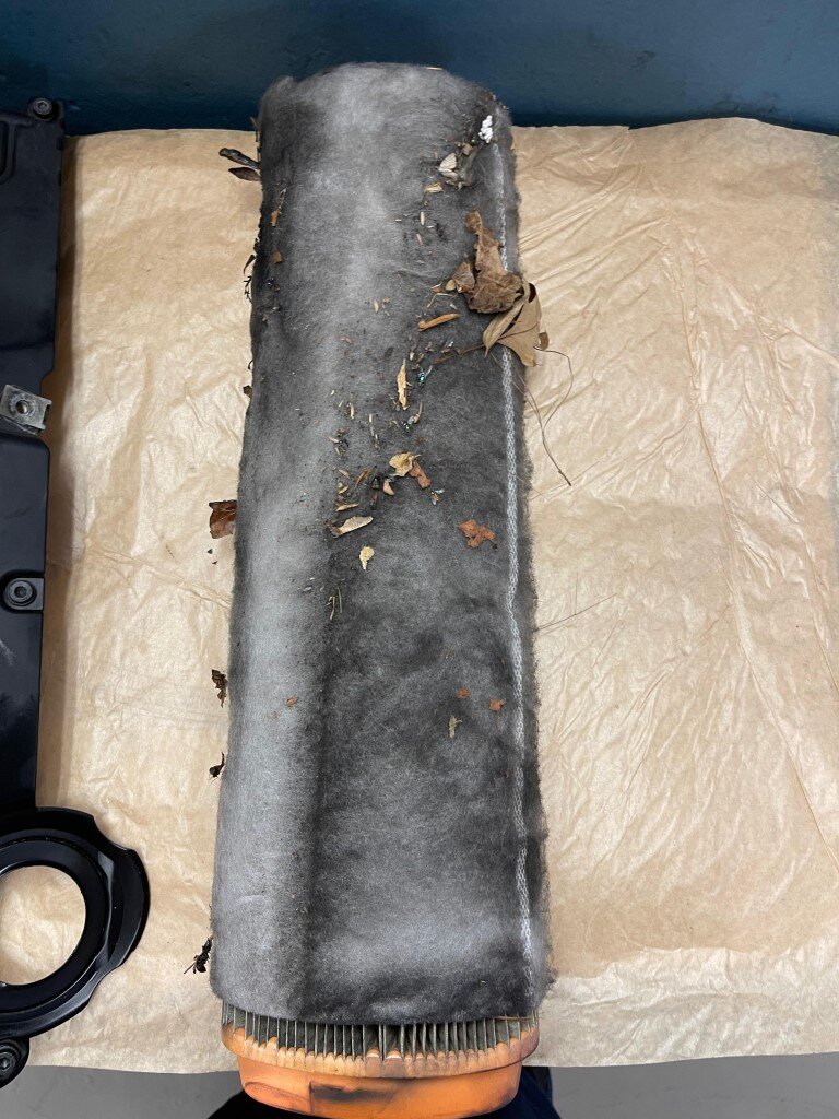

  • Removed old air filter, cleaned airbox & fitted new MANN filter

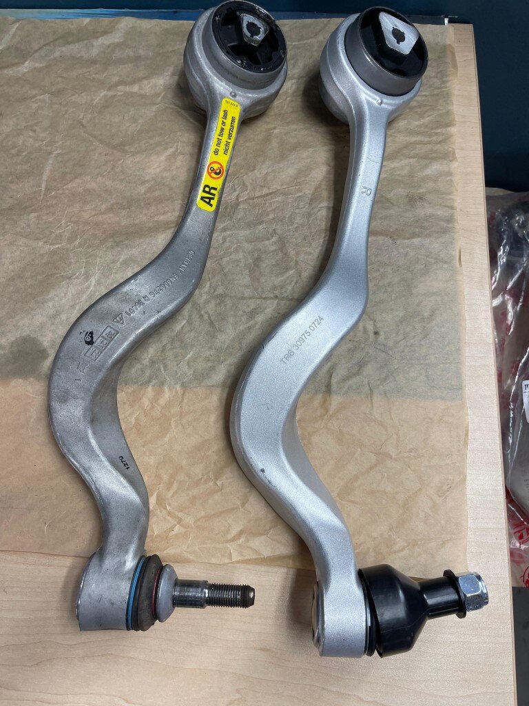

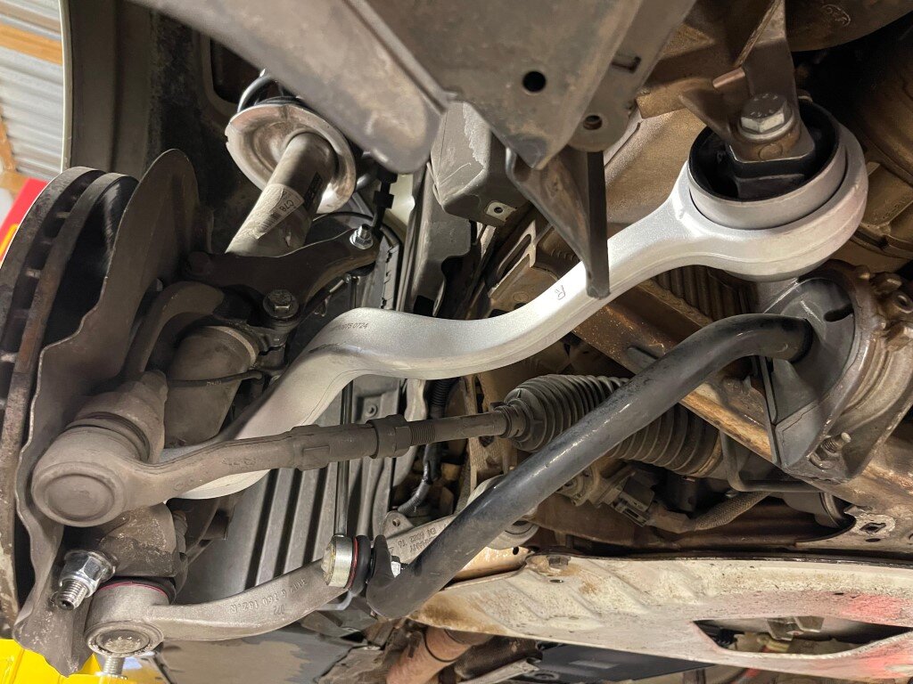

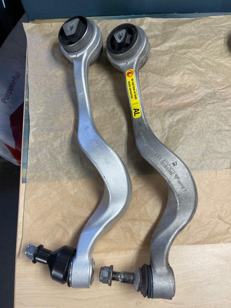

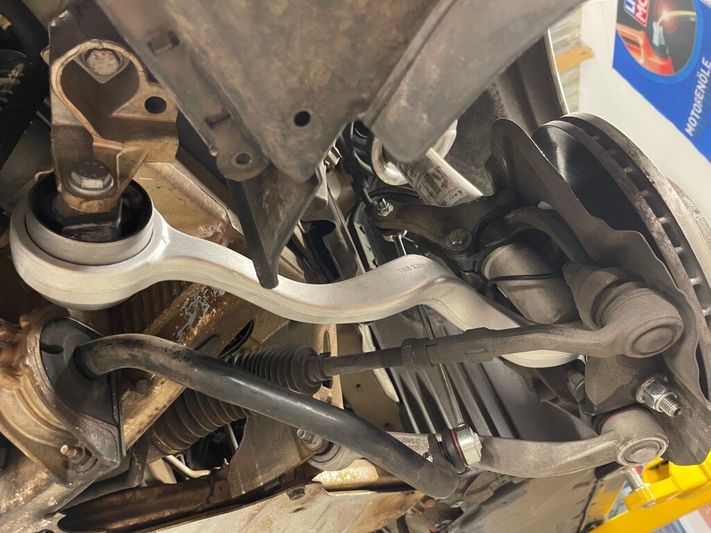

  • Replaced left & right upper control arms

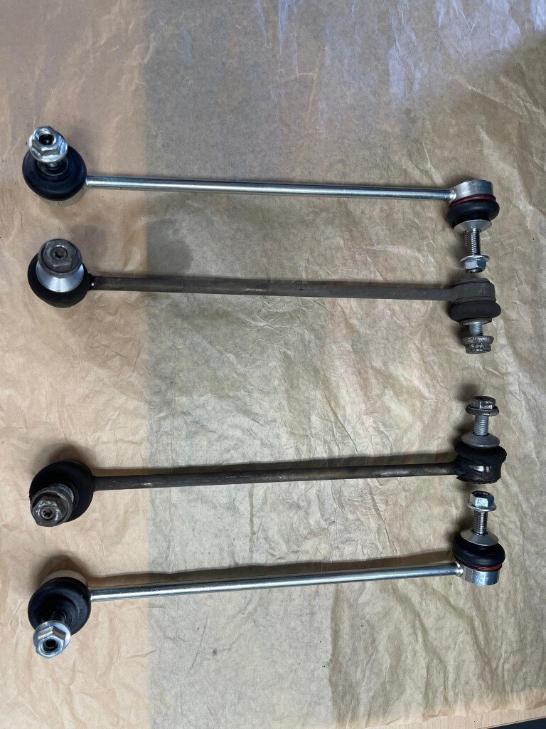

  • Replaced left & right stabilizer end links

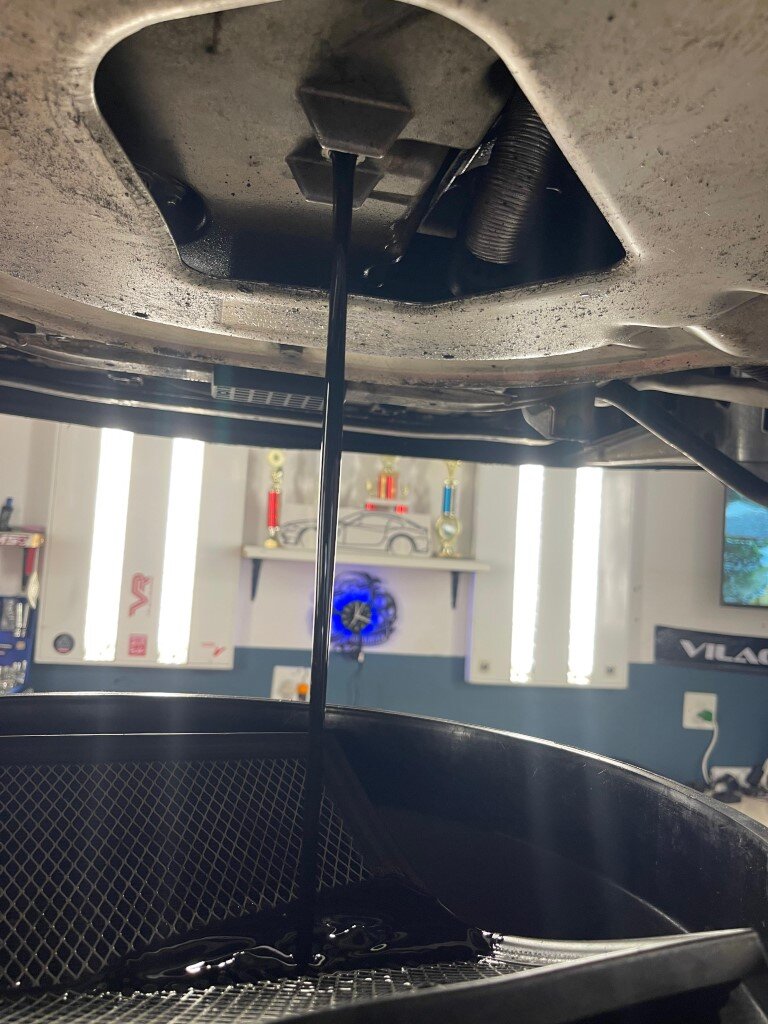

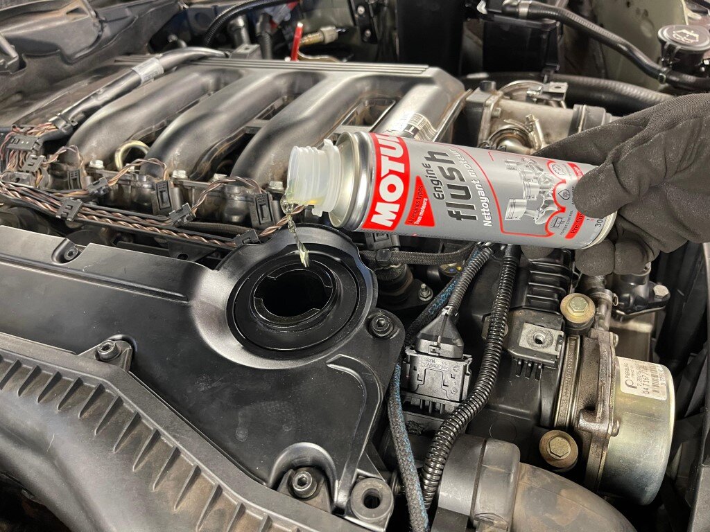

  • Added engine flush, then drained old oil via sump plug

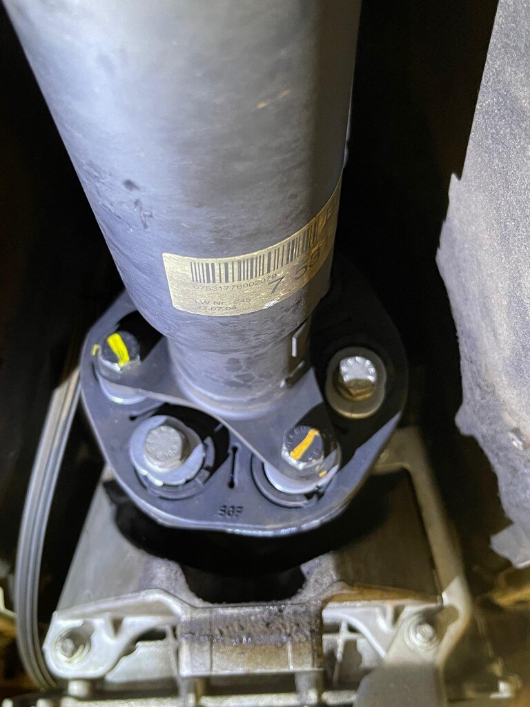

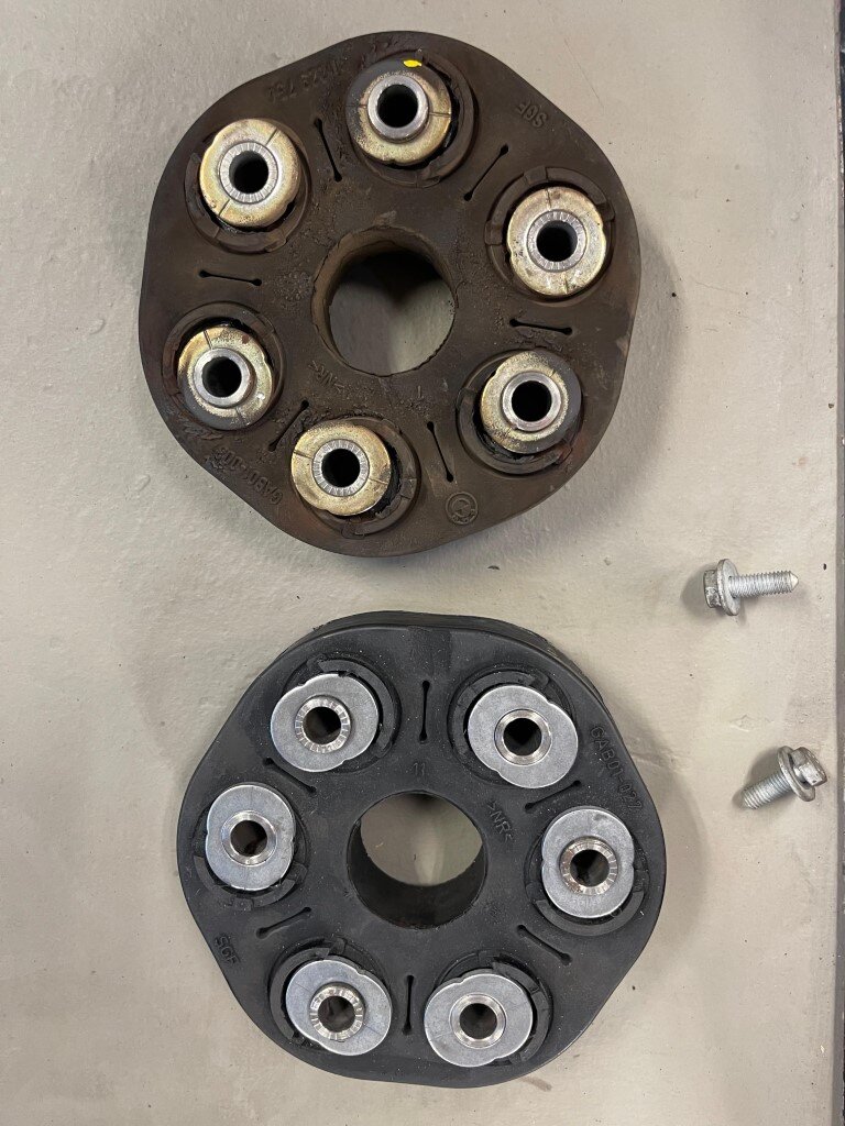

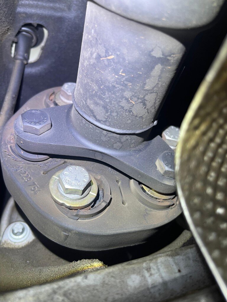

  • Removed exhaust & heatshields for full access to Propshaft coupling

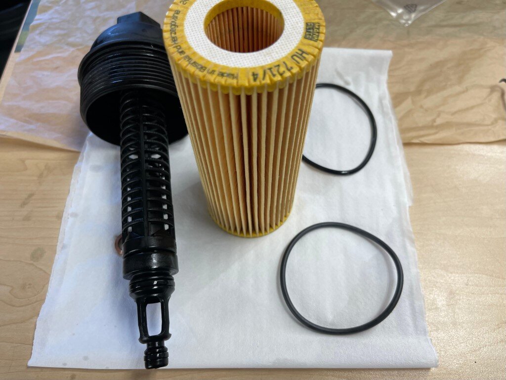

  • Opened oil filter housing for complete oil drain
  • Replaced propshaft coupling while exhaust was down and Oil still draining.
  • Reinstalled sump plug with new crush washer

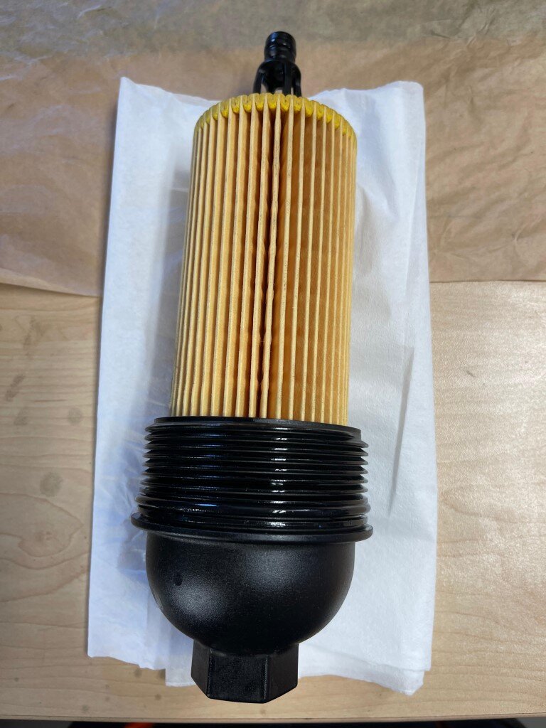

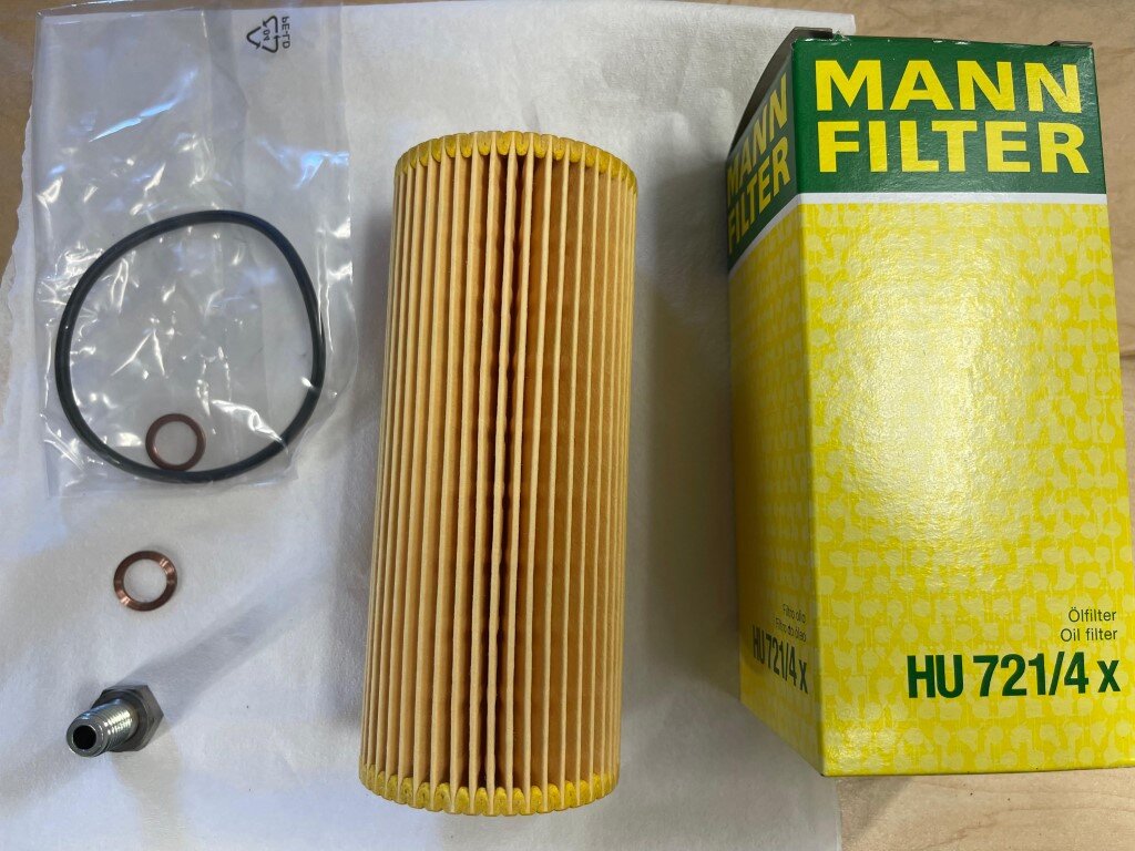

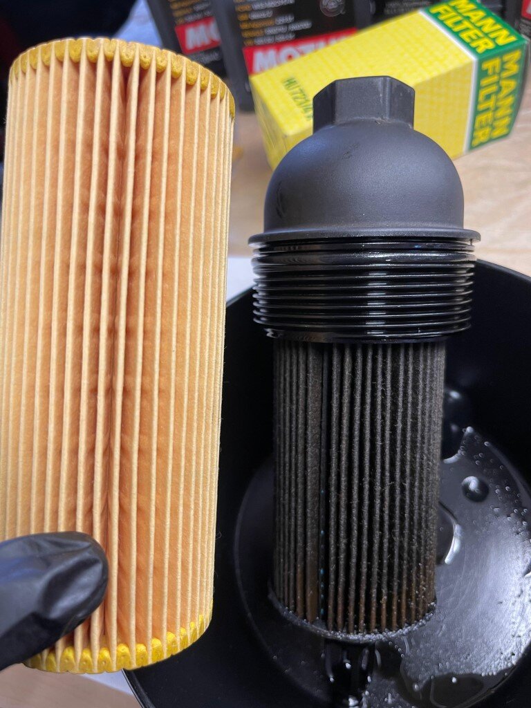

  • Cleaned oil filter housing, fitted new filter & o-ring

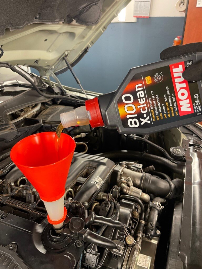

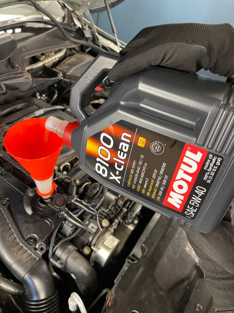

  • Refilled with fresh Motul engine oil, checked levels โœ…

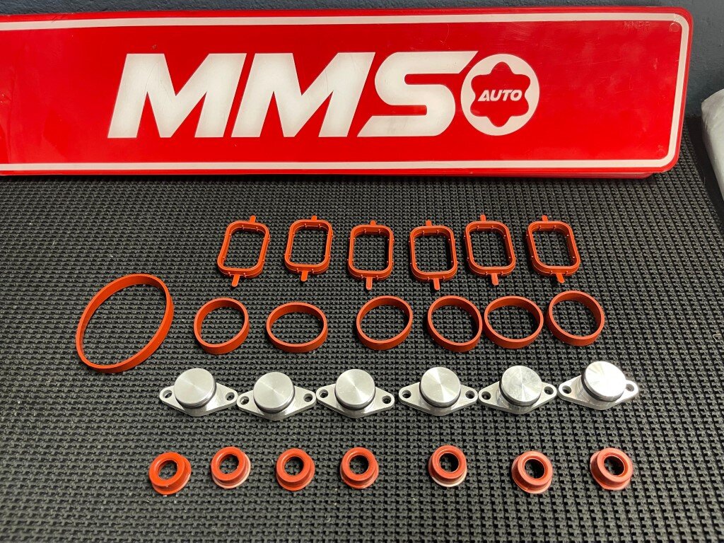

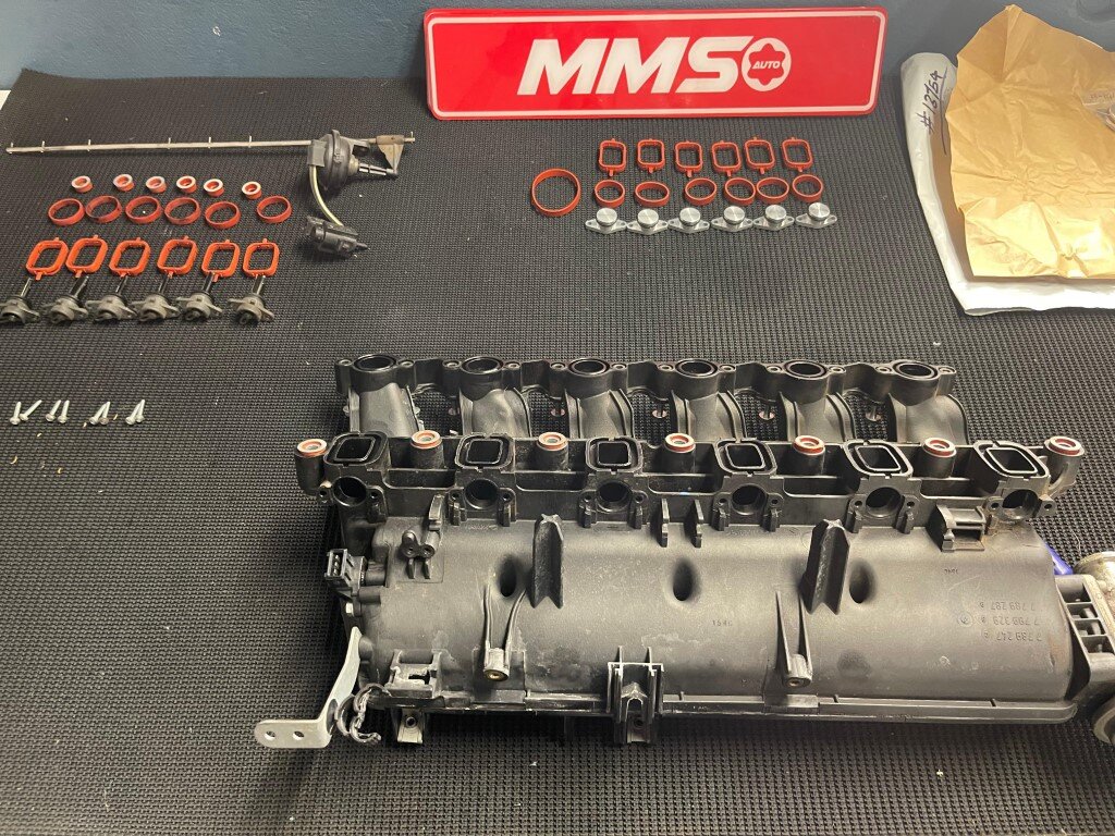

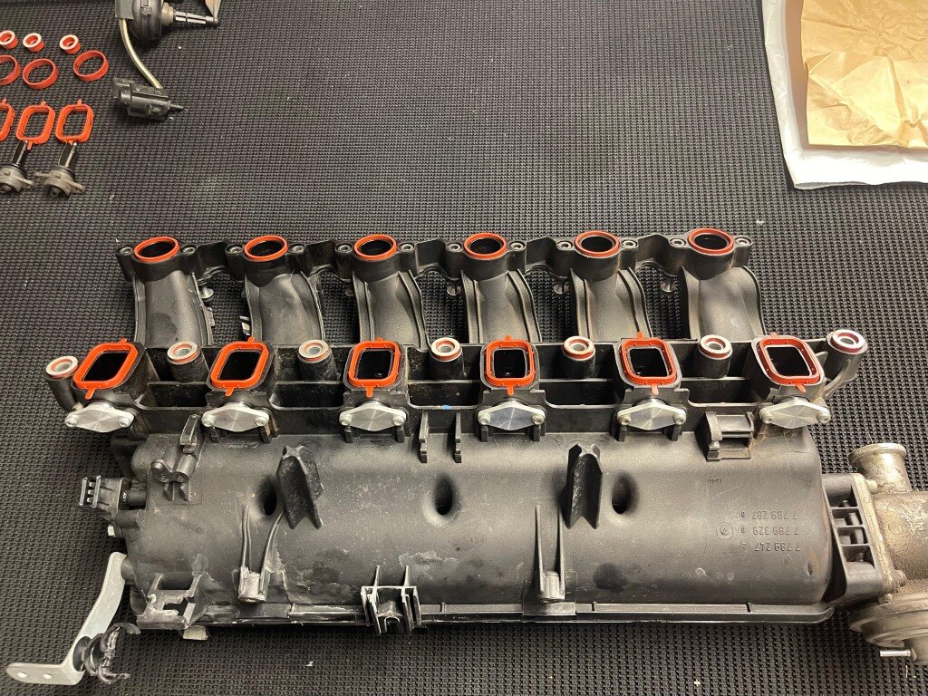

โŒ Swirl Flap Delete
  • Removed intake manifold
  • Stripped out all swirl flaps & old gaskets
  • Cleaned gasket surfaces & ports
  • Installed blanking plates with new manifold gaskets
  • Reinstalled intake manifold

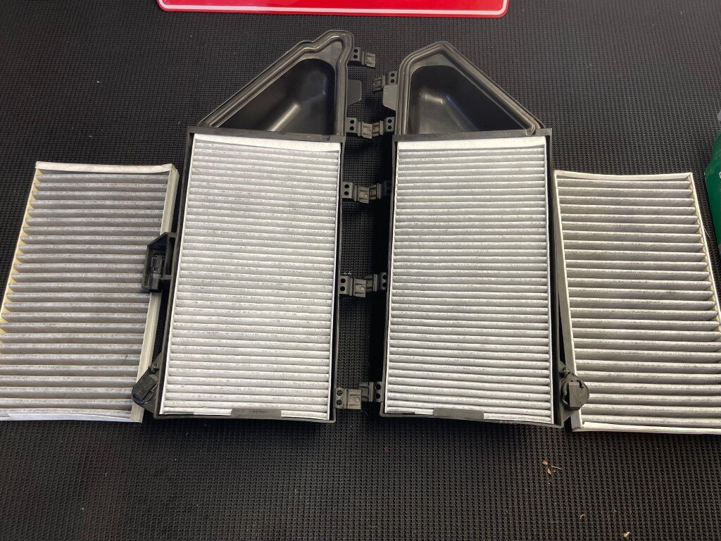

  • Fitted new activated charcoal cabin filters

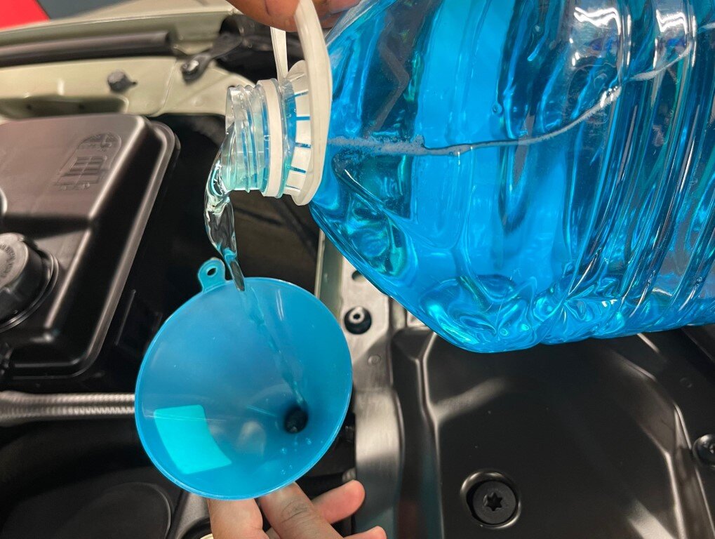

  • Topped up washer fluid

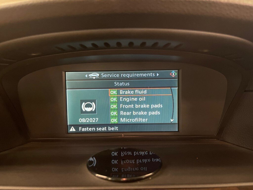

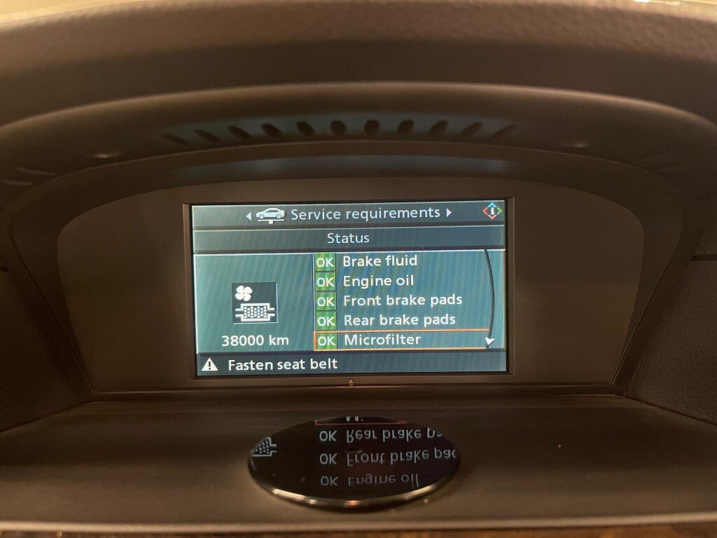

  • Reset service reminders for brake fluid, engine oil & microfilter
  • Stamped the service book & updated records
