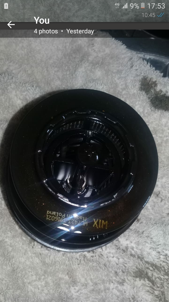

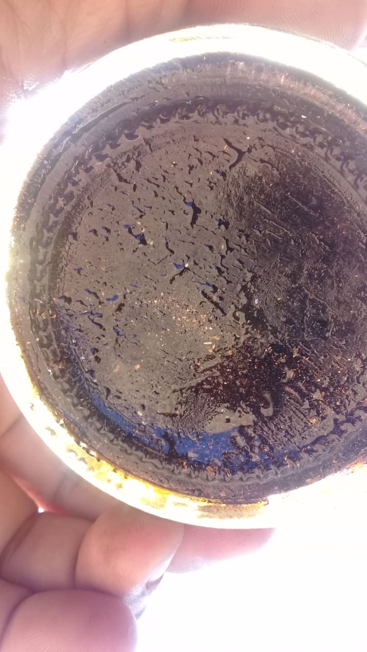

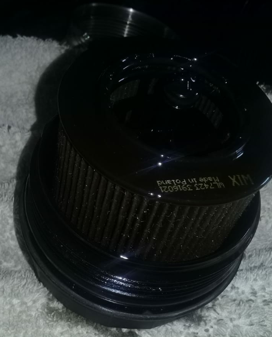

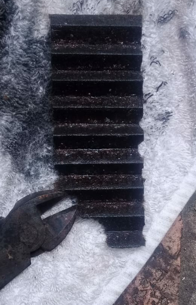

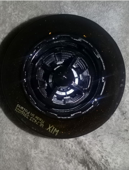

Did you buy this car off a forumite? Please post up pictures of your oil filter?
Hi there I'm not sure if the owner of the car is on the BMWfanatics forum. Herewith the pics
MedicN54
On the outside of the filter there's silver filings, on the inside of the oil filter it's copper coloured filings.
NBN
Based on your previous posts it doesn't look like you drove the car hard before the oil got up to temperature and you also mentioned how you let the car cool off. So could it be that someone sold you a lemon?

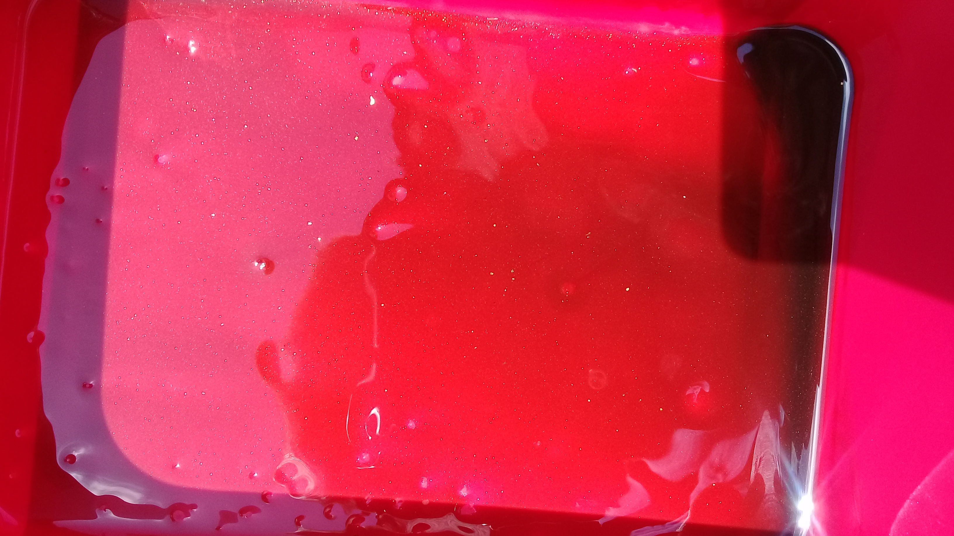

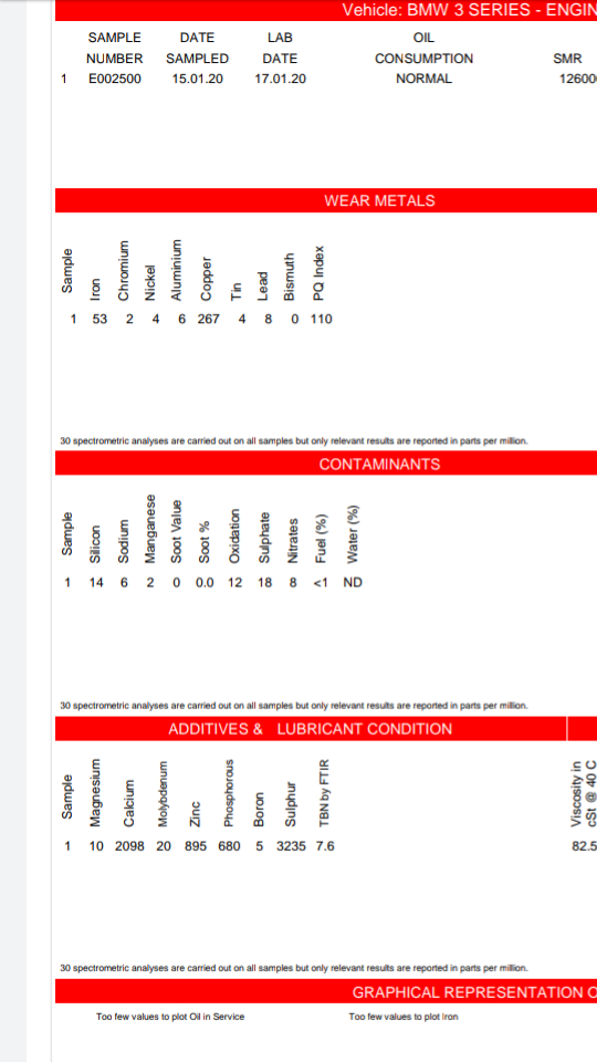

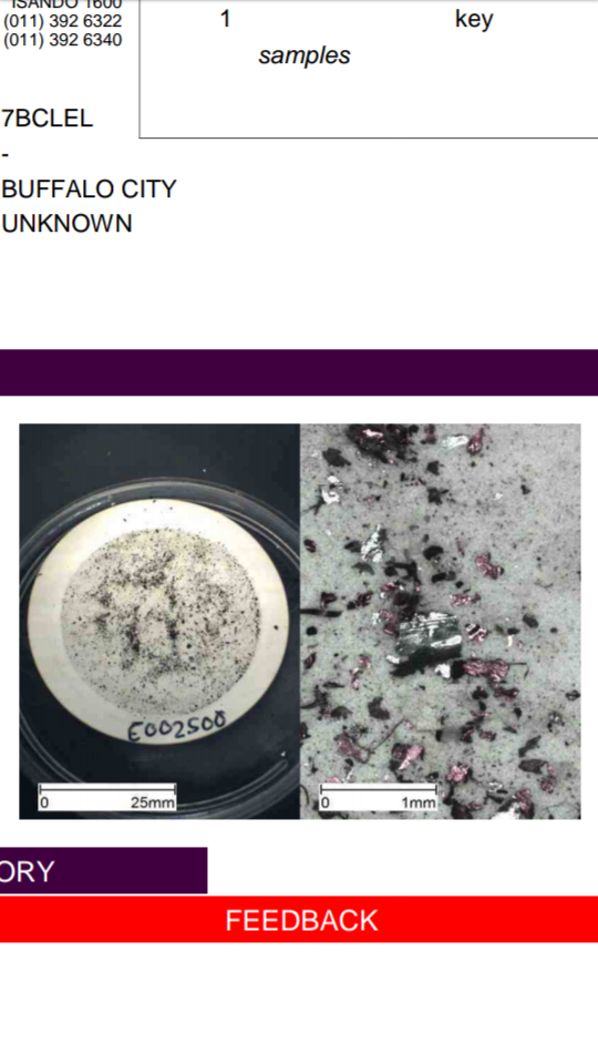

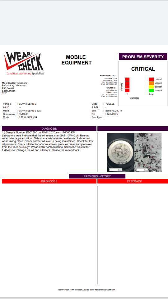

Good day fanatics
I've been advised to send the oil for Blackstone analysis along with stripping to physically check the extent. The stripping will only be able to be done in next week sometime. I have sent the oil for analysis and will be getting the report tomorrow. However I thought I'd post some pics of the oil I sent
KPM3_30
Moderator
Sad to say, seems like the previous owner knew something was up, threw in thick oil to 'slow' the effect of deterioration and sold the car.
I hope I am wrong but that is how it looks from the outside looking in, especially seeing as though this car was hardly driven, by your admission.
