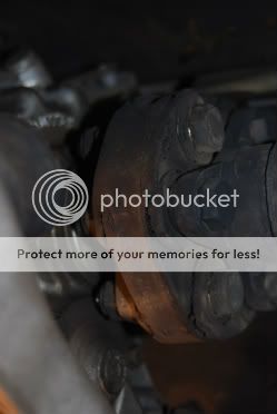

As per P1000's post - a worn Propshaft coupling:
Checked without dismantling anything.
If installed incorrectly, it can cause some more vibrations.
