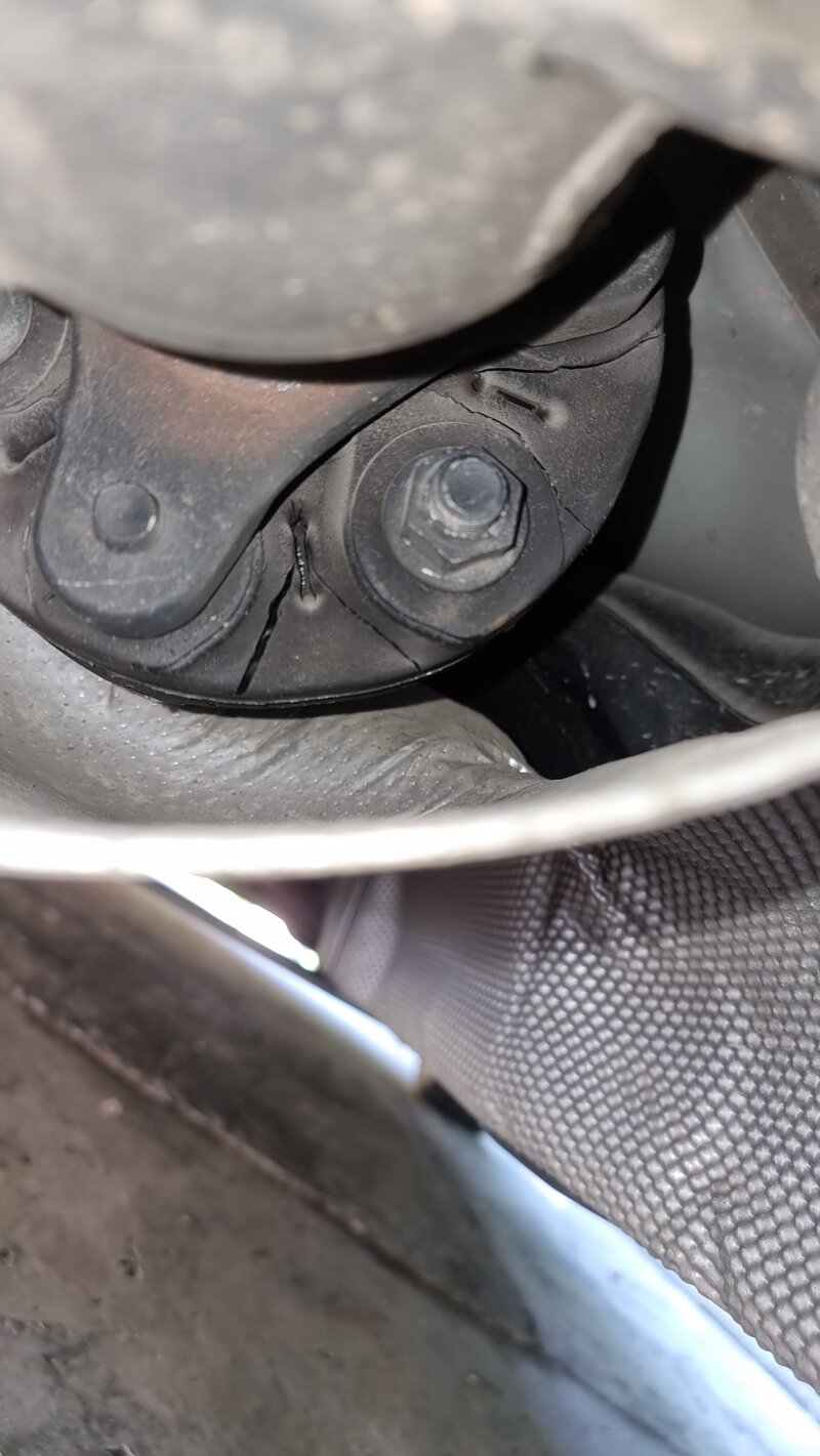

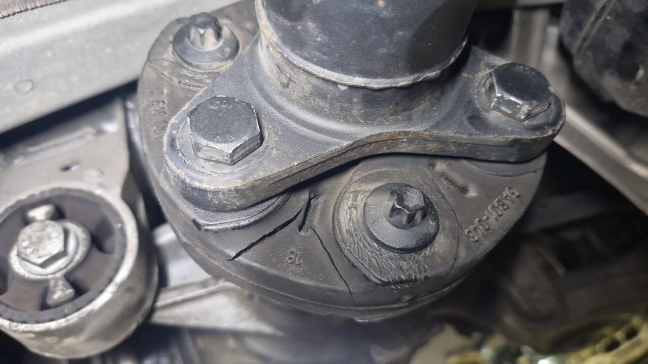

I inspected the rear driveshaft guibo and found it to have some decent cracking, but I'm not 100% sure this is where the vibration is coming from.

I have attached some photos of the guibo.

IMO, Replace the Guibo ASAP. if it breaks apart you will have far worse problems than vibrations/humming. Should have been done while the mountings where being attended to.
AngusCPB
Yep it was pointed out to me whilst the other stuff was being done...just didn't want to wait for the part. So from the photos you think I should replace it ASAP?

I agree, get the guibo done as soon as possible. What is the condition of the front guibo? If you have any further driveline vibrations after replacing the guibo/s, read my "F10 520d vibrations" which i documented last year.

Hi yes I did read your thread too, very informative thanks. Not sure about the front guibo or centre bearing, haven't inspected it yet. I'm thinking of doing a DIY this weekend on the guibo
Nastaliq
Replace that immediately.
