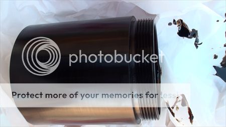

This is how the catch can looks like:
Can installed:

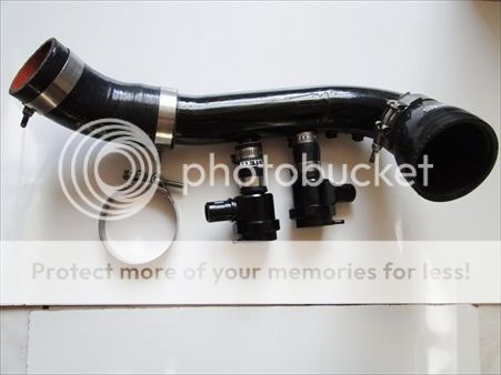

1. First removed the Stett charge pipe.

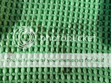

2. The intake pipe was (clean of oil) a little water moist but nothing serious:

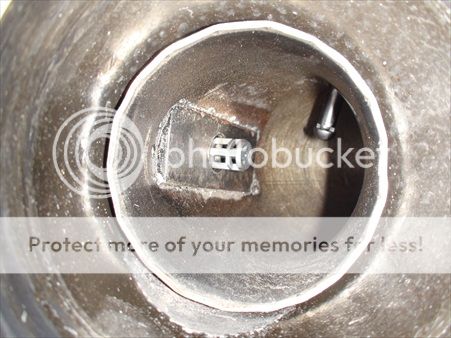

3. And so were the Forge diverter valves & the opening to the Intercooler...all clean. Great news.

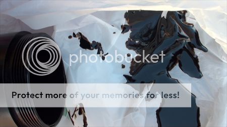

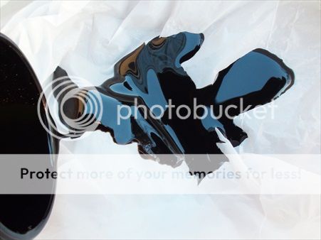

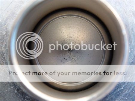

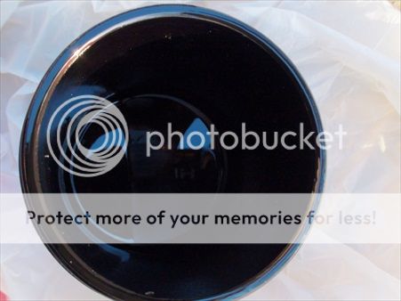

4. Unscrewed the bottom of the Catch Can (took 2 minutes max):
5. As expected there were enough oil collected that should concern one. In my previous mini review I collected much more oil but that was also because I had more kilometers done in comparison to this review:
This confirms why its important to install an oil catch can on a turbo charge car. :thumbs:
