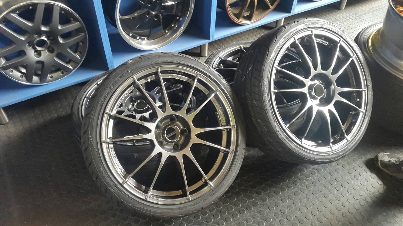

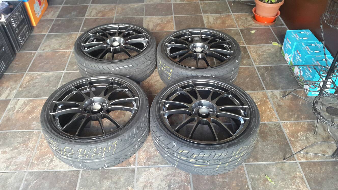

Collected my refurbished wheels from HiTech Mag Repairs.
And got to fitting them to my R.

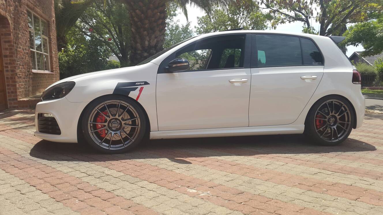

And took her for a drive. Some snaps of the new wheels on my R.

That R is just awesome Porra. The rim colour pops really nicely from some angles. Was this a stock colour or did they blend you something uniqy?
Porra46
Thanks for the comments guys!
The colour is black chrome. HiTech showed me a few examples of colours and shades I could pick from. There are thousands of shades of black chrome. All depends on the type of shading you want. Basically 3 layers of paint.

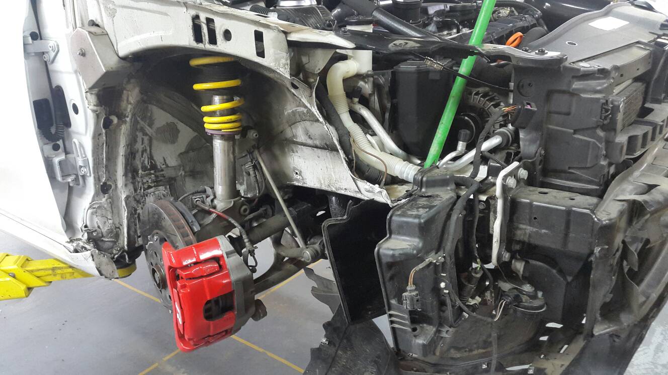

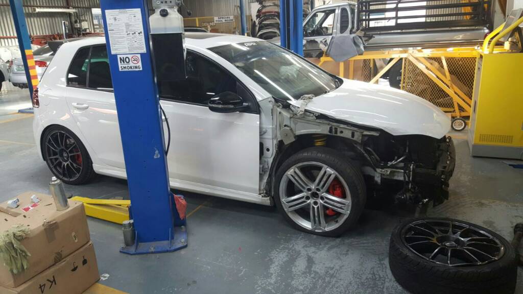

Cosmetic damage is my OZ wheel as well as the fender, right side of my bumper, right side section of bonnet and headlight. A new side skirt will also be needed. the rest of the centre grills and lower splitter remains untouched.

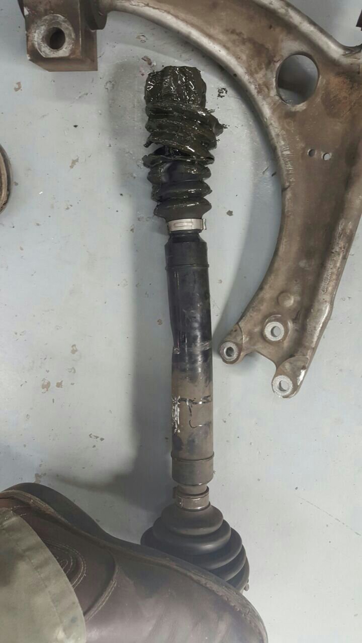

Structural damage is the lower right sill section slightly crumpled from my OZ wheel pushing it back. Right lower control arm, right driveshaft and possible rack damage. There is no damage to the right chassis leg so the motor is 100% and has not moved. The car even starts right. Driveshaft section by gearbox has been inspected and the gearbox is 100% as well. My windscreen washer bottle will need replacing too.
The only really negative part concerning the damage to my R is the passenger and driver airbag deployed. Now while this is replaceable/fixable, it is a very costly fix and I should know by the end of this week if my insurance decide to repair the car or not.
The car is at a very reputable bodyshop. Practically the best I know of. And with my level of attention, I wouldn't want it at any other place. Will keep the thread updated with repair process as I go along.

In the mean time, I have tried to check out the rest of the car's damages and see what is really damaged and not.
Only real Drivetrain/suspension damage is the right front control arm and driveshaft.
Managed to source a set of Superpro lower control arms with integrated Anti Lift Kit from Shaun.
The ALK has integrated SuperPro bushings which sit off centre which help with the 'Anti-Lift'
And the arms are of high quality, just like OEM Passat alloy ones I had.
Further inspection and testing shows no damage to the knuckle, wheel bearing, steering rack or other suspension parts. The top shock mounting seems to have moved a bit, but not seriously. I already have some OEM TTRS top mounts with bearings to go in for that. Mounts are claimed to be a harder shore strength than the Mk6 ones.
