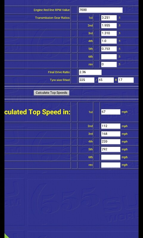

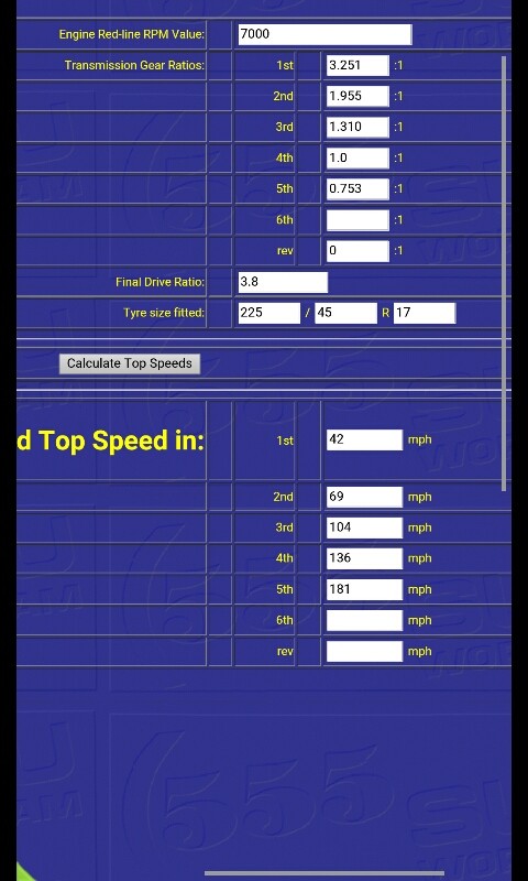

I hear what you say about making a ton of power, but that combination will never work.....(note its miles per hour :skit
as to m3 diff
