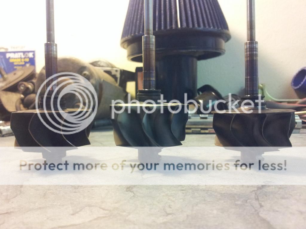

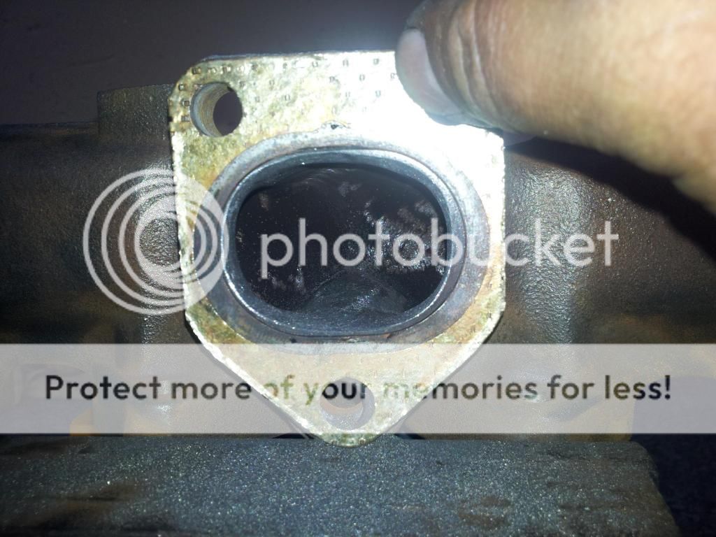

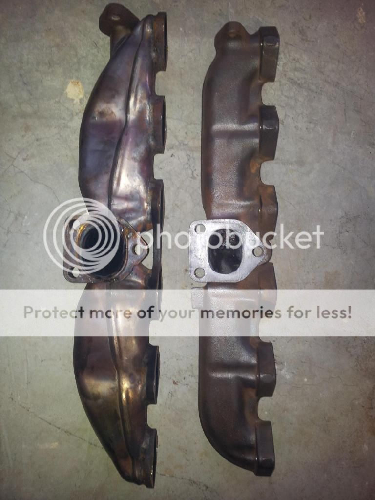

netercol
just a suggestion regarding the cast manifold as replacement for the stainless manifold..
i theorized that the cast manifold was sized and port sizes chosen specifically to supply exhaust at sufficient velocity to get the older design gt2256v as fitted to the 135kw 330d up to speed quickly..
the newer design gt2260v has a more efficient turbine, thus the manifold can be less restrictive and still keep velocity up to get the turbine up to speed quickly.. third generation turbo's as fitted to the e90 330d's have an even less restrictive exhaust manifold because af an even better designed fullback turbine.. here they are for comparison, gen 1,2 and 3 from left to right..
anyways, long story short, i matched the size of the outlet on the cast manifold to close to the stainless manifold outlet to minimize power loss with the bit more restrictive cast manifold.. might be worth the effort if you ever take the cast manifold off again for whatever reason..

Andy1GP
I wonder if exhaust port flowing the e90 manifold will help with spool on the stock electric turbo.
Sent from my SM-G900F using Tapatalk
Nikhil
well diesel fan is fitting an E90 turbo and manifold might as well get him to try it :fencelook:
DieselFan
I was going to use an e90 turbo and take the mani on loan as the turbo sits to the side and not in the middle. But the prelci e90 uses the gt2260v but operates electronically whether there are differences within this. I don't know. But my prefered upgrade would be an lci e90 as that uses a gtb2260v.
With that being said. They are hard to find. So i think I might just get a gt2260v which is vacuum actuated from stock. Which saves the trouble of finding and arm which is suitable for the turbo actautor with vacuum diaphragm.
But anyway I think what andy is saying is he wonders if porting the mani. Which from what I understand is shaving some of the metal off will give higher flow. I think it might. But the inlets and outlets are still the same so will it really?
Maybe if it was ported and polished and if the inner of the mani was very smooth. Then yes the gasses would flow out better.
