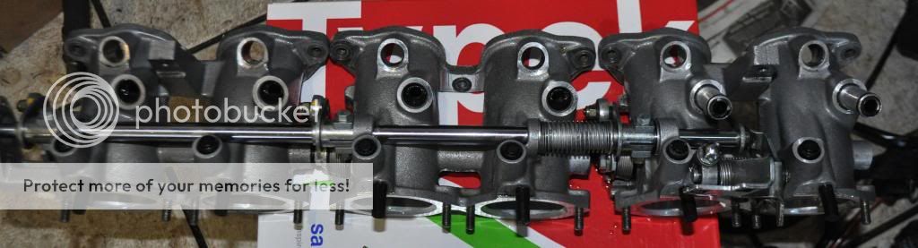

Throttles after just 2 cleans.
More cleaning tomorrow.

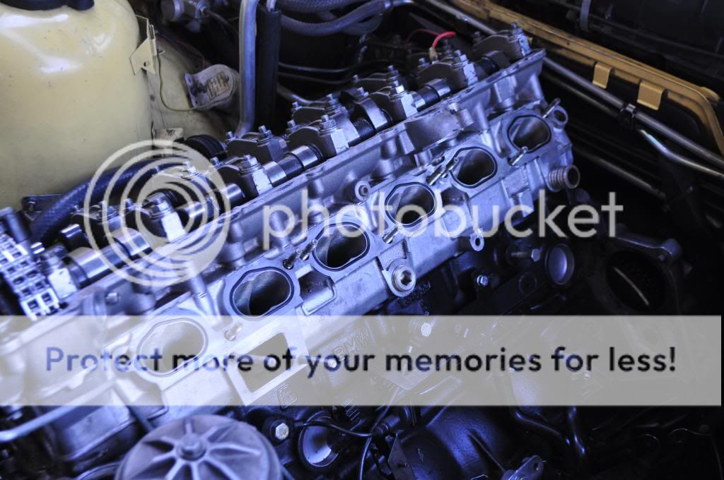

.....and just a pic of the head with the old gaskets still on.....

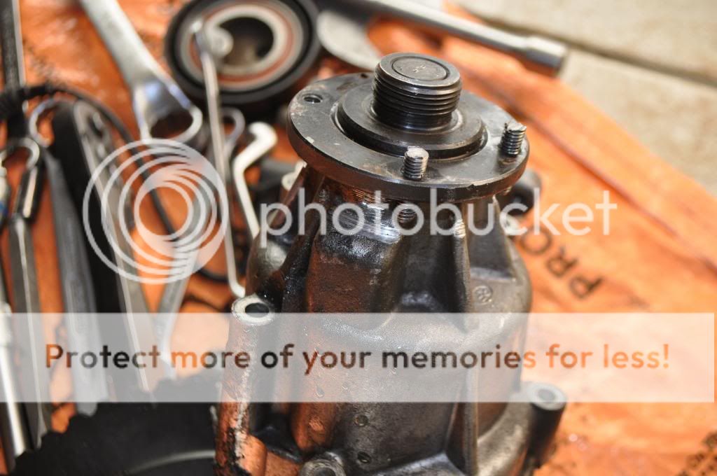

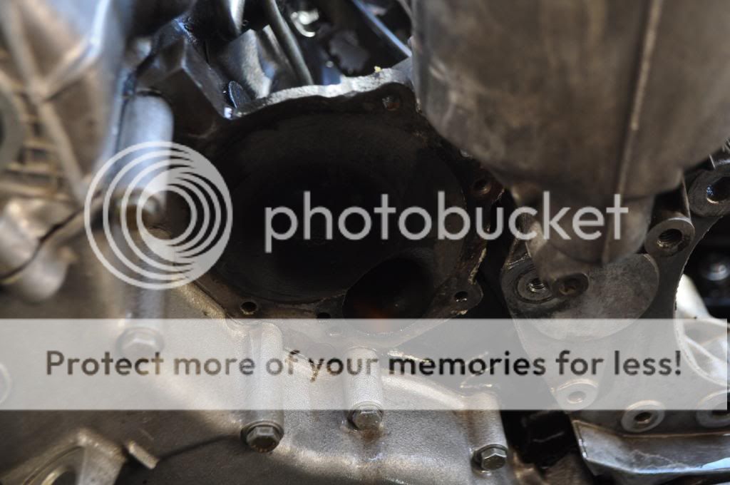

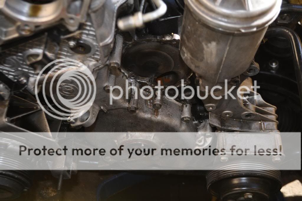

Had to take the water pump off so that the 2 stuck bolts could be removed.
So it is off to the engineers along with the starter.

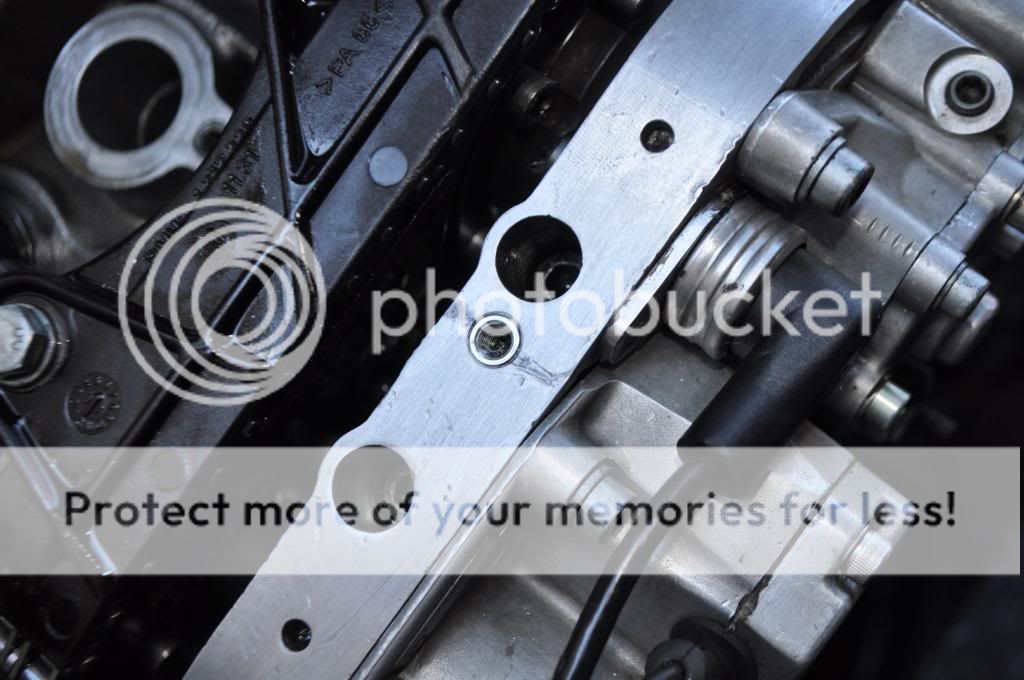

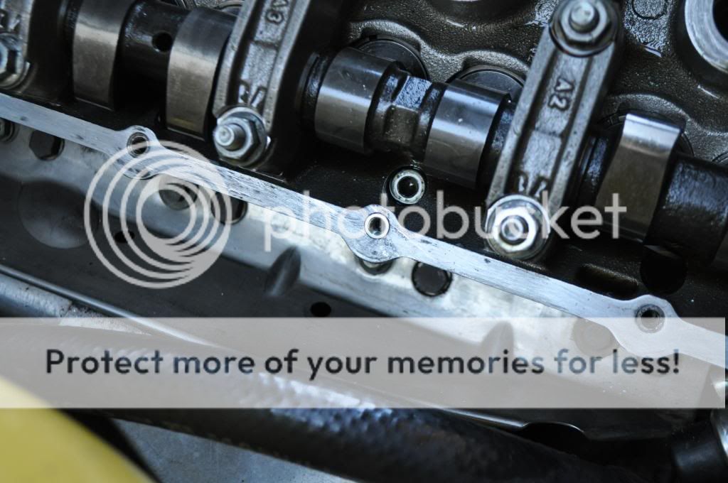

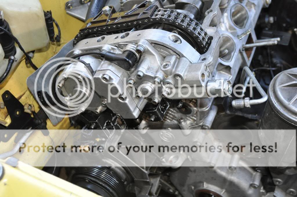

Vanos unit is on.
Had to do inserts on the cam box as we had some stripped threads which would lead to valve cover oil leaks.

What type of inserts did you use on the Alu head? Can the faster heating up and slower cooling of the insert affect its host?
Great work btw
Peter@AEW
No way Ashlin
They are special inserts made by wurth in aluminium and one needs special tools to insert them.
One also needs to countersink the hole with a special tool for the insert to seat itself properly.
The man charges R200 per insert up to 8mm and R400 for bigger sizes to 12mm.....

Thank you , was just curious about different metal properties, but that has been cleared up.
