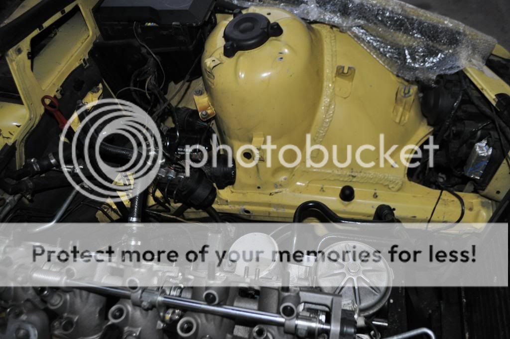

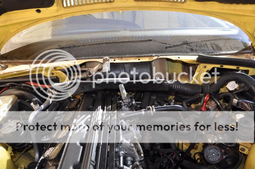

If the throttle cable is going to be replaced, a better routing is behind that black plastic at the back of the engine bay... Apparently it was a recall back in the day....
The advantage is that the 'U' bend in the cable is not so sharp, and the throttle pedal is less stiff.

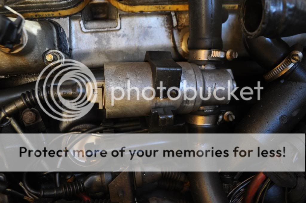

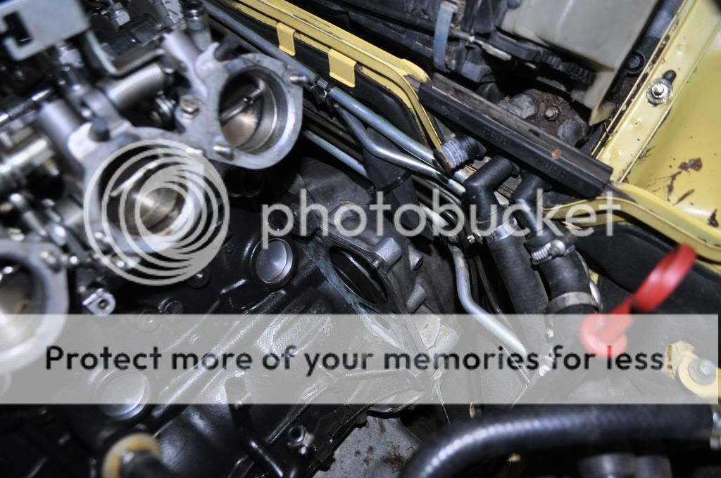

Idle control valve unsupported as the rubber support is broken
A close up fwiw

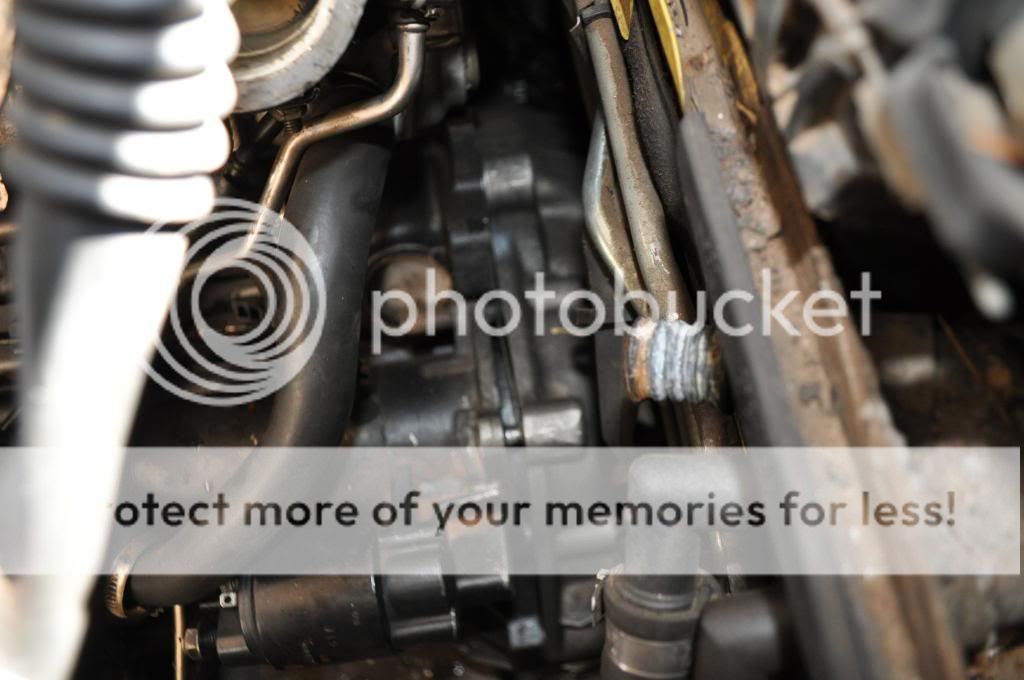

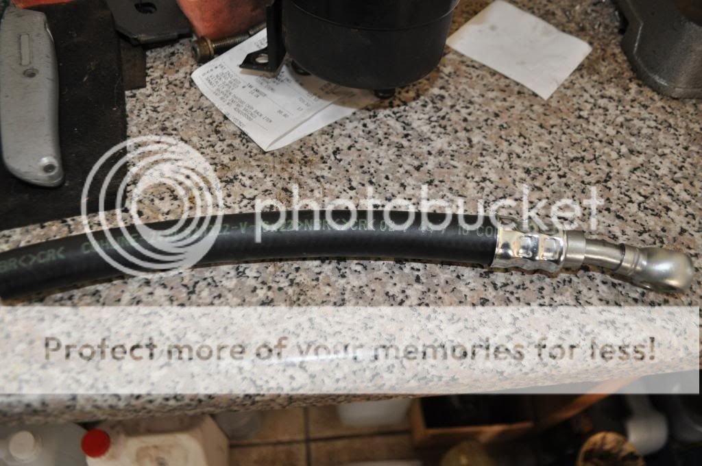

New PS return line

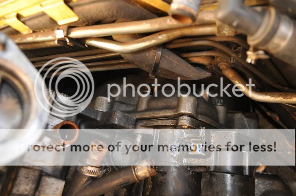

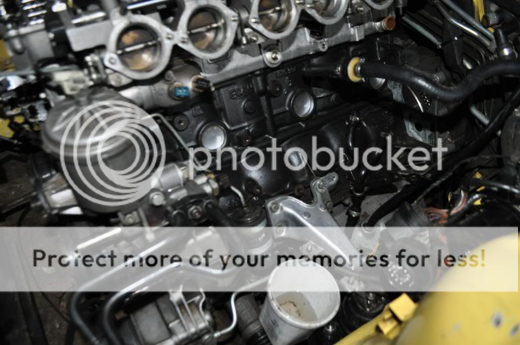

Unsupported fuel hard lines.
Notice the red vacuum line underneath.....factory standard is a thick black line heat resistant.

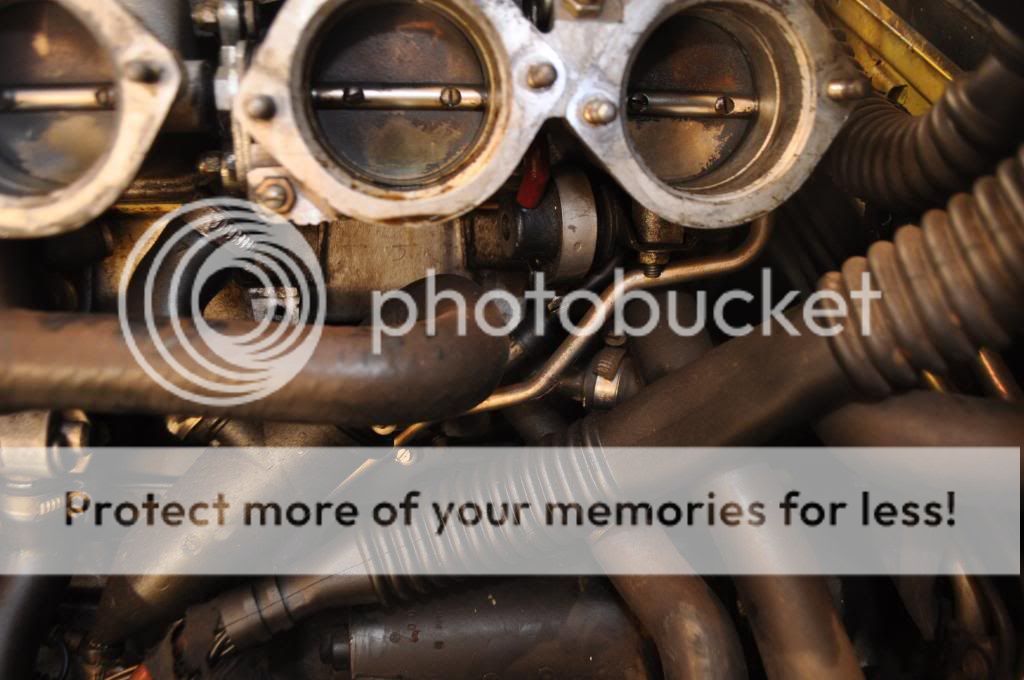

Notice how teh fuel line hose clamp has been placed on the fuel rail.
I wonder how they did that :)

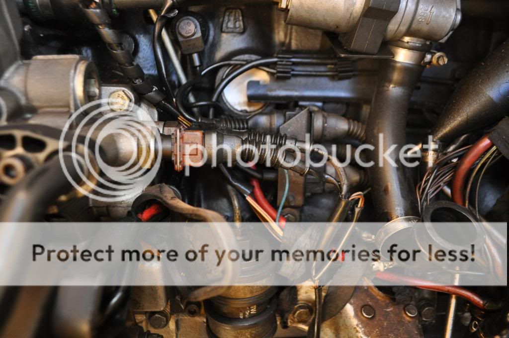

I did a bit of stripping today and was able to establish that the gearbox is missing 5 bolts on the left hand side.
What struck me is the fact that the people who did the clutch replacement on this car work in a BMW dealership as "mechanics".
That really is peculiar.......so much for "full dealer history"
Pics in a moment.

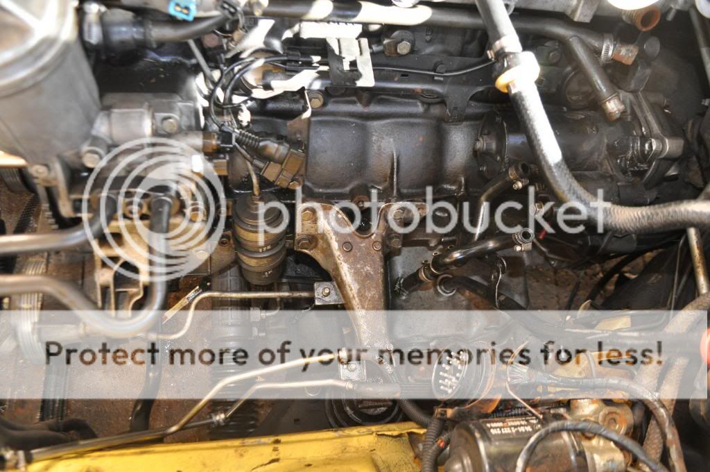

Note the long bolt through the top of the starter.
That is a cylinder head bolt and the starter threads were stripped from previous "mechanics".
The most recent ones just threw a bolt at the starter and did not even bother to place a nut on the backend of it.
Bottom starter bolt was loose due to the fact that the threads were stripped and remnants are still on the bolt.....must take a pic of it.

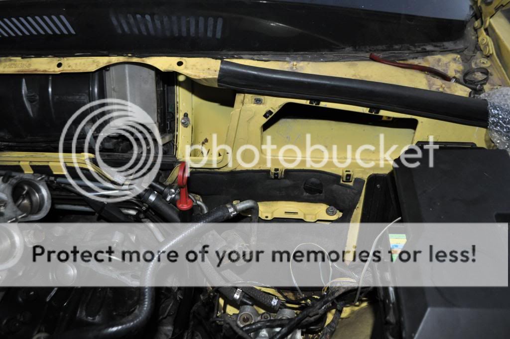

Started cleaning so that assembly may proceed.
