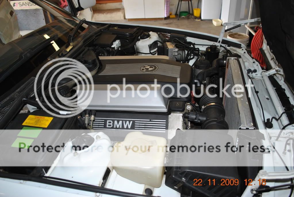

The oil change was also nothing to do, I LOVE that cansiter idea in front for the oil filter, makes the job dang easy. Added the engine cleaner, ran for about 15 minutes, drained the oil and refilled. She took about 6 to 7 litres, but I'll check her tomorrow. Oil wasnt bad, but it could of been better.
Spark plugs are really easy as well, covers off, coils off, plugs out, plugs in, covers on. One of the plugs were not firing properly, I now have again a V8 instead of a V7, car is running smoother now. Real easy when you have decent tools,
