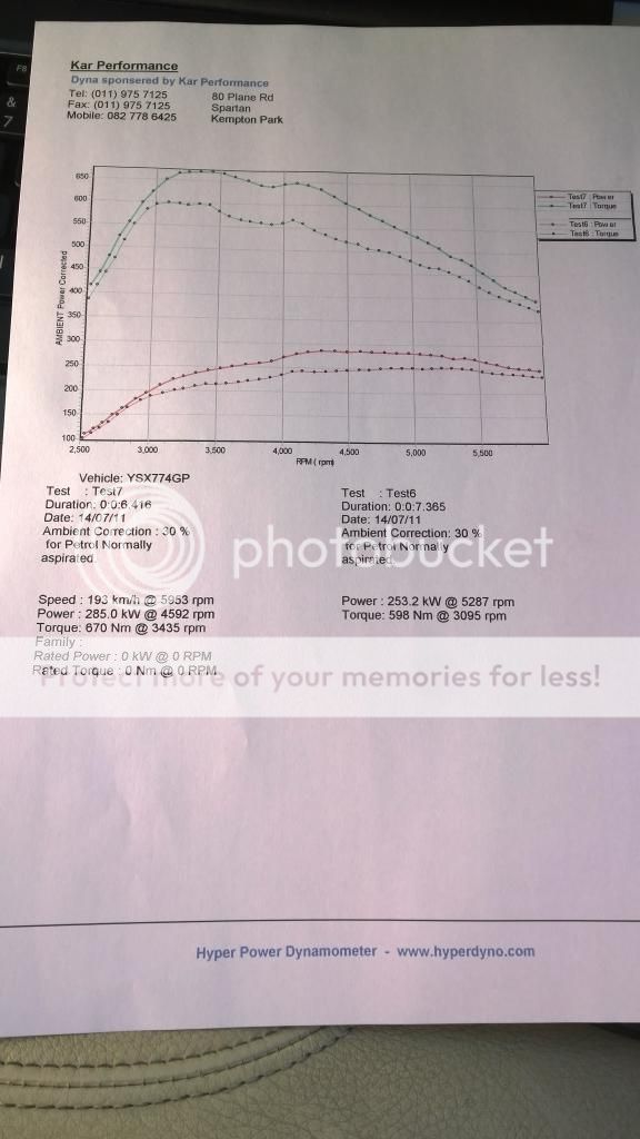

David1 said:Regarding that "100 octane" required by map 7, that is American 100 octane (probably closer to 105-110 for us) :thumbs:
Nicbyte said:David1 said:Regarding that "100 octane" required by map 7, that is American 100 octane (probably closer to 105-110 for us) :thumbs:
Shot Dave get that, this is the info I looked at. The Lab confirmed 102.7 on 40l petrol with NF..
http://www.nfadditives.co.za/products/nf_ultra.jpg
Not sure what this would now equate to in US RON? Any ideas?
Nicbyte said:Thanks for the advice much appreciated. Look I did buy the car for this and this is after all just testing as I have mentioned 100 times.
The Guys from NF say a bottle of Ultra should give at least 100RON per tank. I used a bottle on 40L which should give me the 100oct demanded by map 7. N54Tech has many and many guys running map7 on 100oct. So what you are saying NF is obviously making false claims that could damage my engine.

Kish2604 said:Nicbyte said:Thanks for the advice much appreciated. Look I did buy the car for this and this is after all just testing as I have mentioned 100 times.
NF is not making false claims, their product does work, the problem is when you mix NF with crappy pump fuel, our so called 95octane pump will test much lower than that value, further our 95 octane available locally vs that avail in the states is much different. thiers is much more stronger.
remember the nf bottle says to achieve a 10point increase in octane you need to mix a bottle with 20lt of pump.

Ga-3M said:You do actually realize that most don't really care about your dyno figures anymore due to your poor attitude?
You reply to Kish with a clever comment, a fanatic who took a lot of his time to try and help you and write a long explanation on the issues you were experiencing which you weren't actually aware of, and you display a lack of maturity which everybody has now seen.
Anyway, carry on :bravo:
Sleeper135i said:Decent figures, well done.
What is your goal?
Btw your 20psi boost was a boost spike as a result of the throttle closing. But i'm sure you picked that up.
As a few people have said before, your timing is terrible on those logs. Get some decent fuel. Turbos are prob at their limit at you current 18psi. Any more than that and they'll last less than 6 months and turn into smoke machines. Ask me how I know.
