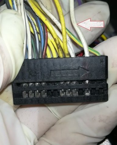

5. Connect the Fuel- it ECA 0-5 volt (white wire) directly to the DME pin #16 of the small black subconnector. My wires are a little dirty because I had to remove some sticky tape from the wires that left some ugly residue. Pin #16 is the DTML or DM-TL signal which should be empty and is used for the ethanol signal. [DTML in USA cars refers to the LPFP - Diagnosis Module Tank Leakage & heating module]

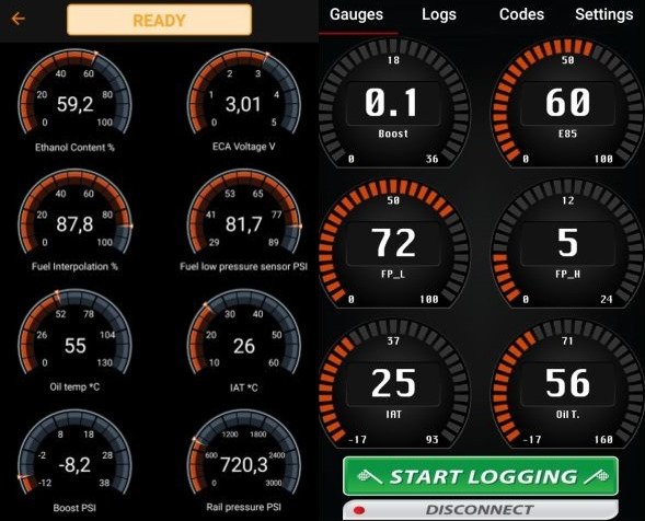

9. Activate the appropriate settings in the JB4 Ethanol Setup. Particularly, settings 0 and 1 and 2. See picture below.
10. After flashing check the ECA voltage, ethanol content, fuel interpolation values at (idle) in MHD and then compare with the values in the JB4 app. Ensure the MHD Flex Fuel map values correspond with the map values in the JB4 app (as close as possible).

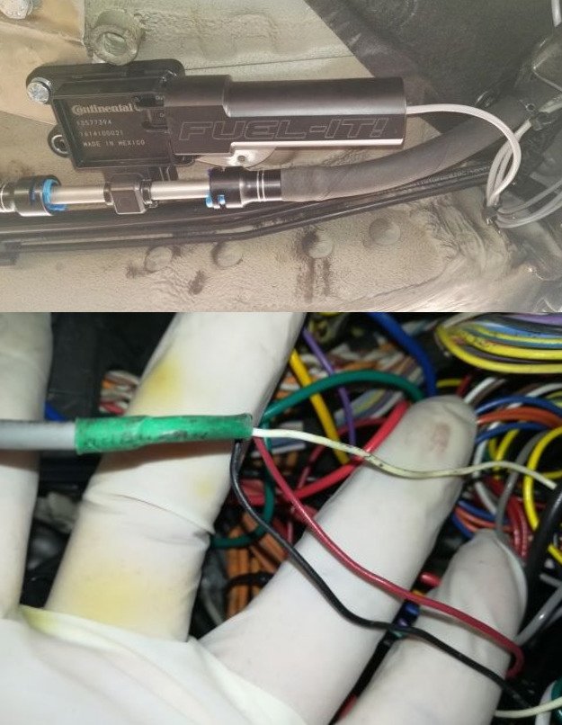

1. The Fuel-it Flex Fuel kit I have is the Bluetooth and 0-5 volt analog signal for use with JB4 or an analog gauge. The kit comes with a Flex Fuel sensor, analyser and a cable with 3 wires.
2. I will assume that you already have the Fuel-it Flex Fuel sensor and analyser installed as per the above pictures.
3. Connect the Black wire to Ground. There is a solid ground close to the ECU box.
4. The Red wire goes to the Orange Power wire at the green connector. I used a positap for that connection.

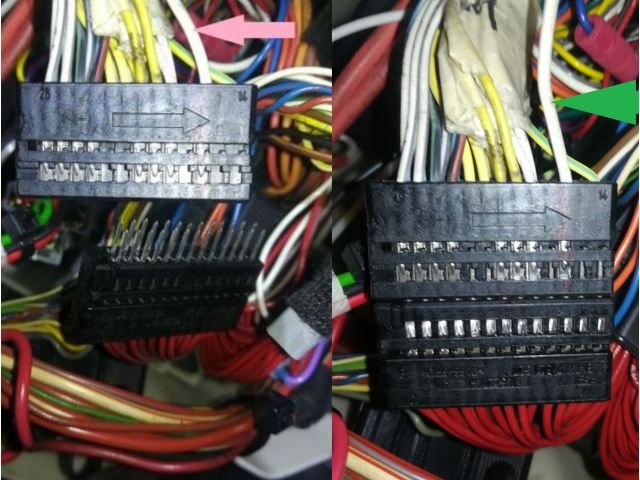

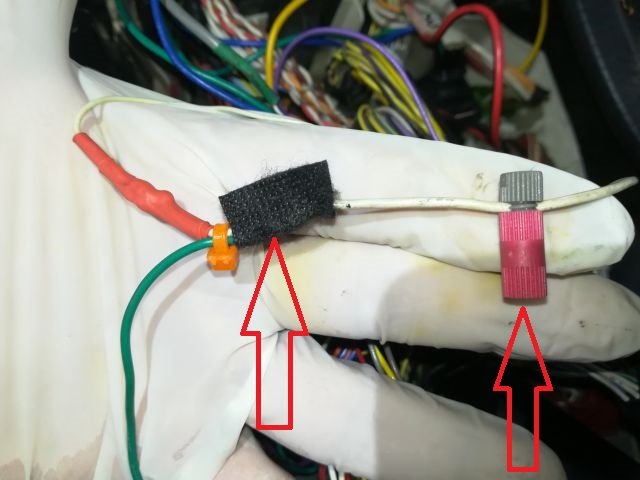

6. Now for the tricky part.
Splice an extra wire into the Fuel-it ECA 0-5 volt (white) wire that is wired into DME pin #16. I soldered mine but you can also use a positap to connect the extra wire. I used a green wire as the extra wire.

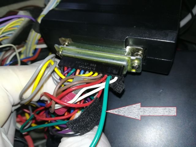

See the picture below that shows the two options. Once you have spliced or positap the wire - slot in the extra wire (Green) into pin #2 in the JB4 DB25. This will allow you to read the ethanol content in the JB4 logs/Jb4 app directly from the DME.

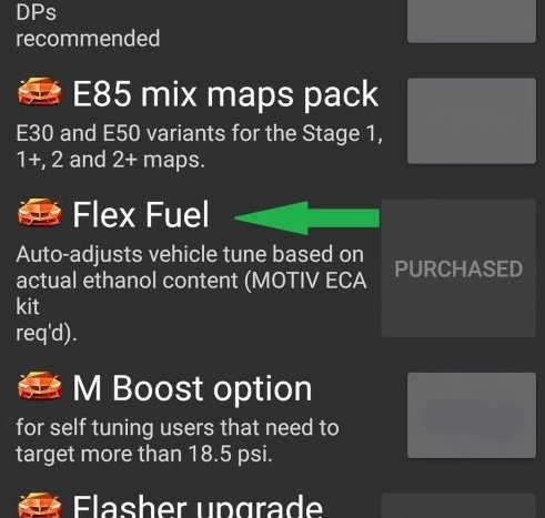

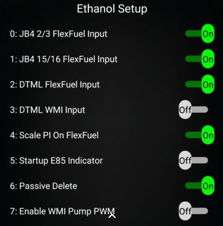

7. Purchase the MHD Flex Fuel flash module licence from MHD. This flash module will automatically detect the BMS JB4 Flex Fuel map and apply the blending tables when you flash.
