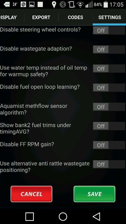

Its there :=):
Just click in the blank space next to FUD and the options will open.
FiRi@Rennzport
Psypher13 said:
Ok cool
Will have to see for updated version
I use android and no options there
Load new hex...
To find the settings and new option as Twinz as showed via screenshot, go to
Settings
User adjustments
Scroll down to future D and click on it.
