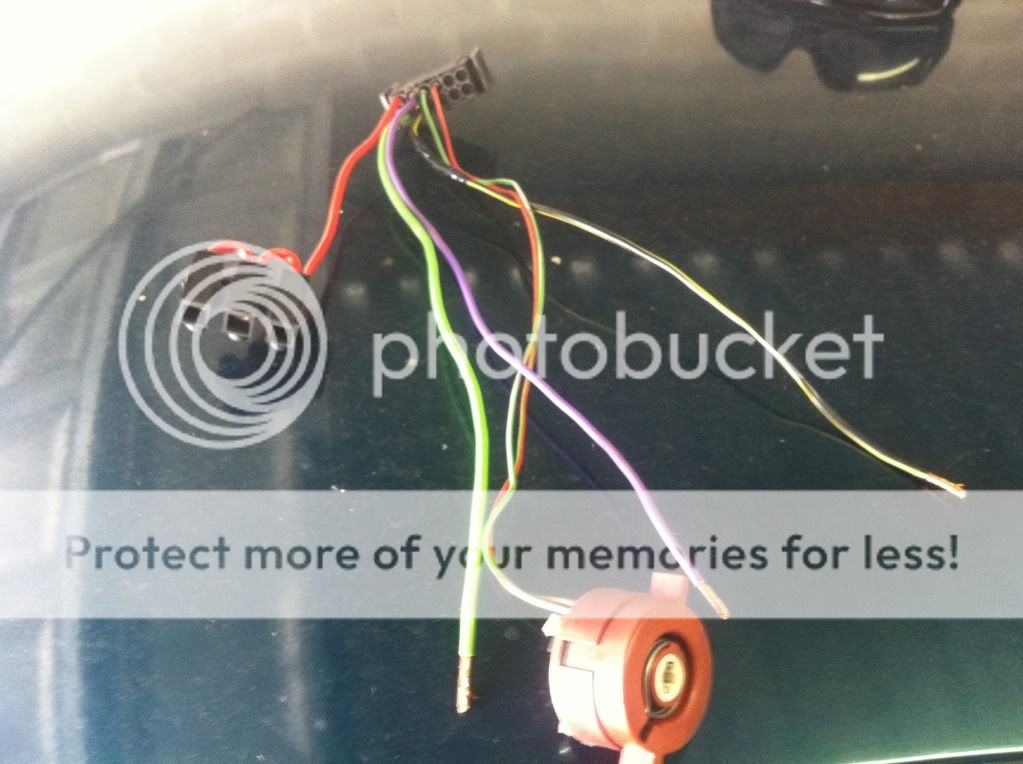

After stripping the steering column to gain access to the wires and shit (now you see why I needed help) we removed the little red thingie at the back and connected a strip connector to it.

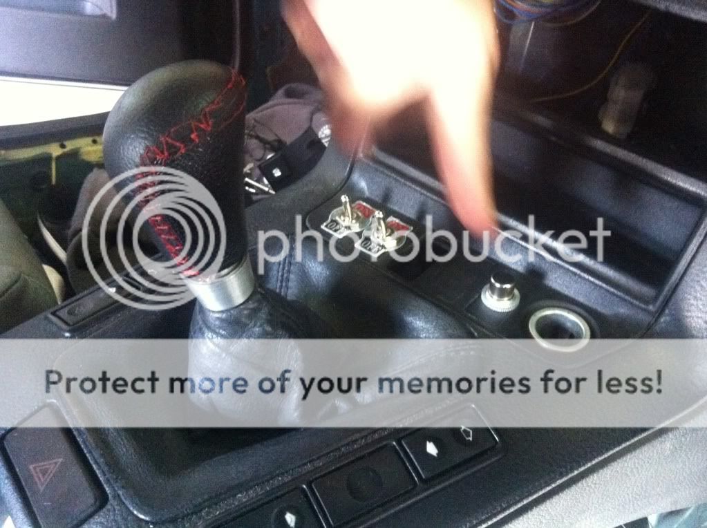

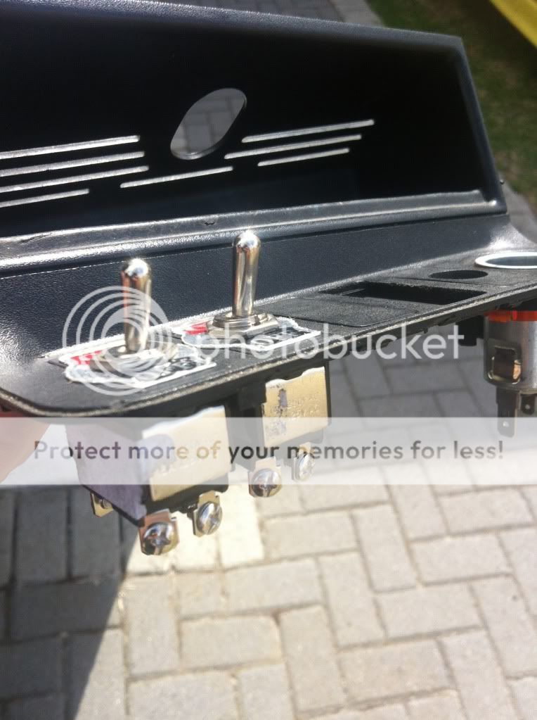

We used an old center console unit to fit the switches and push start.
Plenty of tag team reaming to ensure a snug fit... 1 broken vice, nearly losing a finger and a few minutes of hysterical laughter we managed to fit the ACC and IGN switches.
Here is an action shot of Freerider going in for the kill.
Not even a stumble the car starts. The ews is still active so I can insert the key, flick ze sweetchez and hey presto she starts. Then I can remove the key and she still runs. Flick ze Sweetchez off and try with out the key and it's a no go. So I still have security on the car. BIG PLUS POINT.

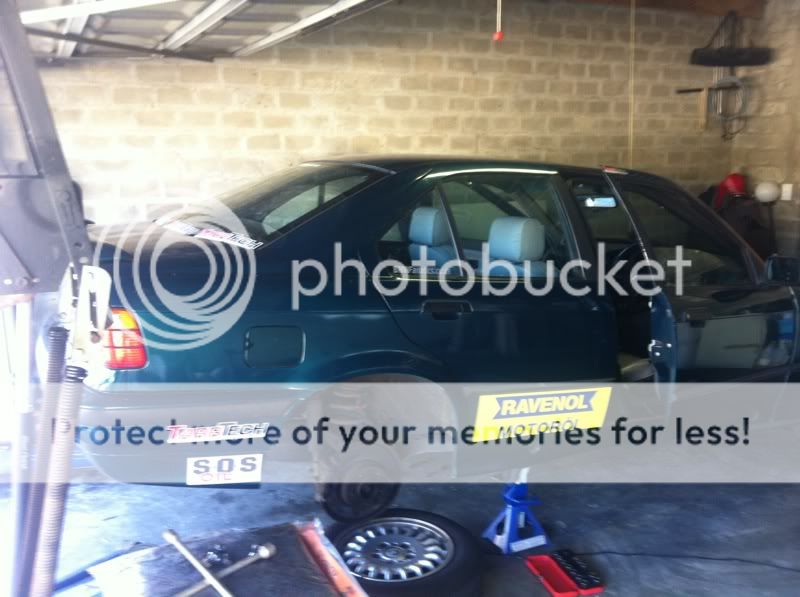

So we decide that after the F1 on sunday we could quickly change the diff to the 3.46 Freerider had also organised for me.
Firstly.. do not attempt this job if you are doing by yourself and want to be done in 1 day. Cos it's a MISSION.

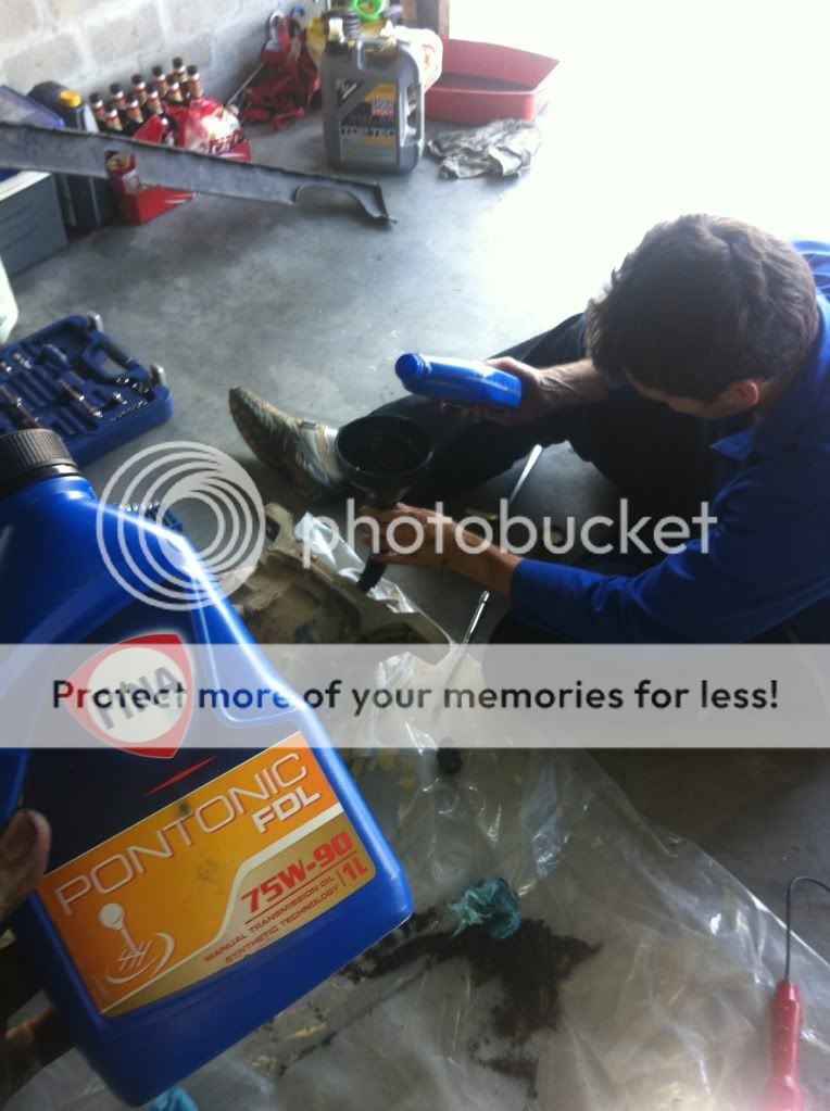

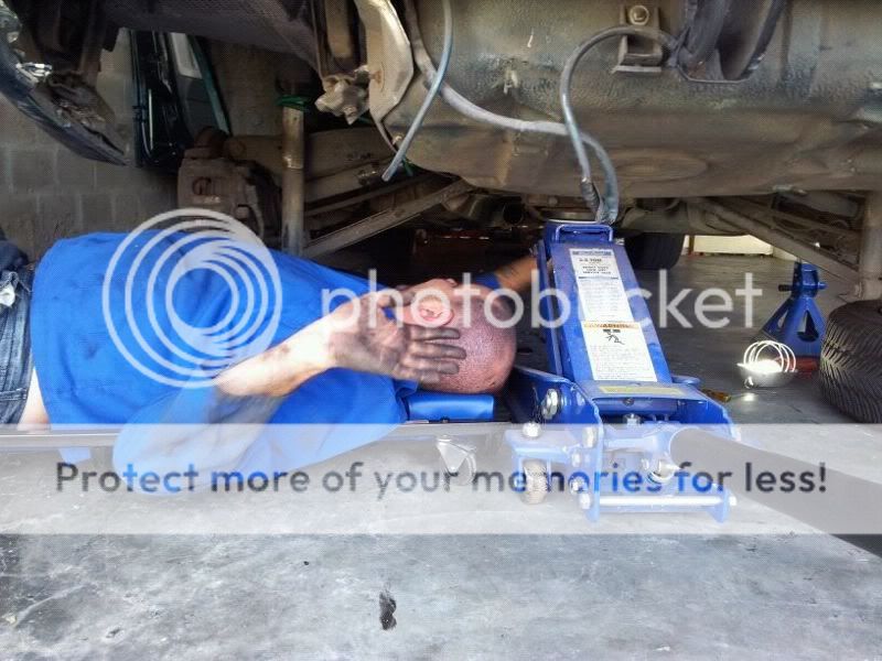

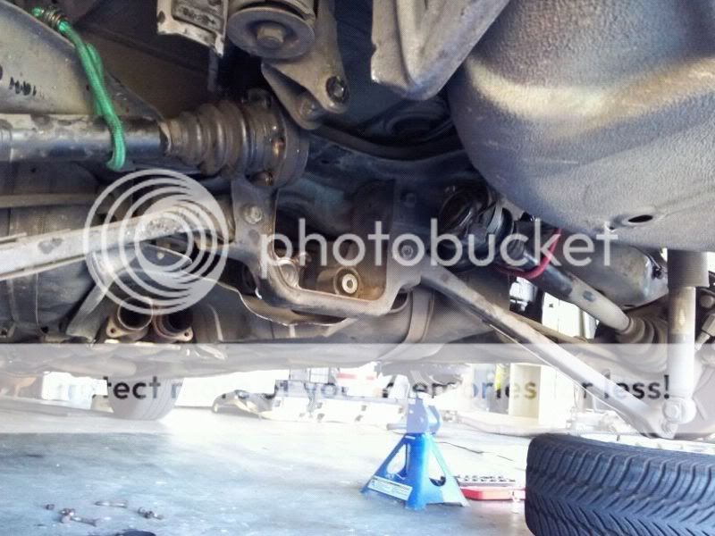

Firstly remove old Diff:

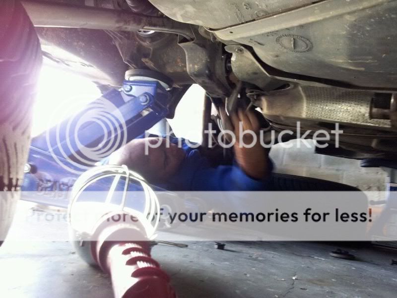

Then fit new diff with fresh diff oil.
Me tightening the +-20 different nuts and bolts. Thankfully Freerider was operating the handbrake otherwise it would have taken for EVER to do.
