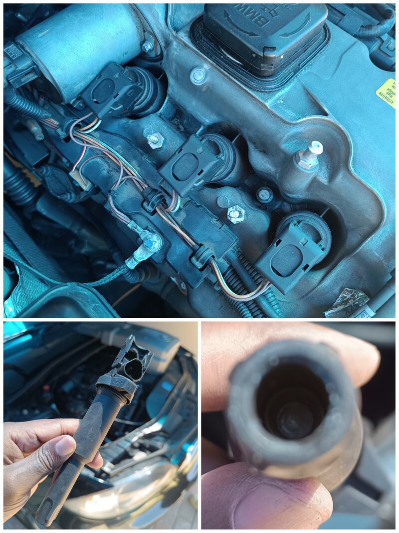

I made mistake by believing that changing my 17 year old Bosch ignition coils will make a difference, the 130i had not issues with coils I've never even experienced a misfire on the 130i ever since owning it 2019.

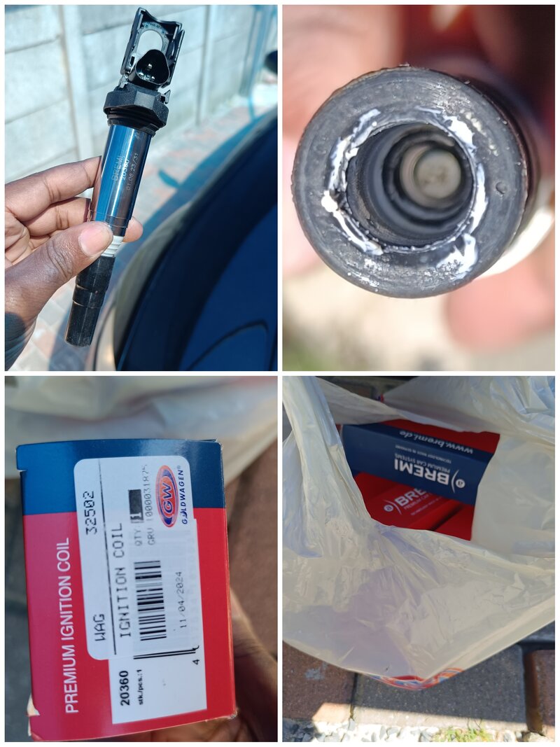

So in August 24 I bought 6x new Bremi Ignition Coils from GW they didn't have Bosch in stock and I was convinced by the sales person these are good quality similar to Delphi coils so I bought them all, not knowing in 2 months time these would misfire under full load a complete waste of money.
I installed the original coils back and the car is running smooth again, I first thought I didn't installed them correctly because the original ones have a positive click on the spark plug and the replacement coils just sit on top of the spark plug thinking maybe they loosened and it was not the case.

I ran bremi coils on my e92 n54 335i for over 6 years till I sold it.. no problems now also have them in my 435 no issues on my end.. 2 months is very short time for coils to last maybe try returning them? Is all of them faulty?
Saida
I think their policy has no warranty on electrical parts. I'll try my luck to return them it's just disappointing, I believe it's one that has failed but my OCD cannot allow different ignition coil brands i just removed all of them.
