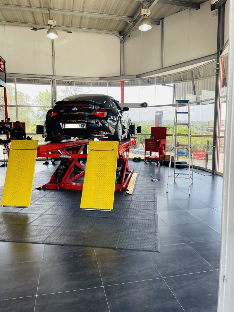

Cleaned and Reassembled the brakes with the new pads and sensor .
Removed the front bumper and sent it to the panel shop to get painted due all the stone chips.ect
Received the strut tower re-enforcement plates from bmw
Without the plates
With the plates installed
Left the oil to drain overnight . Oil still looked clean and only did around 1500kms from last service .
I also drained the oil cooler
Changed out the oil filter with new one from agents
Drained the radiator
And the engine block
Filled up new coolant and distilled water . Bled the cooling system.
Still not happy with the burnt looking calipers , will paint them when I get a chance .
Once I have the bumper back from the panel shop I can start fitting it back and also incorporate Ram air brake cooling .
Im still contemplating steel braided lines but need to remove the lines and send them in to be made up which will take a few days and I’m running short on time . So will bleed the brakes when I have the new lines or before going to the track.
Will see how it goes .
