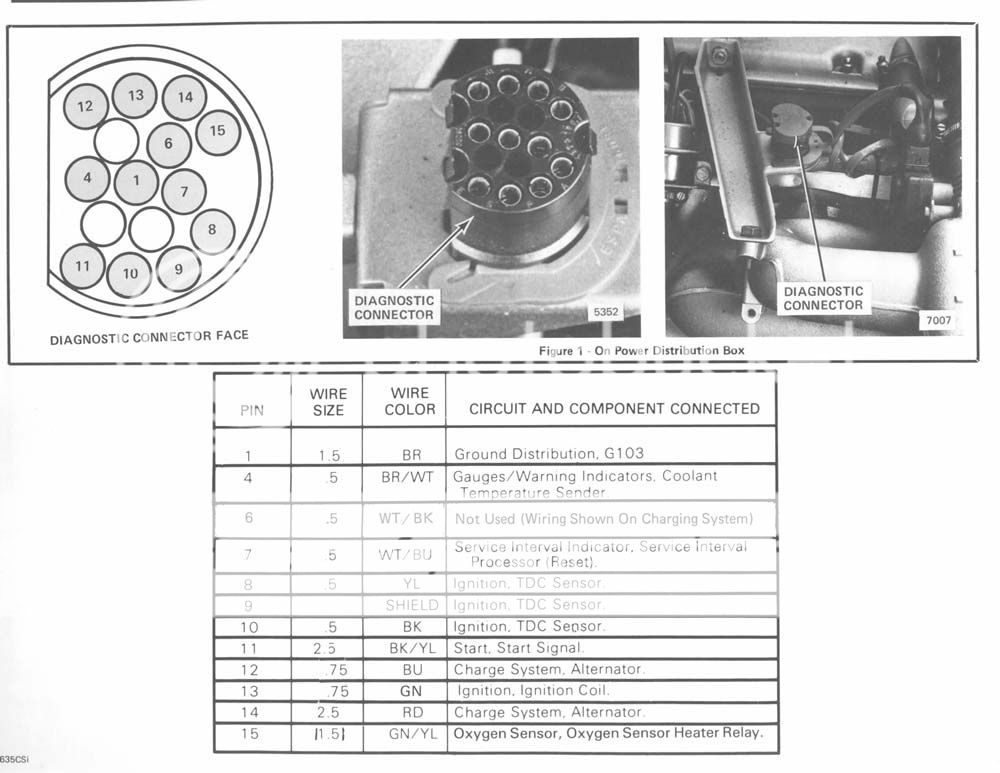

I wonder if your car needs the "short wire" start, that Clownshoe's car often needed to start.
He had to connect 2 pins, in the obd connector, with a wire to start the car. The pin numbers are 11 and think 9 or 4. They in the position of 2pm and 8pm if I remember.
I remember doing it when I had his car in Jan.
Clownshoe, please confirm the pin numbers.

Close... 11 and 14. That completely bypasses the ignition switch, if that works you have a faulty connection somewhere between the starter and the key.
Also check the starter relays on the side of the fuse box. A couple of bucks from midas, so worth swapping them out anyway.

So basically just bridge them with a piece of wire? No need to solder or anything like that?
I replaced the two next to the fuse box,wonder if one of them hasn't gone again,so will double check that!
Thanks CS,trying to get as much of the cosmetic stuff done as possible!
Sorry,just to check,CS are you talking about bridging on the OBD connector in the engine? The one below?

Yes Bugger, the OBD connector like in the pic above

Ok cool,thanks for the help guys! I will give it a bash during the course of the day and see if the old girl coughs into life. But what happens then? I guess the car will need to go to an auto electrician? Is it only a temp fix?
Clownshoe
Make sure the key is in the run position. And as you bridge it expect to see some sparks and jump into life. The map for the ports in the OBC connector is under the lid. If nothing happens and no sparks it is probably the battery. But check the battery first before electrician.
