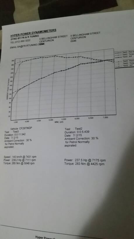

Baseline Dyno @FR+R
239 RWHP
285nm
Mods
Decat with O2 errors
Stock BMW Software (latest update courtesy of OBDWorx)

Just as a reference for data other than dyno figures.
I note that between this M3 and the other 3 S54's above there is one big difference. This dyno the car only managed 143kmh (FR+R) and the other 3 managed 154 and 156kmh (KAR)
I suspect this could be calibration difference between the dynos and operators.
The only other reference I have is a Dyno Riaan made at KAR while it had software on. 183wkw modded and 186wkw stock iirc.
Andy1GP
Oh and this one the dyno stops at 7500rpm and not 8000rpm. That 500rpm could make up that 10kmh difference.

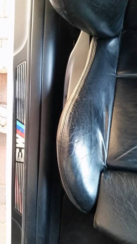

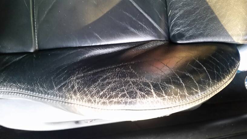

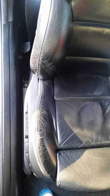

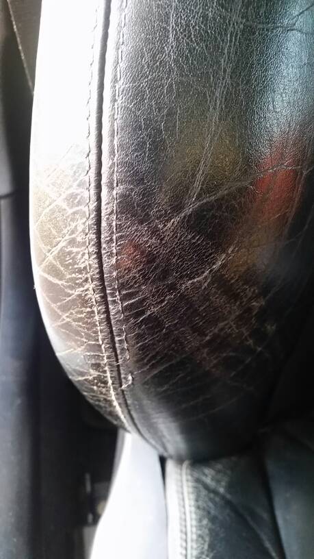

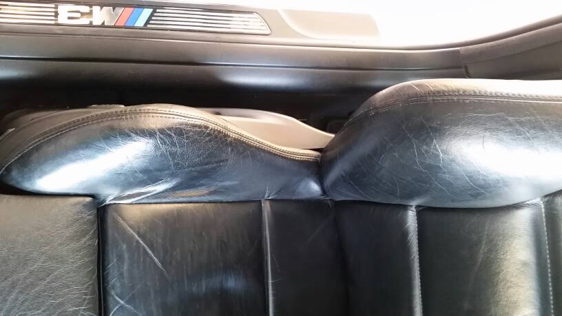

Decided to have a go at rejuvinating the worn bolsters a bit before trying to source other seats or having them re trimmed.
Before
After
Also want to add that I only cleaned them up, and applied a single layer of paint over the bolsters. Want to have another go later on. Will wait for the paint to settle in and then soften the leather up again, clean it and repaint again.
