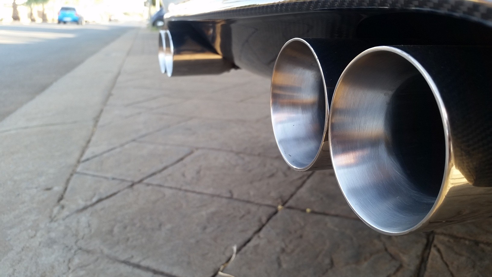

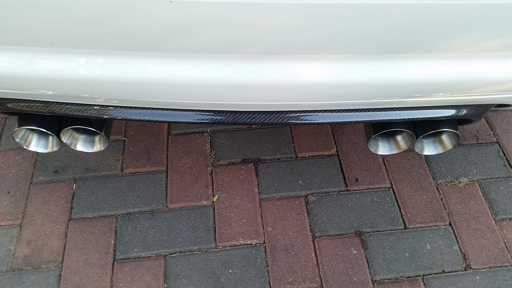

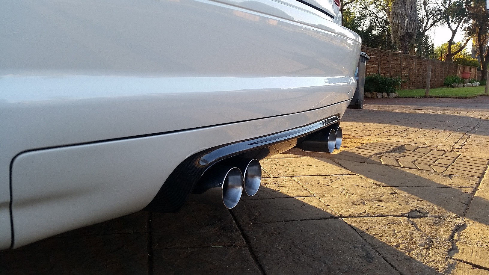

Using it as my Daily drive now :) Also fitted the OEM backbox with new tips. The previous tips weren't quite to my taste.
Loving this car so much right now!

Yash I prefer these tips over the stock ones by miles. It cleans up nicer and don't look tinny and skinny. Similar in size (slightly larger OD) but I mostly like the chunky tapered innards.
