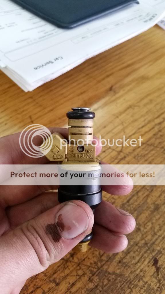

Andy1GP
Bumping a great thread.
I'm possibly changing my injectors on the S38b36.
They currently have the OEM bosch (yellow top) ones 280 150 701 and considering changing them to the -947 (blue top) ones.
Whats interesting is that the blue tops are OEM ford mustang 302 / 5L injectors. They flow slightly more than the 701 ones.
