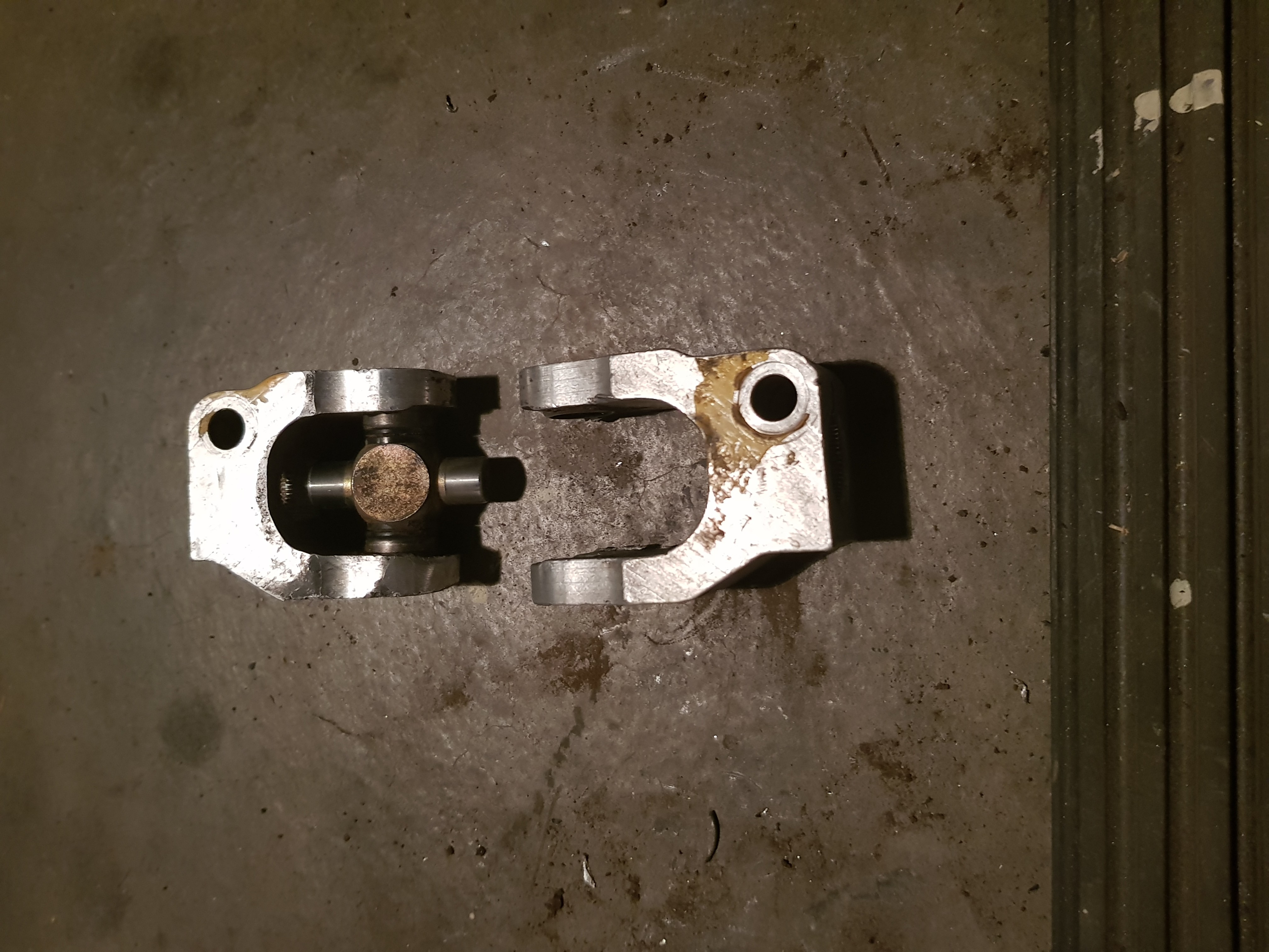

So continued with my steering linkage over lunch today!
Here’s the caps which house the bearings.
As you can see, 30+ years of Shit had accumulated.
Good clean, and reassemble. Smooth as silk now!
Warning, if you have large hands like me. Have patience:roflol:

Thanks for the Pics, so you simply remove, clean, re-grease and in it goes...Im sure this is an off-size bearing, similar to the one in the steering column...Agents only...
Silly question - how did you persuade those little fellas out of there? Needle rollers are just to fine for my finesse...:hammerhead:. I am assuming you remove those retaining clips, do they just tap out, or it it something for my trusty thumb slammer?
Ocky
Correct sir!
So what I did was take a soldering iron to the wee tabs to heat them up. I could then easily bend the tabs to the open position.
Removing the caps require careful pressing.
Don’t be harsh on them! End of the day, if the caps bend out of shape. They won’t allow the bearings to turn freely! Back to square one

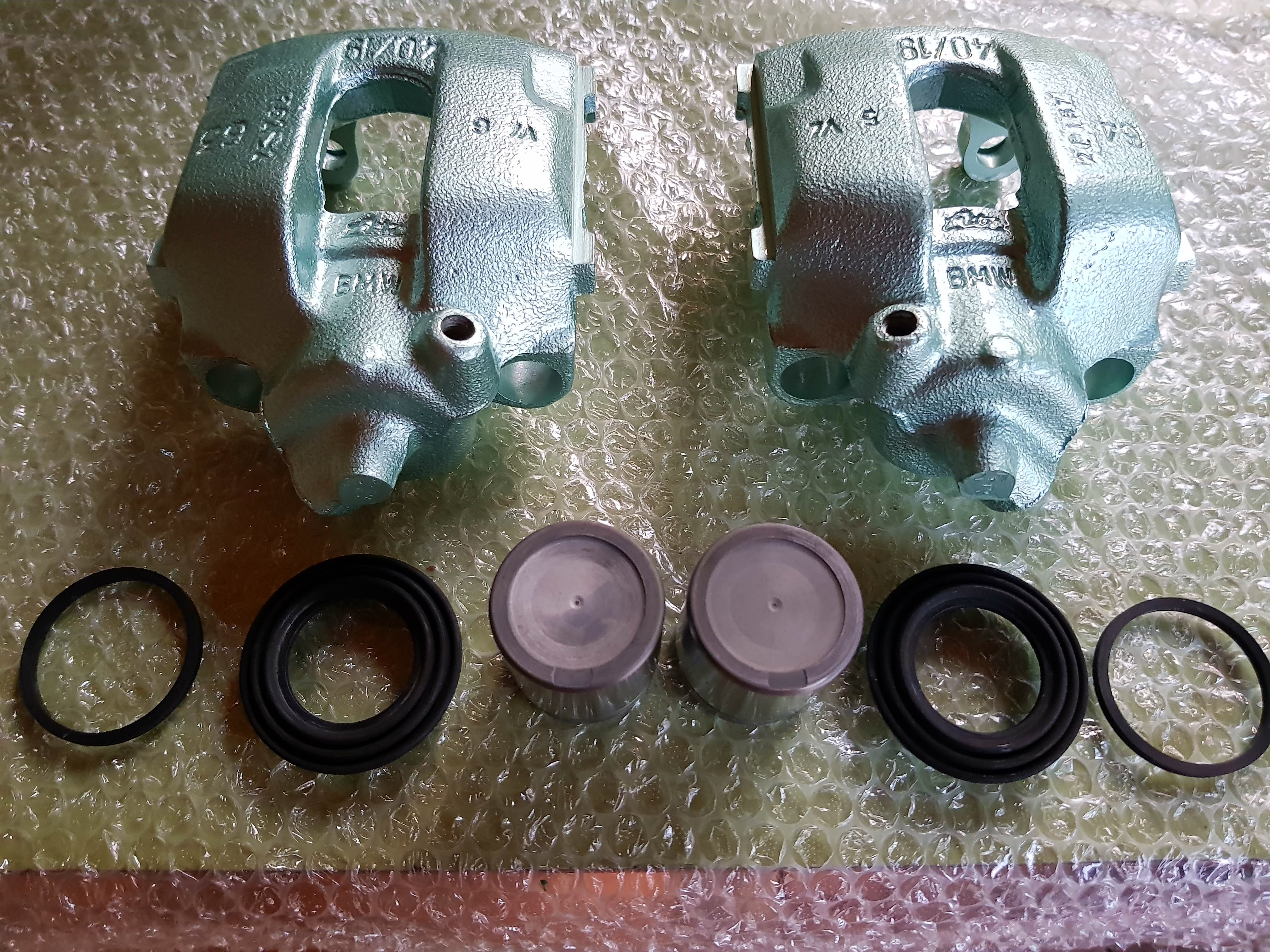

Today I had an hour spare so I stripped down my rear brake calipers for reconditioning.
I’m using e46 328i rear brakes.
My scope is to strip down/clean/repaint.
I bought new pistons, hydraulic seals and dust protection seals from BMW.
First step was to remove the piston.
Easily done if piston is not corroded!
Once you pull out 3/4. The dust protection seal can be popped out of the piston groove.
After removing piston and dust protection seal.
The Hydraulic seal can be seen. It sits in the second groove towards rear.
At this point you clean both grooves. Depending on level of corrosion. Wire brush attachment for drill can be used.
Once all cleaned. You are ready to reassemble!
Ensure to use either assembly lube or brake fluid.
I’m going to be sandblasting and repainting my calipers.
Once I’ve finished doing that,
I will post pictures when reassembling.
