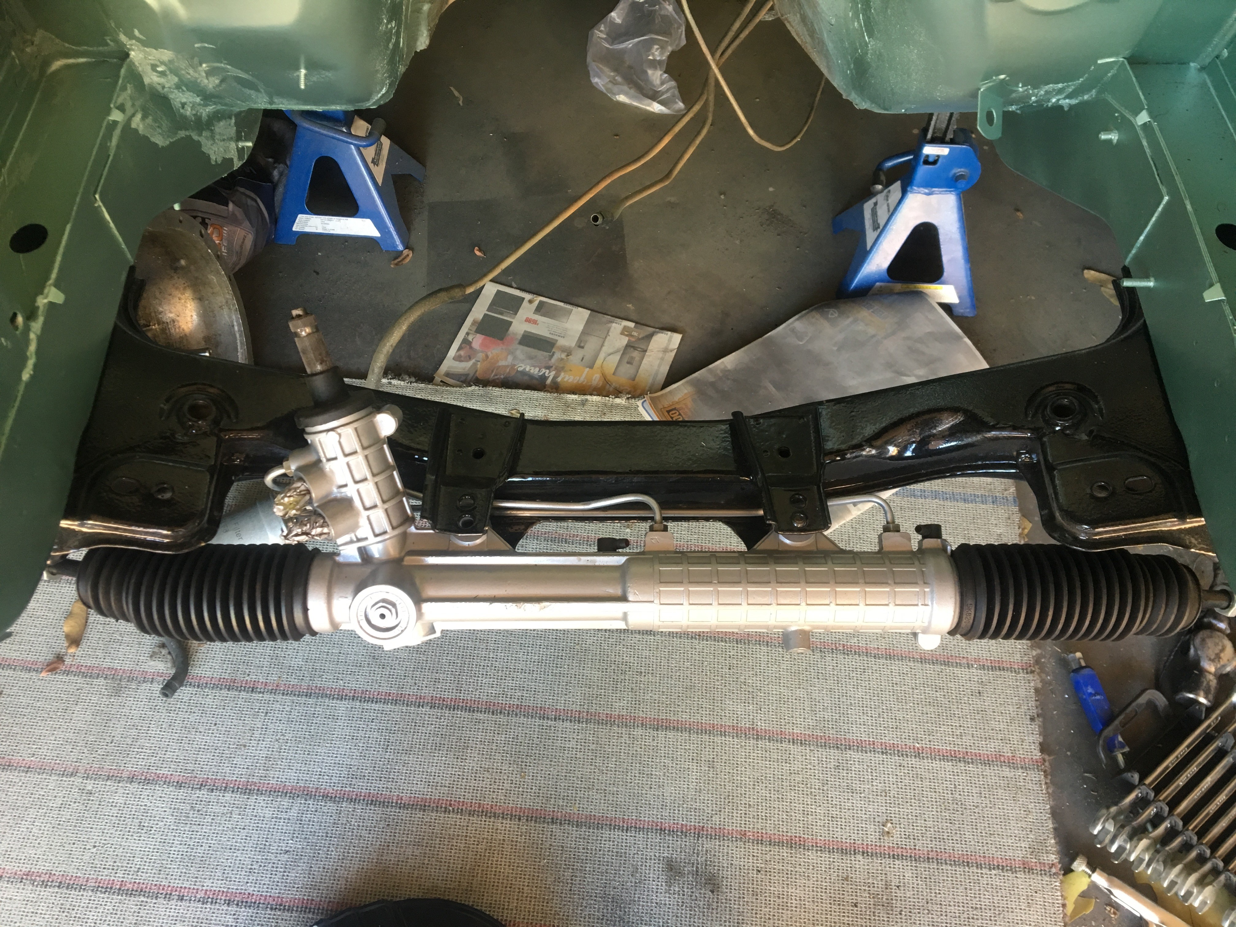

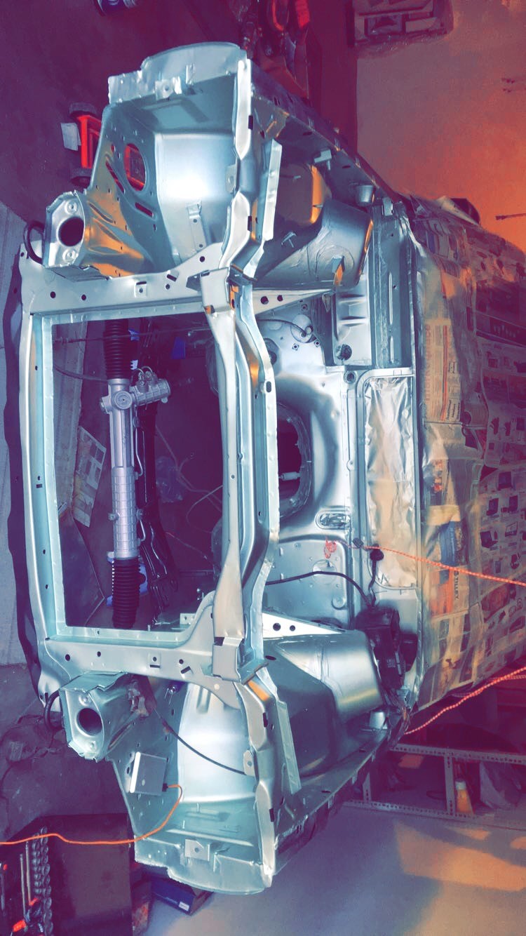

I also picked up and e36 Evo M3 rack. Gave it a full rebuild. Cheaper than you think
Here's the rack sitting in place while I measure for rack spacers

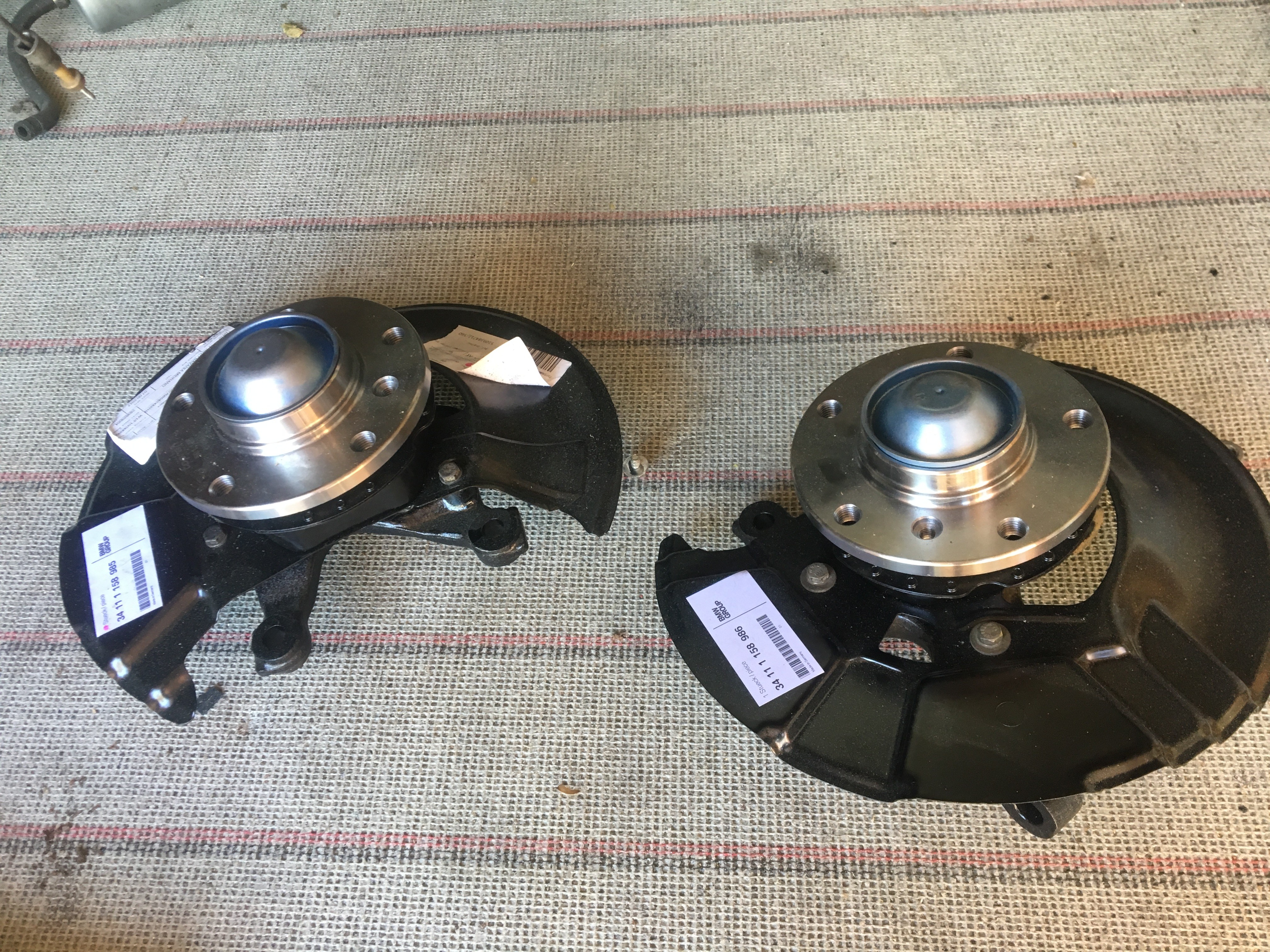

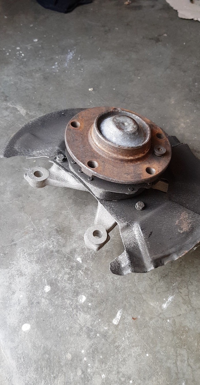

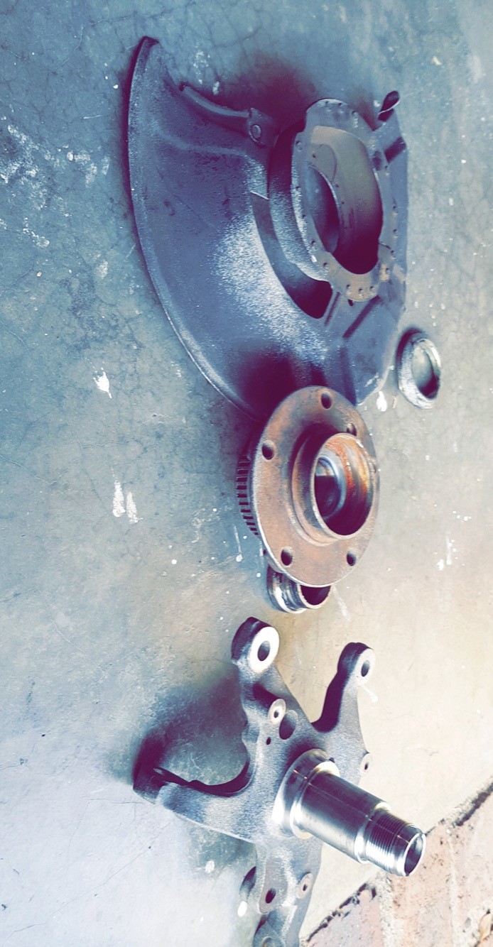

Also picked up some M3 spindles which after a wee spin to bmw, got all parts needed and refurbished.
Sandblasted the bare spindles prior disassembly and then repainted once apart.

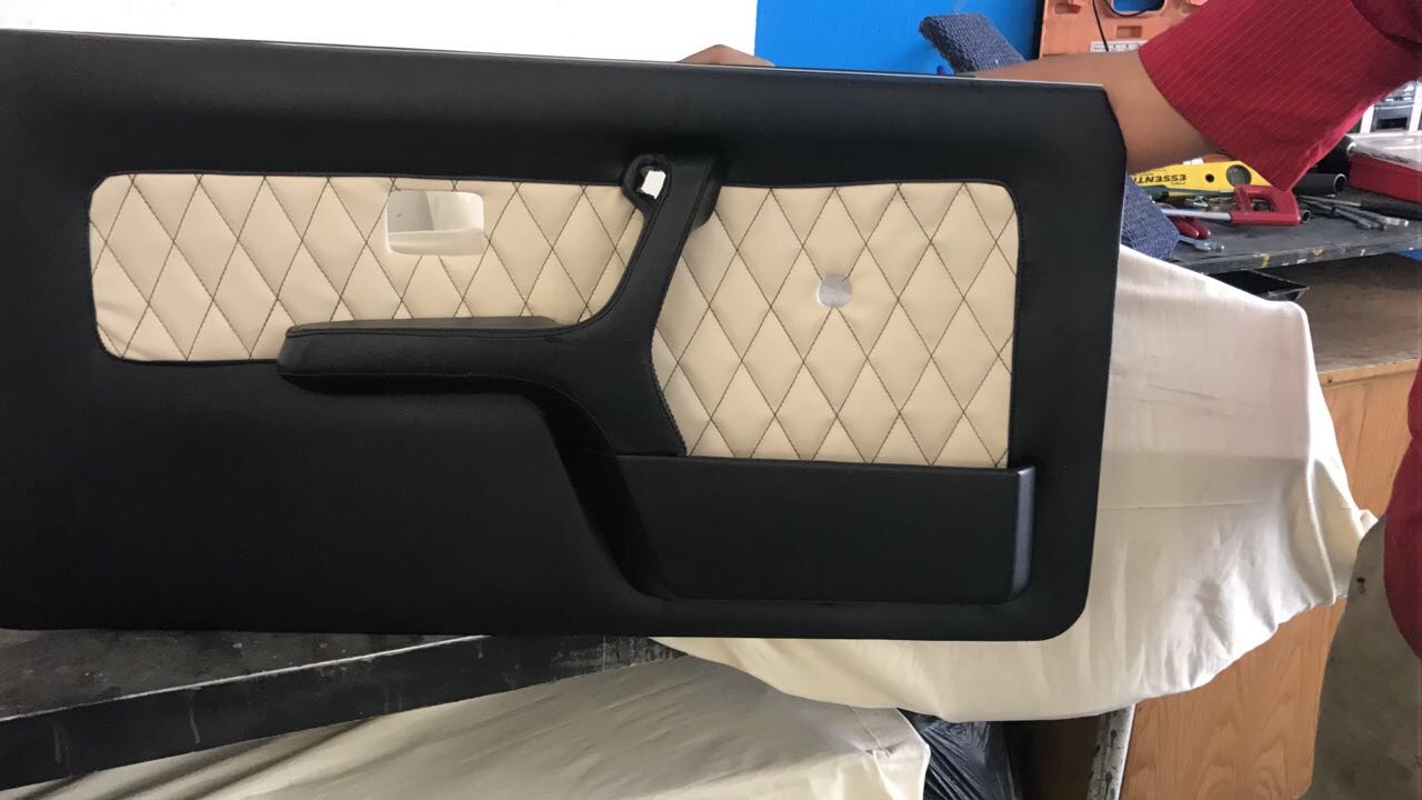

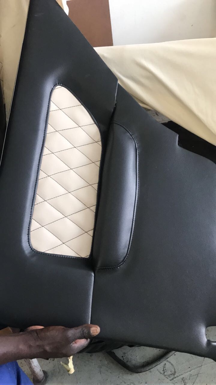

So that's what the last month has consisted of. This morning I received a sneak peak of my interior!
From this point out I'll try document as much as I can! But as you all know. Time begs to differ most of the time!

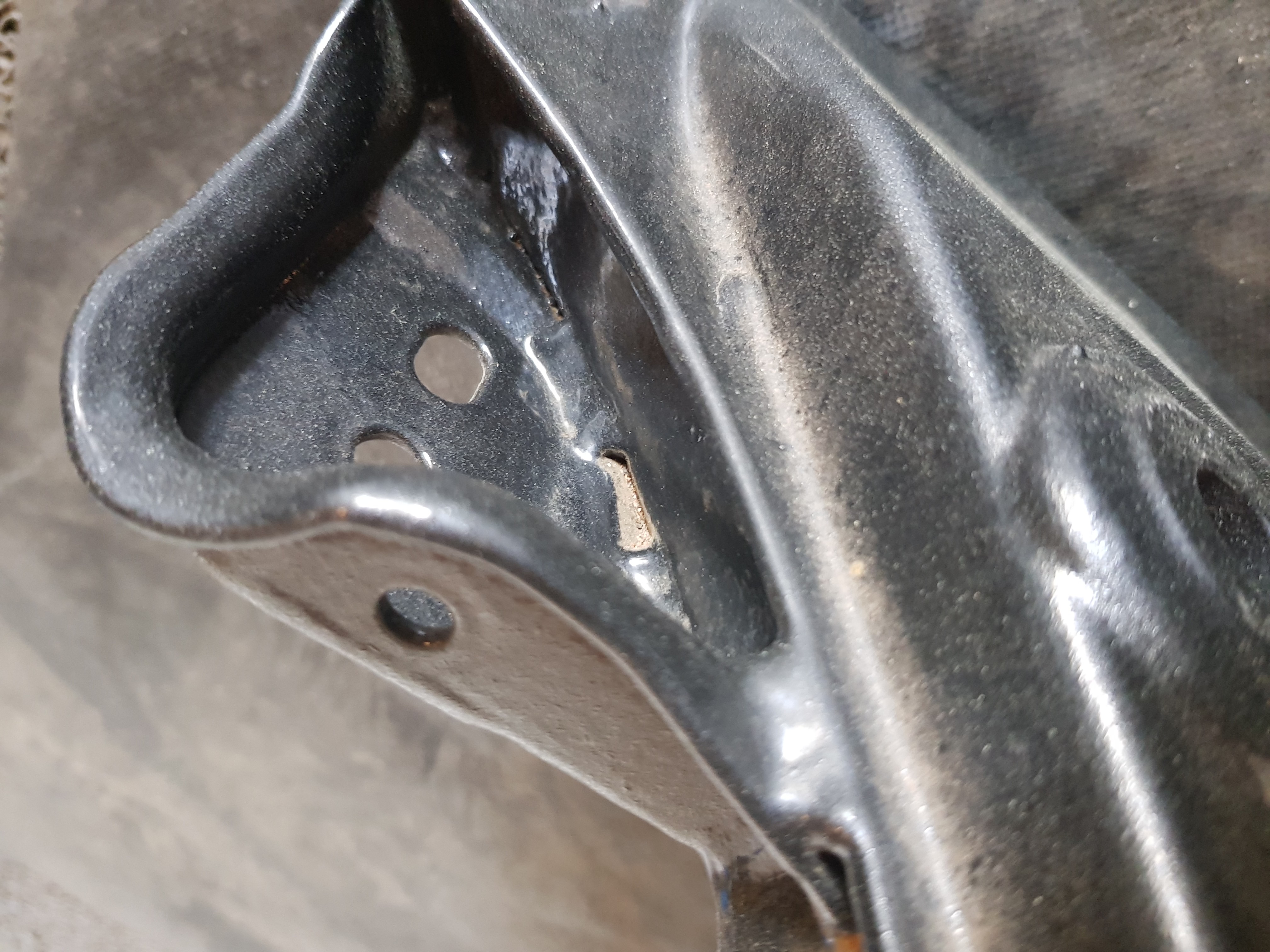

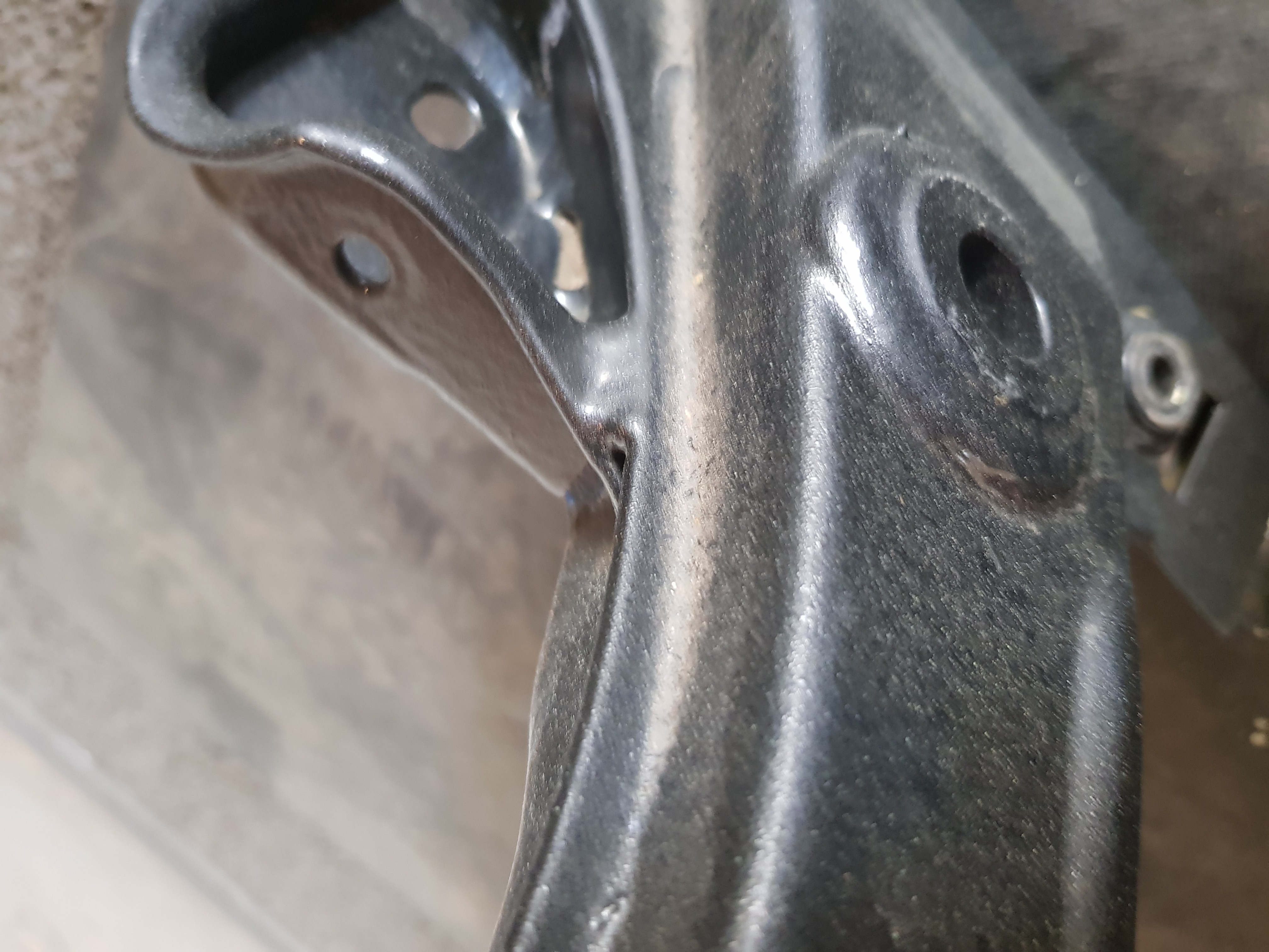

Heres the subframe reinforcing!
Excuse the dust.
Several spots to which i added some extra welding.
