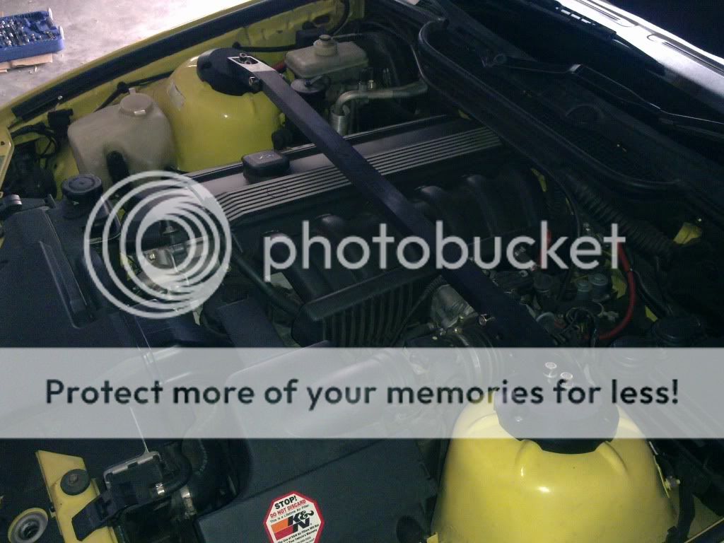

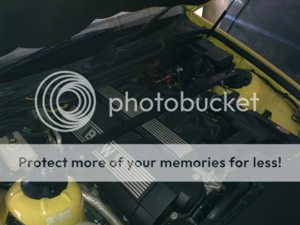

gconry18 said:Pity they don't look as cool as the e46 one. How much did it cost to get it black?
XMAX said::clap:
Great looking brace.
btw - how much of a difference did the strut brace make on your e46.
Id like to get one for my 330D which im taking delivery of tomorrow.
XMAX said:Im not one for hanging the car over the raggedy edge in the corners, but I'd like to know that if I do decide to push it in the corners that I will have better handling with the strut brace than without.
I wonder if etching BMWFanatics.co.za on the brace would be possible, and whether it would affect the structural integrity of the brace. It would be an awesome addition though.
Thanks for the feedback.
What is the cost of the e46 strut brace, as well as the E36 brace. Im considering getting a few for my bros as they like to push their cars in the corners.

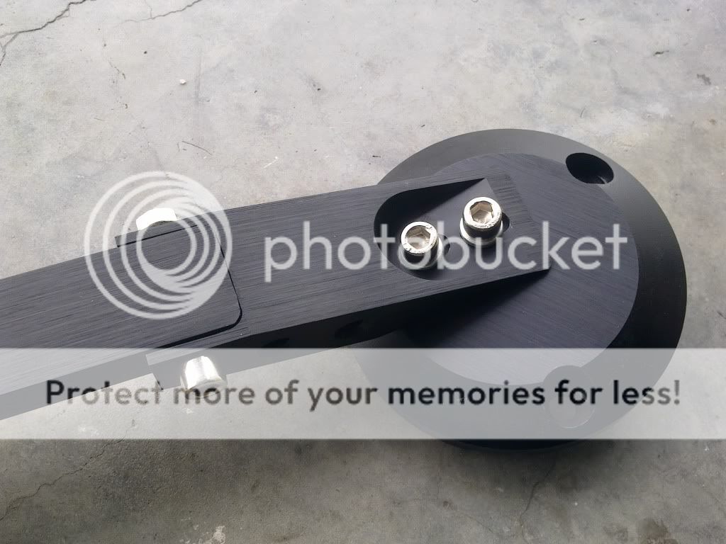

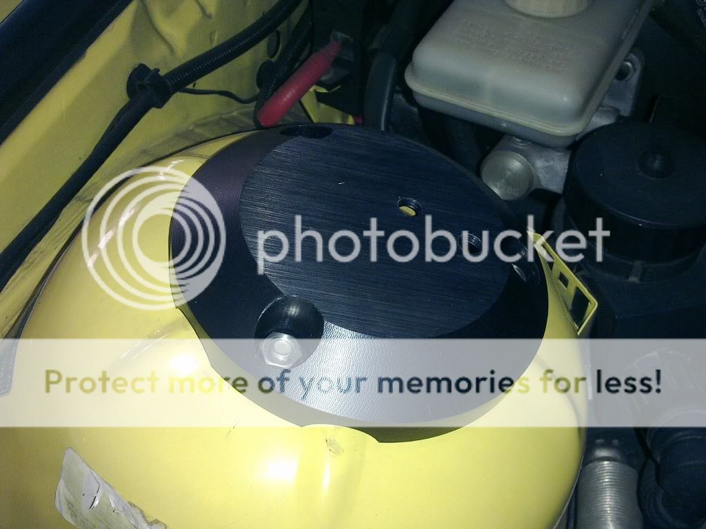

moranor said:free rider did you pre-load it with the slides or just fit it?
moranor said:you jack the car up using the front middle jacking point.
loosen the 2 bolts with the oval wholes then tighten them again...
what this does is when you jack up the car the body will flex slighty making the distance bettween the tops of the towers slighty longer so when you tighten the brace up again and put the car down on the ground again the brace will be pushing the towers apart...
this will give you maximum stiffness from the brace some high end braces have a tensioning bolt you can use to adjust how much pre-load you want...
