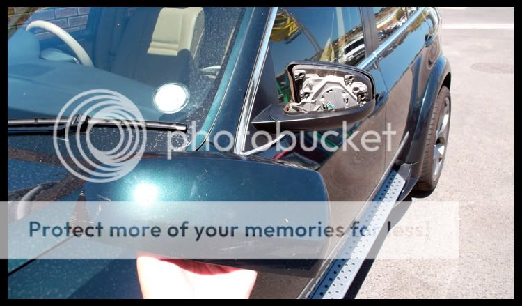

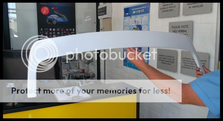

To begin with we removed the mirror covers which were scuffed and had the new spoiler primed for spraying. This will be done today and ready for re-fitting tomorrow.
Another reason for removing the mirror caps is because the Repair Team needed an actual colour sample to work from to match the paint colour and flake finish as close as possible.
Some may have noticed that on almost every car these days that there is a slight shade difference between the paint on a plastic bumper and metal paintwork. The reason for this is because the paint reacts differently to plastic. By matching the spoiler to the plastic paintwork we can offer an almost identical colour match.
The mirror caps themselves are also being resprayed. :thumbs:
The primed spoiler waiting for a fresh lick of paint.

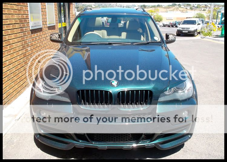

With the car prepped the team mixed up the paint - This was done by taking the BMW colour code for Deep Green Metallic, processing it in the computer and then confirming the right shade by use of small palettes before selecting the final colour mix.
The paint is mixed in a small cup, using a scale which picks up even the tiniest variances in the mix. An overfill of a particular colour and you start all over again.
This particular colour is made up of about 7 different colours, ranging from blue through to black through to adding a hint of pearl.
Finally after much patience and amazement from my side the colour was ready to be sprayed onto the car.
Meanwhile, the kit was primed in preparation for the colour spray.
And so, with the car prepped and primed paintwork finally began with a layer of green applied.
An inspection under a 3M spotlight was then done to check the paint for any running, uneven spray and with everyone happy the clear was then added.
We decided that because of previous experience with spraying the bumper we would allow the clear to dry naturally as apposed to using the IR Lights. The reason being that when the paint on the front bumper dried under IR Light the finish was very wavey and uneven. However when they re-sprayed it and it dried naturally the finish was drastically improved.
The Hamann Kit is fibreglass and even when primed getting a perfect finish is quite a challenge, hence us choosing not to rush the drying process - It seems this was a great move!
How is that finish? No wet-sanding, no polishing yet. Pure spraywork!
