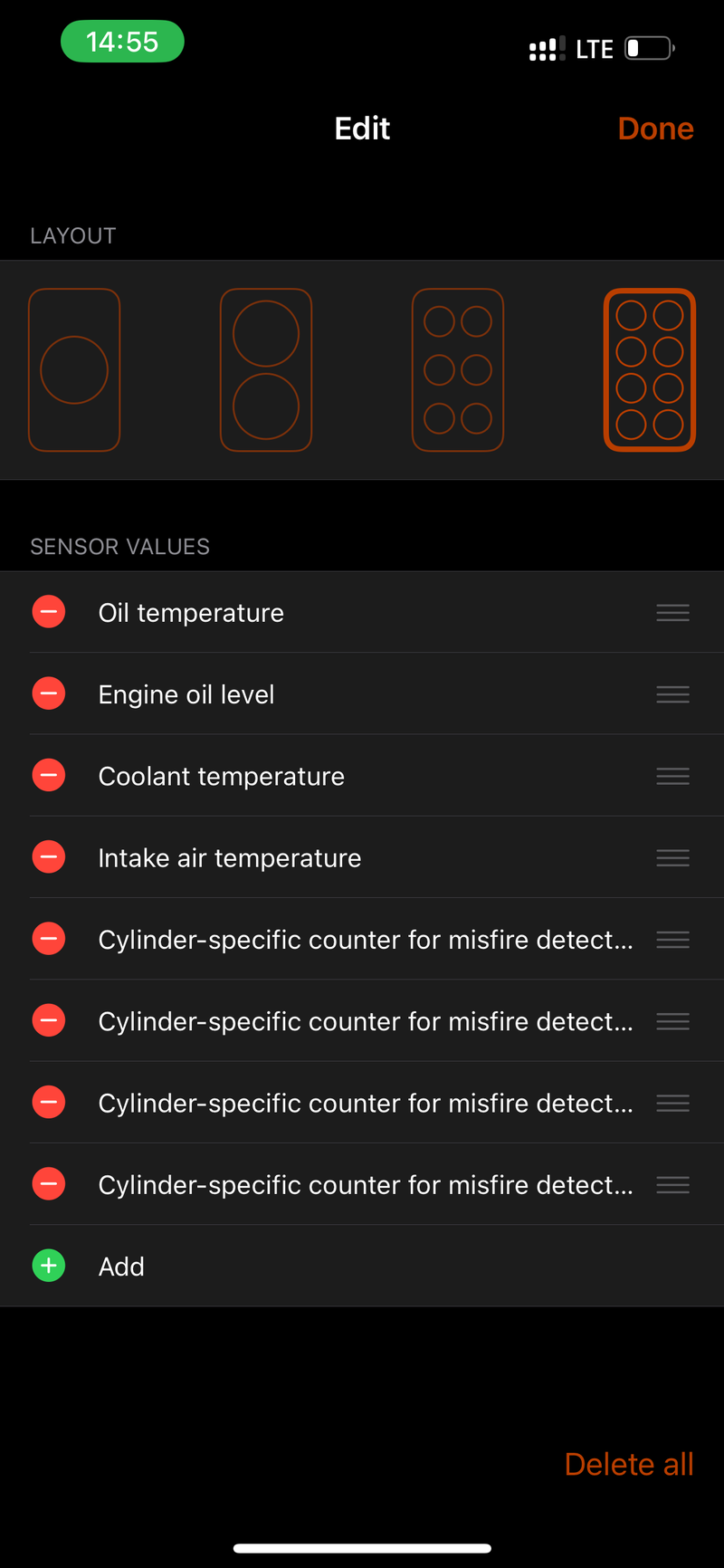

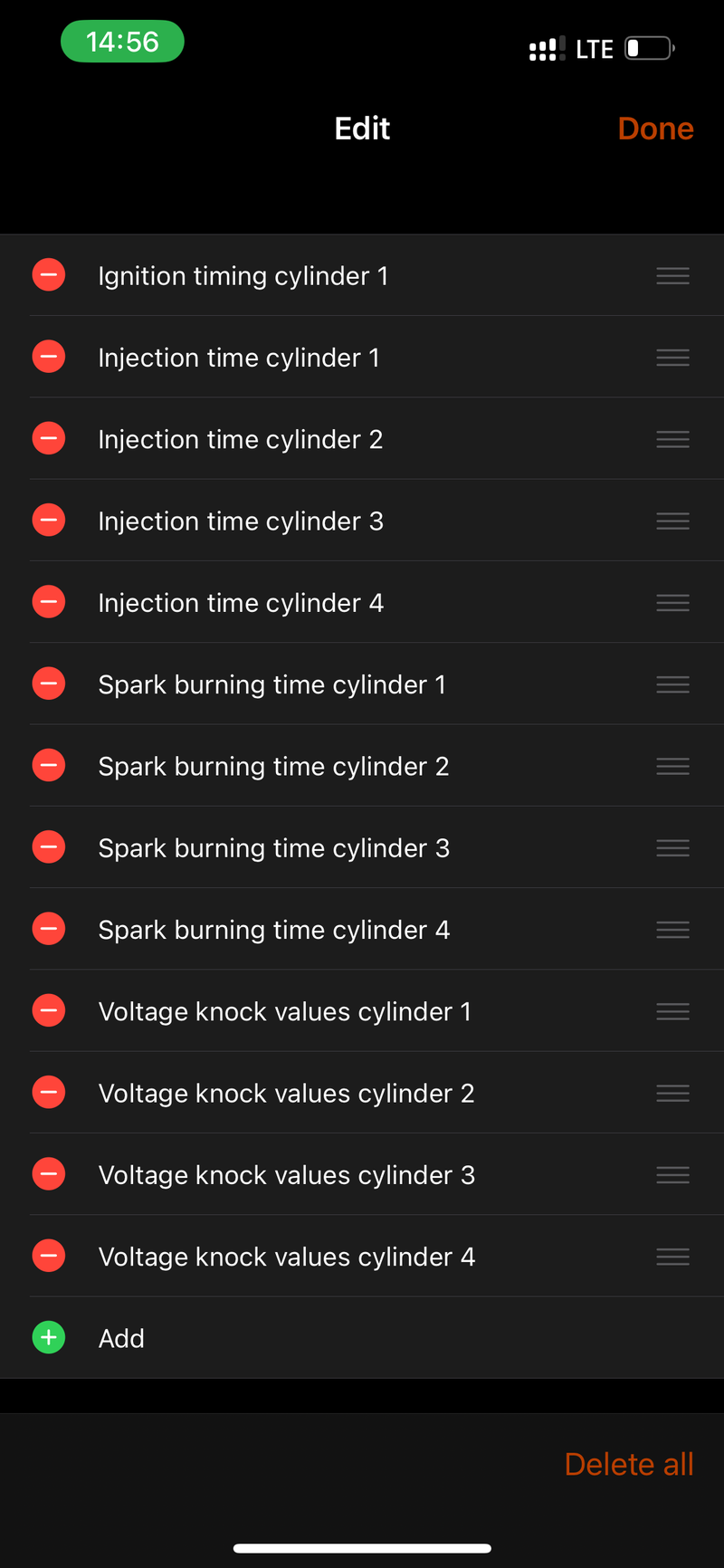

@DarrylvanNiekerk yeah I’m going to try look at all the options I can, because I noticed on Sunday after work when I was on my way home when BimmerLink showed that Cylinder 2 had a misfire, I didn’t notice it while driving though, so it started making me think of fuelling issues or maybe injection issues.
GAVz96
So just to give you guys an idea of the things I’m watching, if it even helps me are on the attached photos.
1st photo is the logs I’m going to look at when I leave work today.
2nd photo is the dashboard
If anyone knows of more important items to look at on BimmerLink please let me know 🙏🏻IMG_8843.png
DarrylvanNiekerk
Eish, trying to find a miss is like searching for a needle in a haystack as it can be so many things.
After my rebuild I had a misfire and it took ages to find the fault.
Good luck.

DarrylvanNiekerk
See if you can watch individual injector durations and check your long term fuel trims, this might help start pointing you in the right direction.
You'll hopefully be able to see if the car is pushing or pulling fuel which will then show if it is tending towards leaning out or running rich on any cylinders.

Hi Guys.
So I did a pull with my BMW in 3rd gear, from about 2k RPM. I did the pull with the above mentioned values being looked at, now it gives me the file .csv format, and I kind of understand the table, I should’ve probably put the RPM range in as well. But I’ll attach the file if anyone would be keen on helping me understand a bit more of the info going on there 😅
What I did notice was the Ignition Timing on all 4 cylinders picked up and then all of a sudden dropped a bit.
Thanks in advance 🙏🏻

Spanky
Adding RPM would be helpful.
Also, one can easily import the comma-delimited csv data into MS Excel (or similar) for a more human-readable experience.
