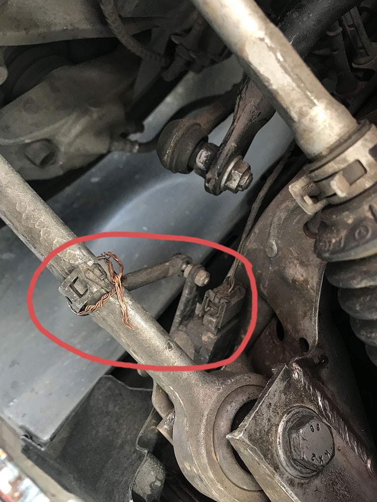

I decided I am not going to hide anything I find on this Z4 cause I am fixing it all anyways.
This is the reason my xenon headlights were facing the ground. :smashScreen:
I actually have no words for seeing something like this on a Z4 35i This is a premium car that sold for almost a bar brand new. To see stuff like this actually kills my soul. Never mind the stuffed up exhaust...To see my headlight auto adjuster sensor held in place with a shoddy mangled piece of copper wire really makes me question things about this car.
This was a shock to my system to say the least.

That is shocking!
PLV
:RedNo: That's crazy man... :thumbdo:
For your sake I hope there isn't too much more you find like that.
Was it you I passed on the weekend close to Monte (between Crawford and Monte)? Was also a black on black Z4 that looked absolutely beautiful.... *** Obviously couldn't have been you - as you are effectively engineless!!! My bad ***
Best of luck again man. Sending you some good Karma. Can't believe all the sh*t you've had to sort out so far...

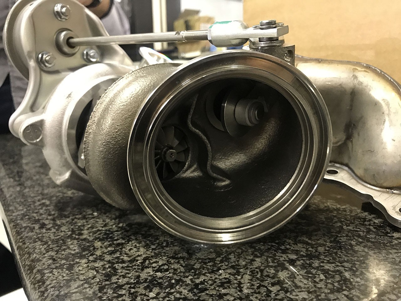

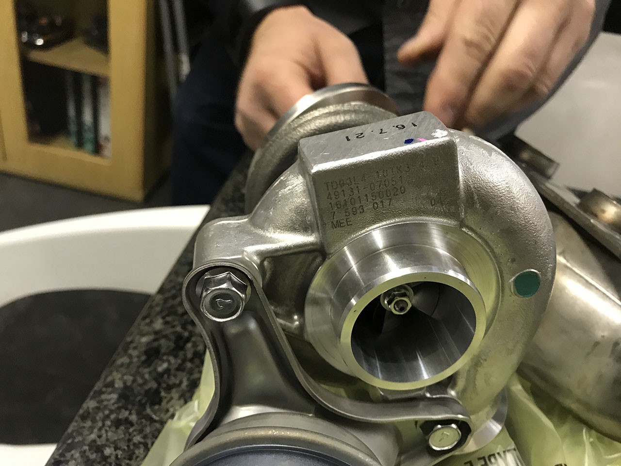

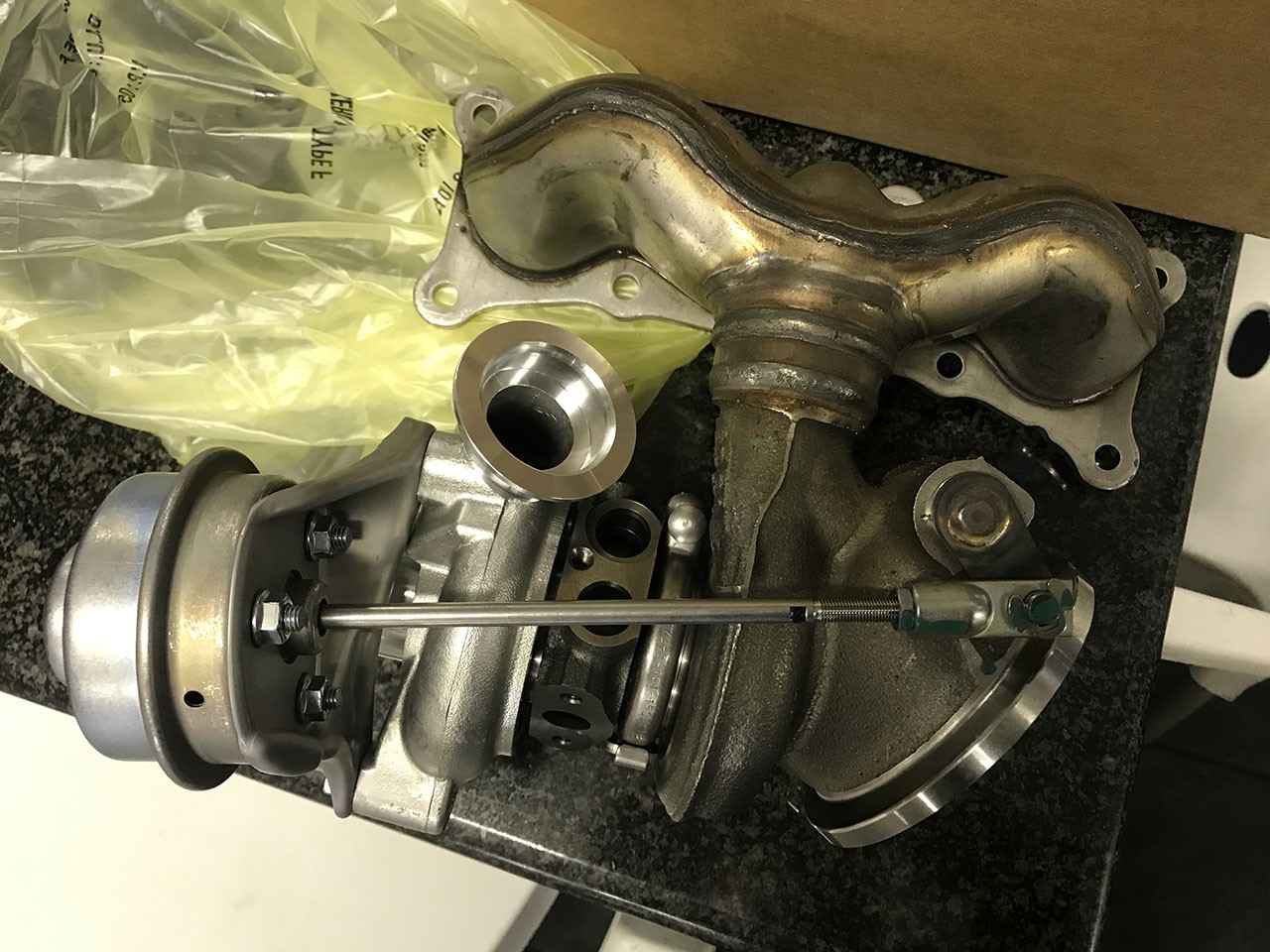

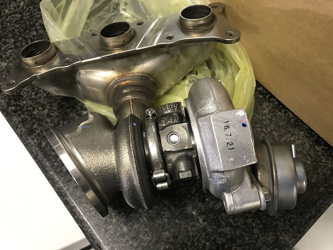

I received the "New" turbos this morning from BMW and dropped them off with my Mechanic. Definitely look refurbished to me but at least they come with a 2 year warranty from BMW.
Here are some photos:
