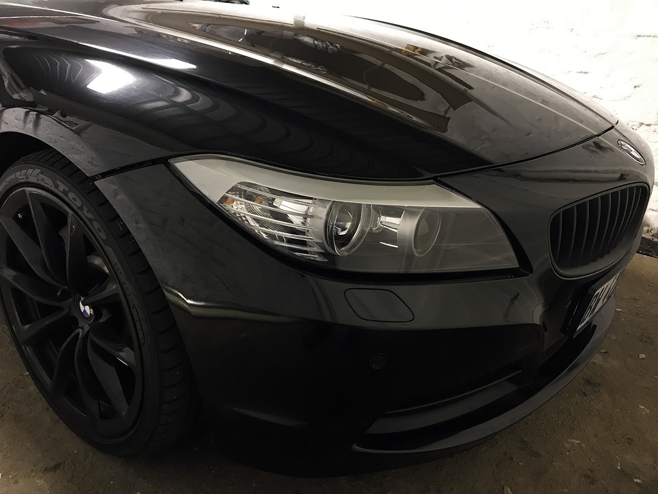

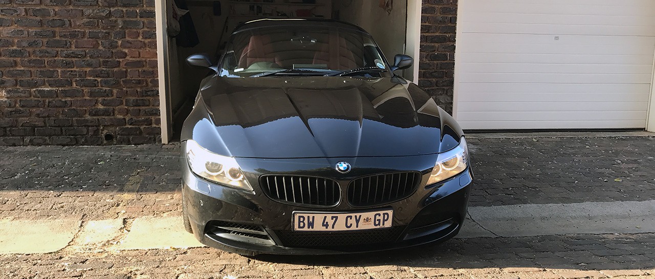

I had a look at these and have done this on other bmw's that I owned in the past, I have broken a few by adjusting too far because the auto adjusters are pointing down to the ground and I tried to compensate with the manual adjustment and ended up breaking the plastic screw
I read online that these specific E89 xenons have a manual screw for fine tuning only :-/ I read a forum that I will post a link on now regarding this matter. Usually this auto adjuster sensor servo arm link twirls around backwards when the car bottoms out or hits a pothole etc and you get the dreaded lights facing the ground situation.
http://e89.zpost.com/forums/showthread.php?t=418453

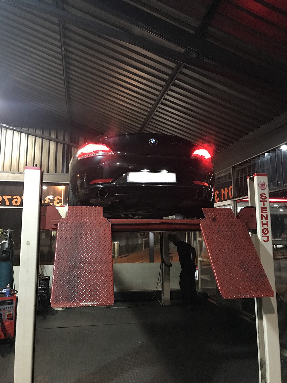

The car is going into powerflow just now to get some silencers put where the cats used to be so while its on the lift I will have a look at the front sensor and see if the arm is not flipped or the plug to the sensor hasn't jumped out.
