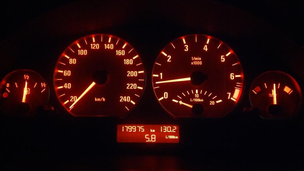

Took a drive on the highway yesterday to drop off some parts at uncle Peter. Reset the lt/100km when I got on the highway by Swartkoppies in Alberton, set the cruise control to 129km/h and cruised the whole way to William Nicol drive Bryanston, took this photo as I got off the highway.
Who needs a diesel?:rollsmile:
I did exactly the same with my silver 330i when I once went to Vereeniging from Pretoria. Reset when getting on the highway and just glide along.
This was the result:
WIDEOPN-X5

I have heard it said that a station wagon is a more efficient shape from an aerodynamic point of view....is this the proof of that??:rollsmile:
Fordkoppie
This touring is still running 2.5 MAF and software, so I think that is mostly why there is a difference.
a flat rear end is not aerodynamic at all

I haven't went below 10.6l on my E46 330i, Even at driving 100km with cruise control on, How the hell do url do that! Lol
Does software really make a big difference on fuel economy?
I currently got an exhaust and decat, however even before that with the cats on and the std exhaust, I couldn't go below 10l/100km
KPM3_30
Moderator
IIRC, you have an automatic? These engines with that gearbox isn't the most frugal combination.
The figures above are manual cars. I did 6.5l/100km on a trip from JHB to DBN with my 5 speed manual, this was with some hard acceleration as well :rollsmile:
