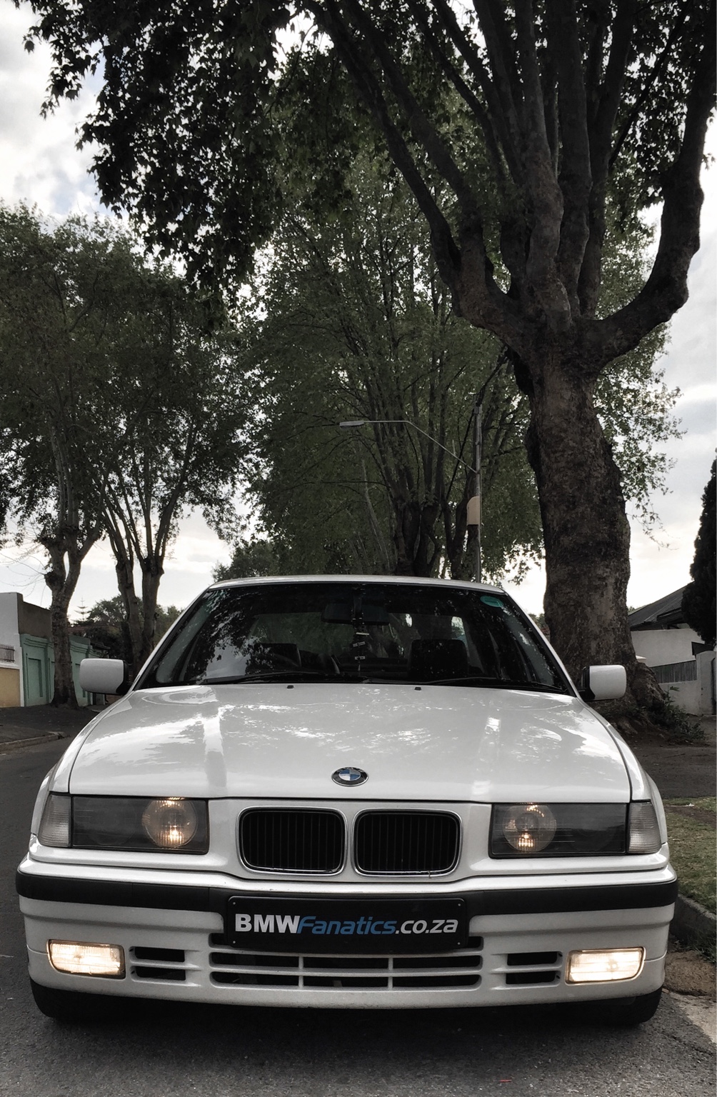

Since day one, the left fog never worked. Replaced the globe, no go. Today, I managed to find the fault. Earth cable was broken inside the insulation. Snip and seal, sorted!
Park lights and fogs on to me, is a BMW Signature!
