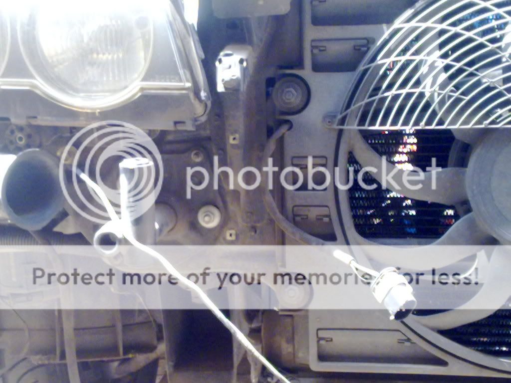

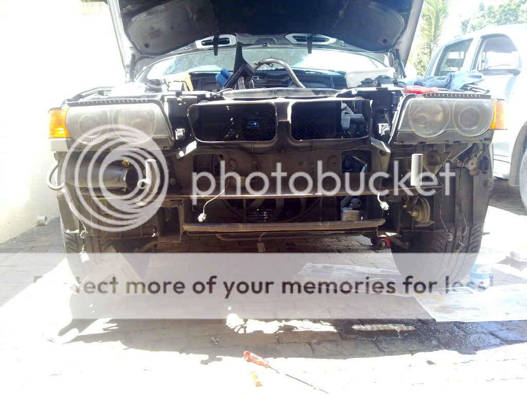

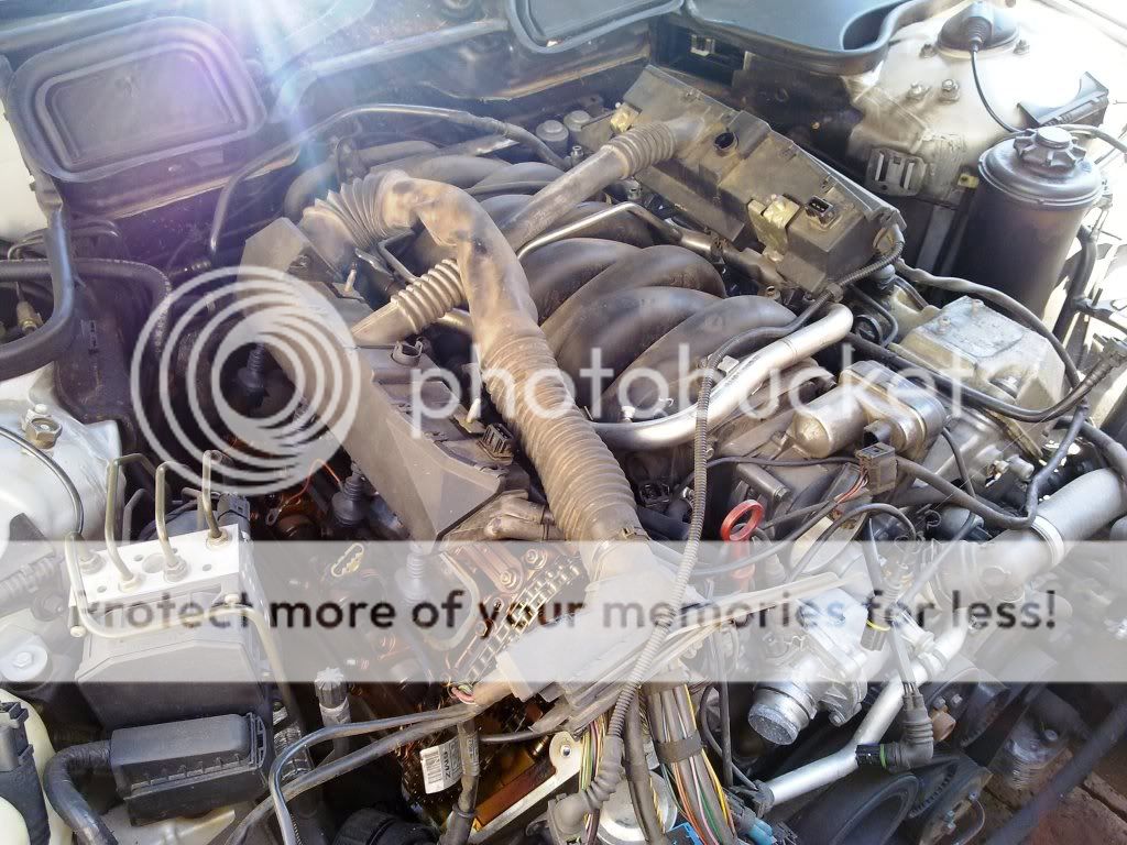

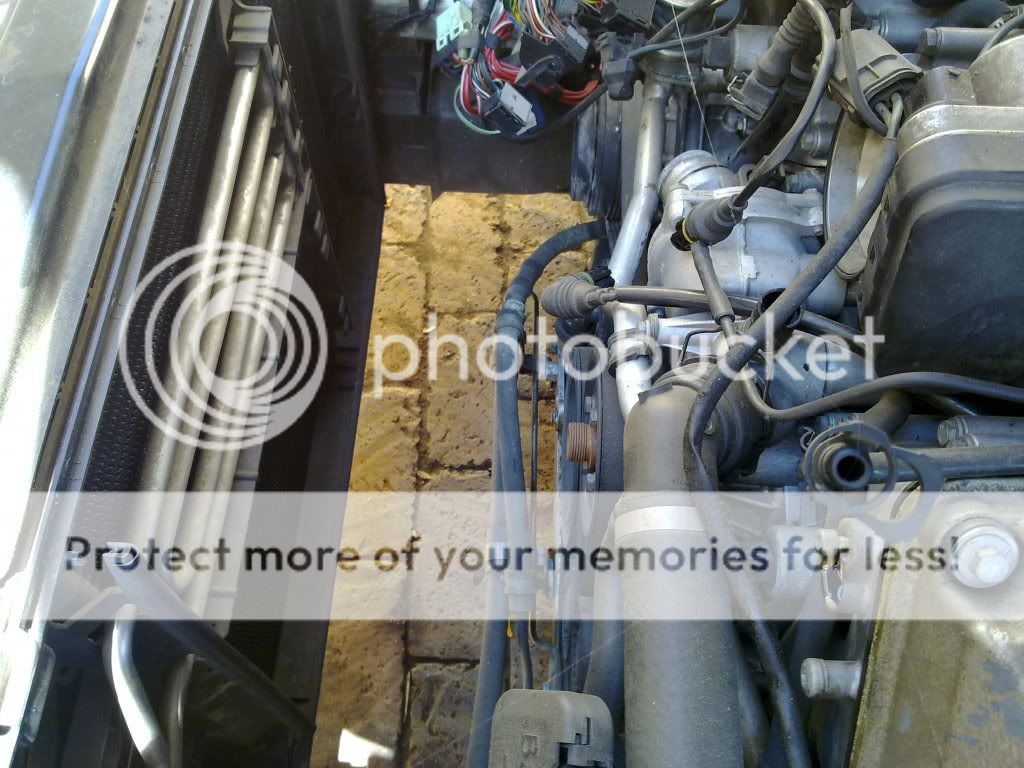

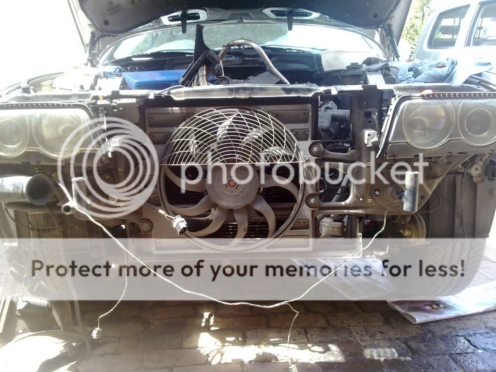

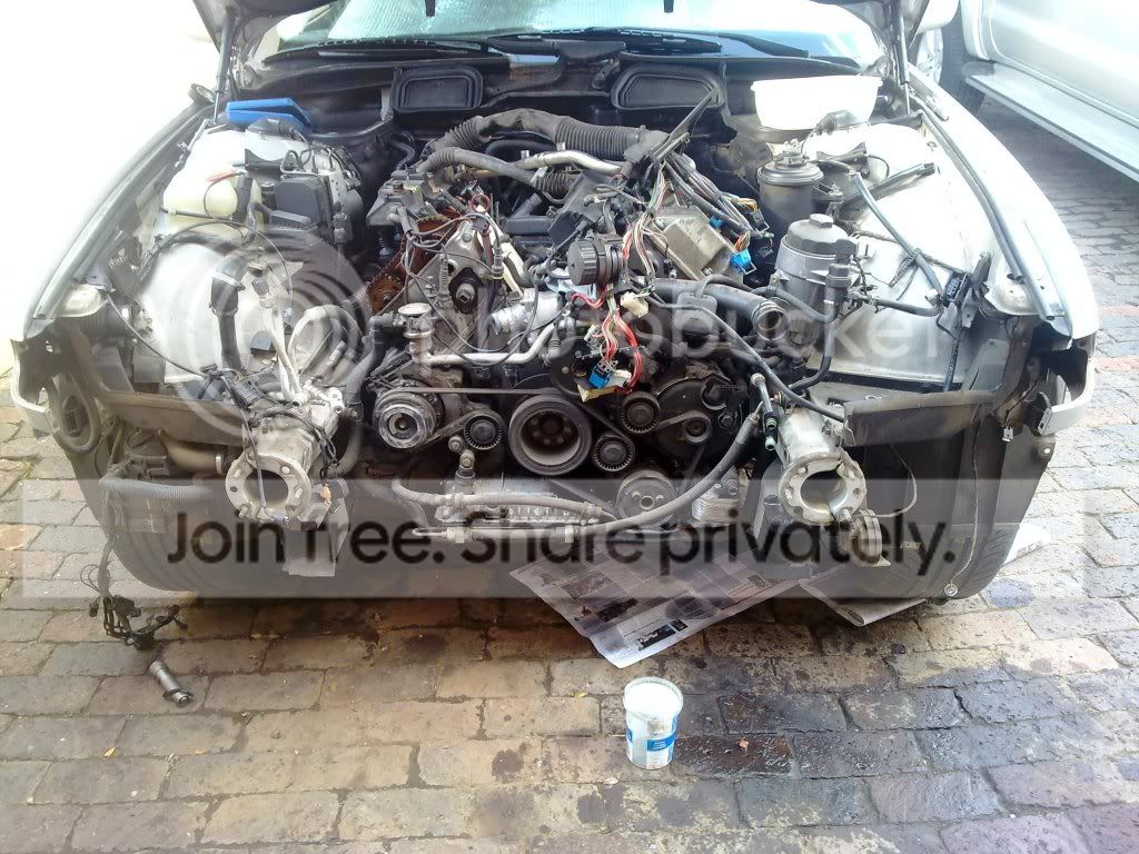

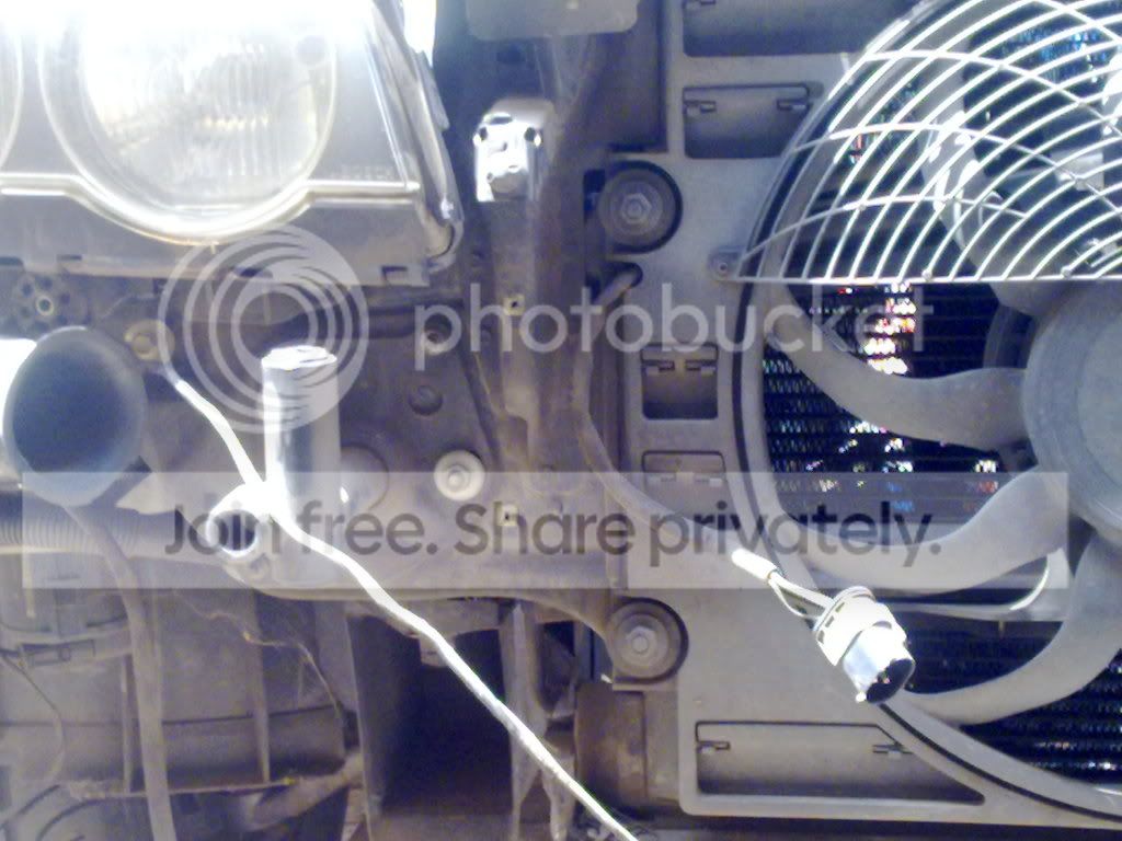

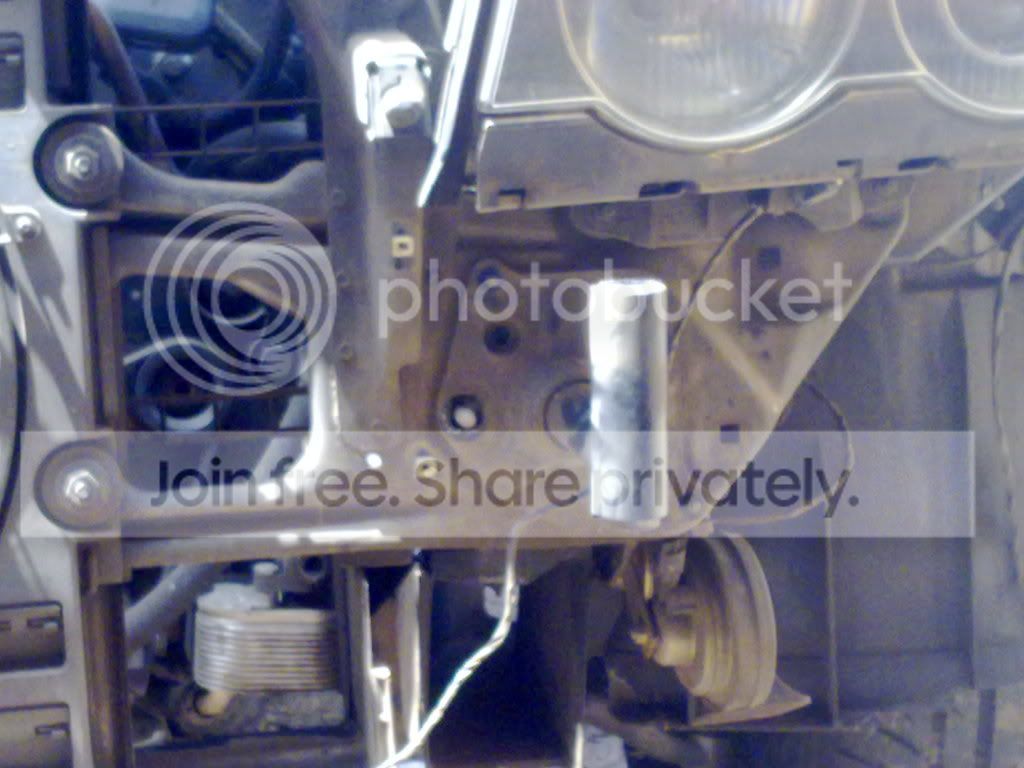

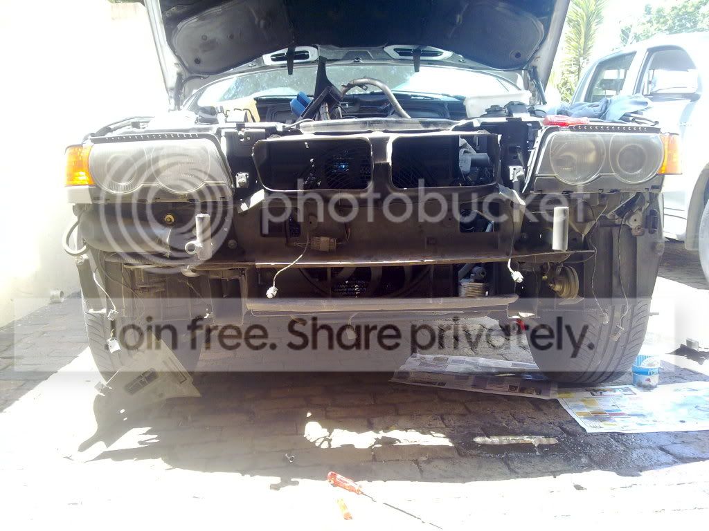

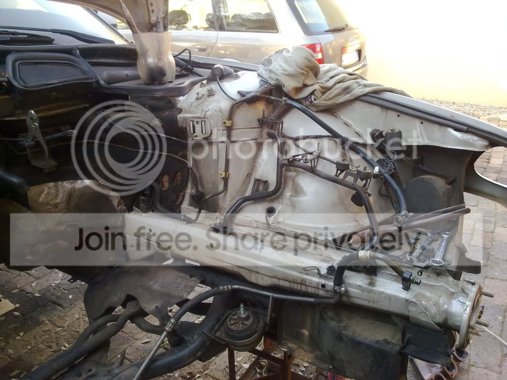

Front bumper removed. If anyone wants to know how please ask.

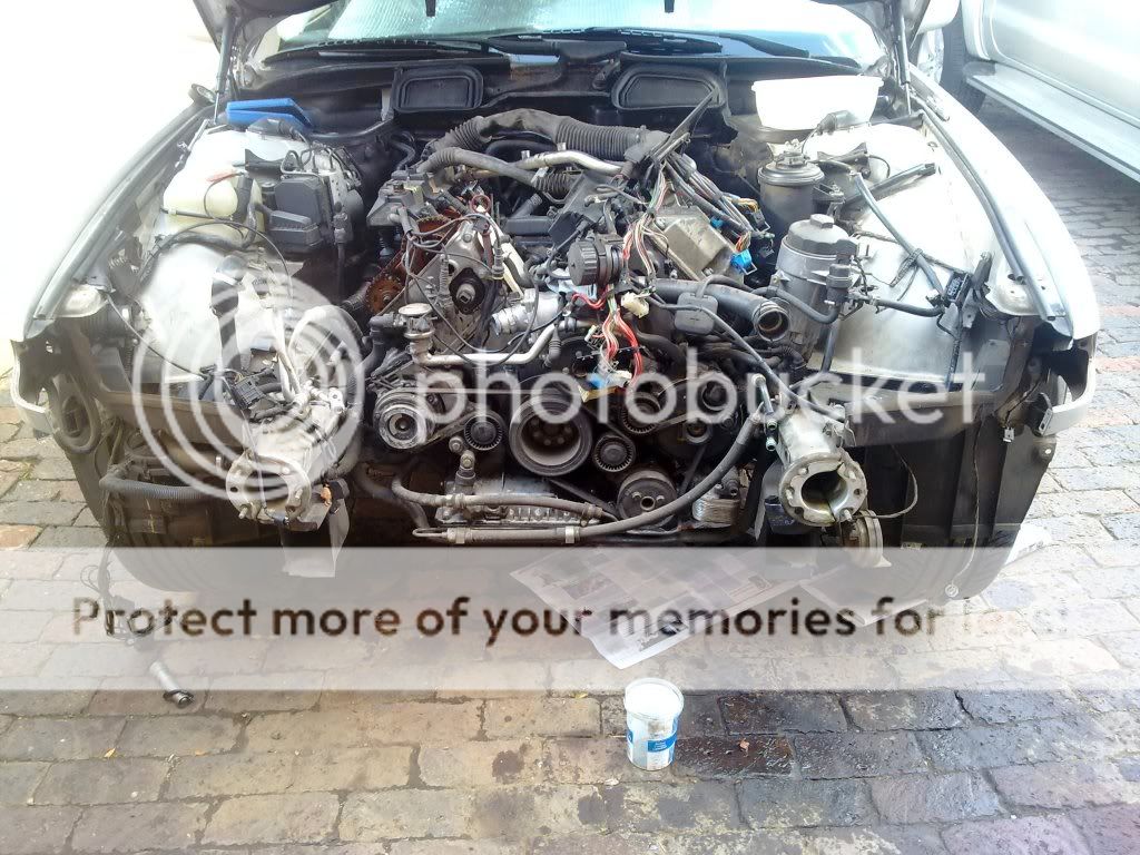

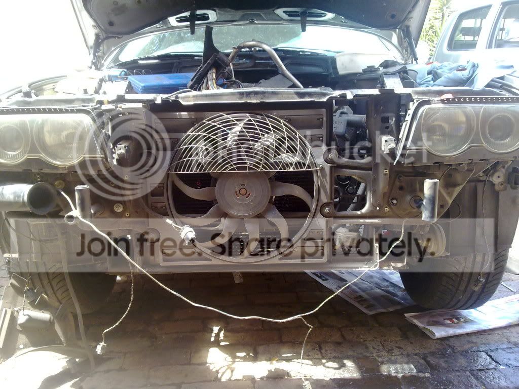

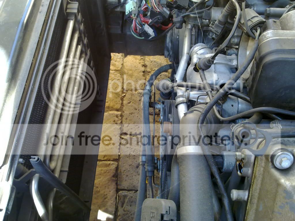

Radiator removed along with a few other things
Engine harness disconnected from control boxes. That is a most simple procedure as everything is either plug specific or terminal specific so you cannot go wrong in just unplugging things.

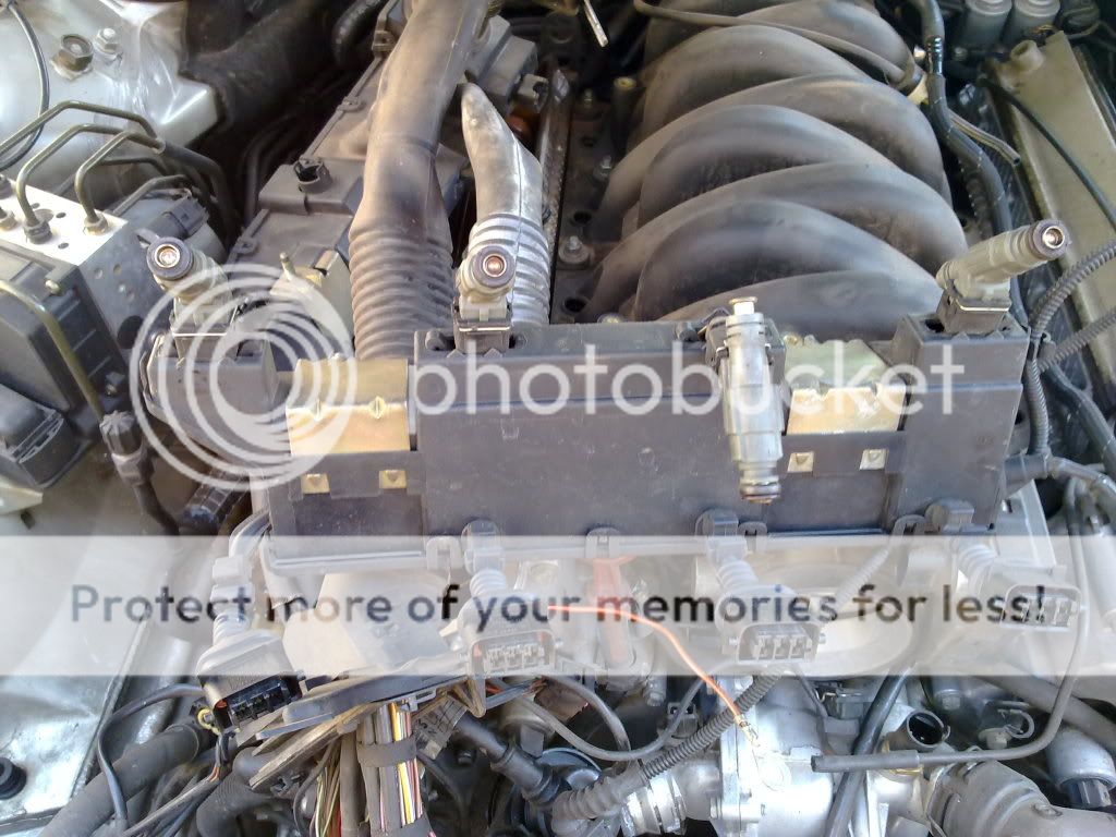

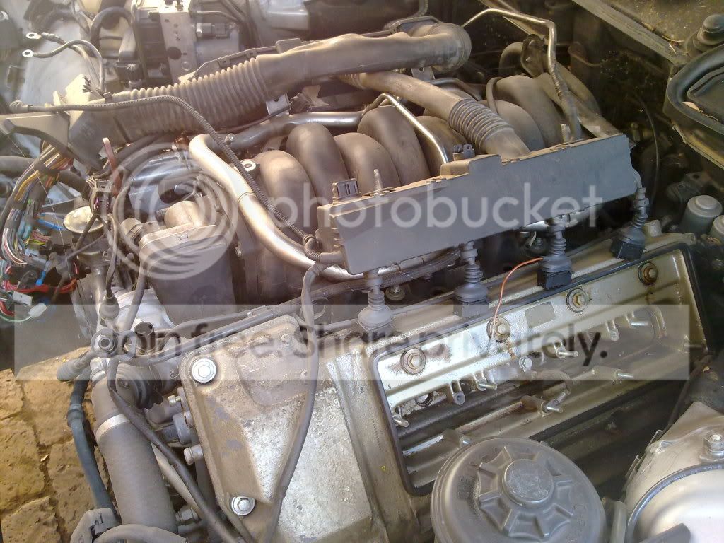

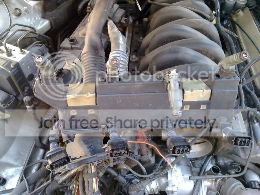

I removed the fuel rail from the Injectors as it is a lot easier to do then to remove the injector plugs first and then remove the fuel rail with the injectors attached.

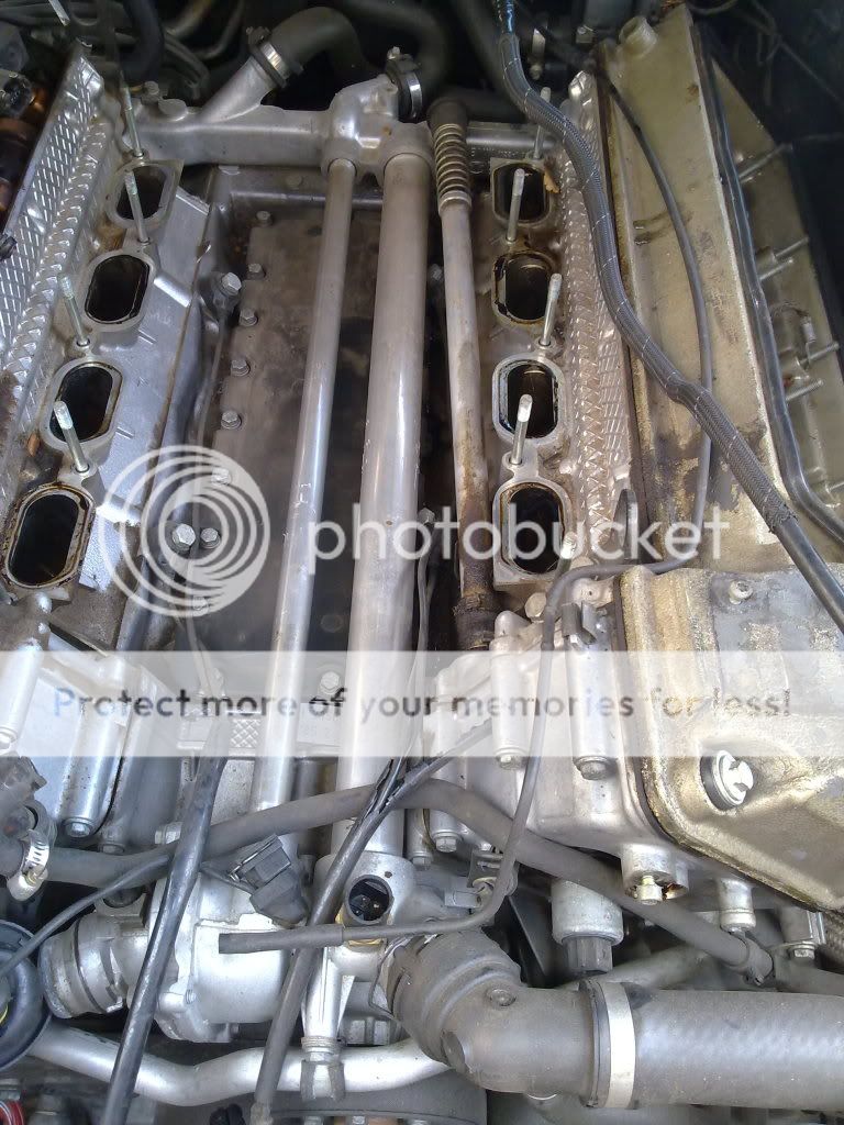

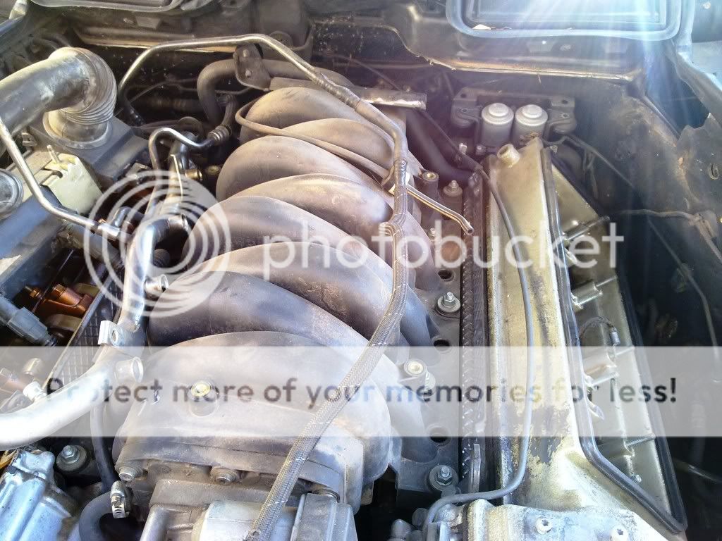

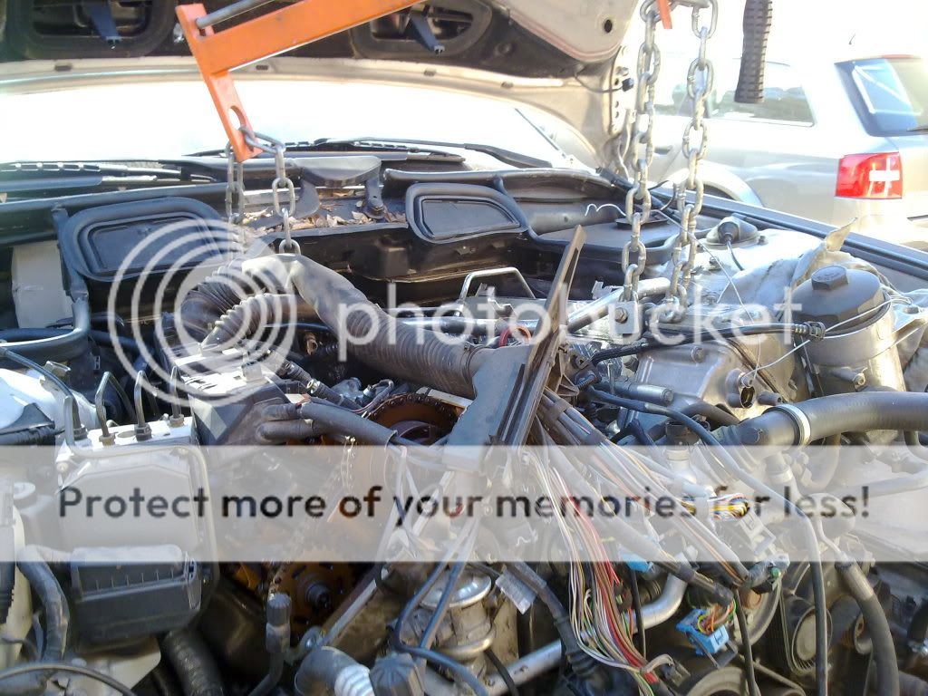

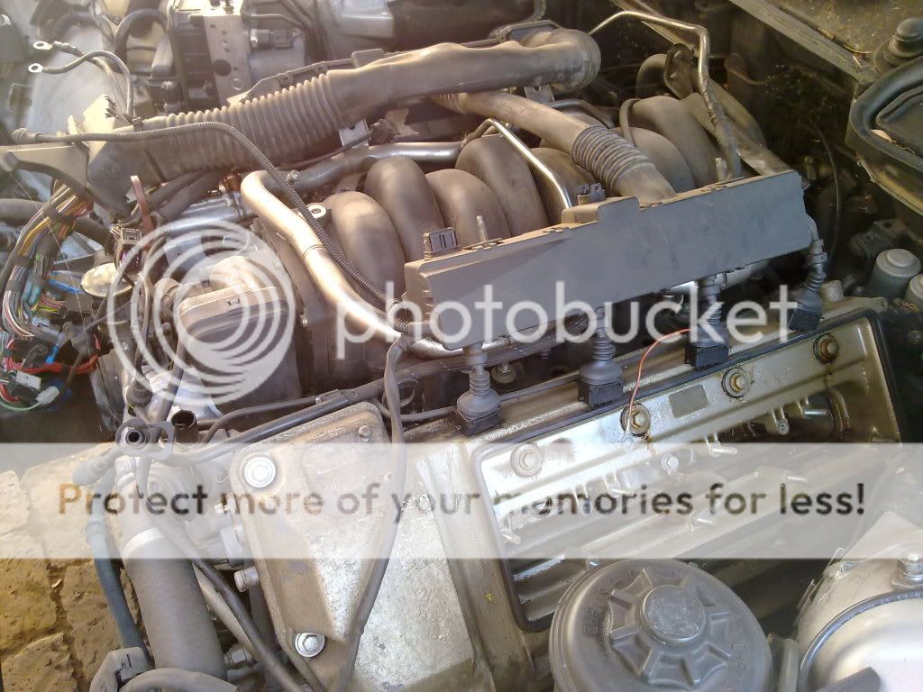

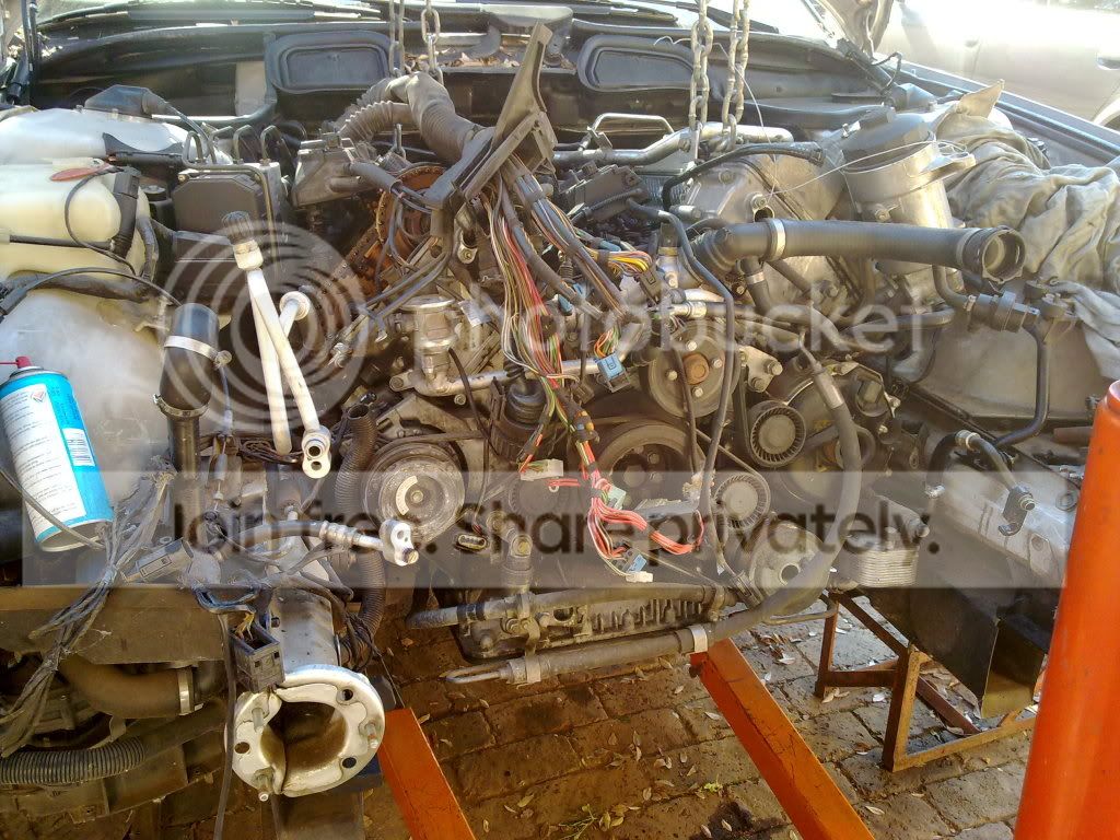

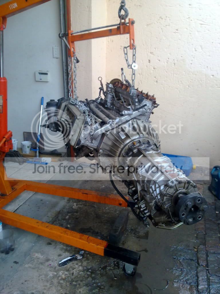

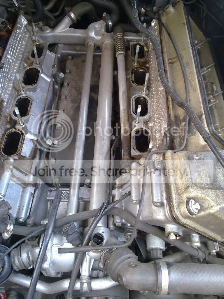

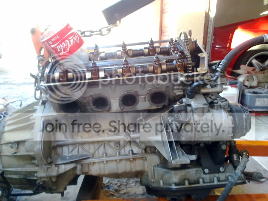

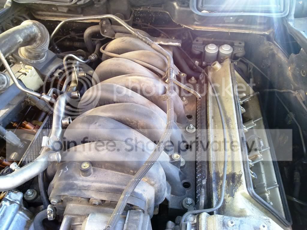

I first removed the inlet manifold as I did not want the lifting chains to crunch against it. I was not sure if I would have enough clearance as my levelling bar is quite short.

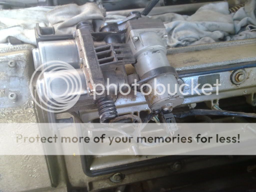

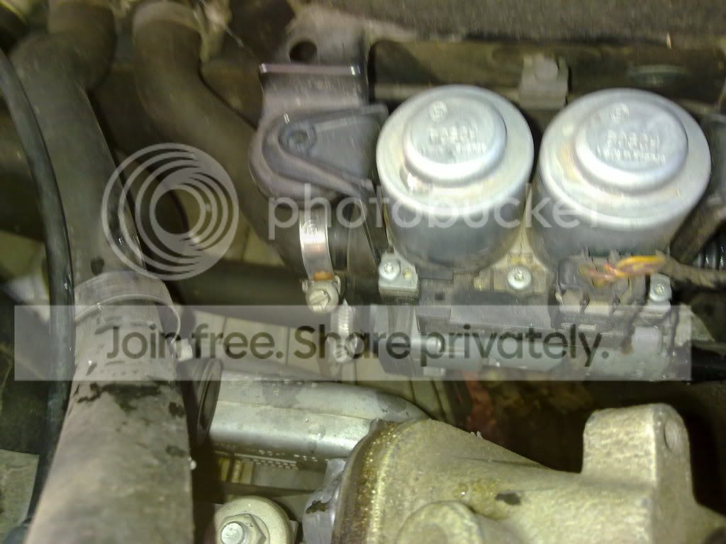

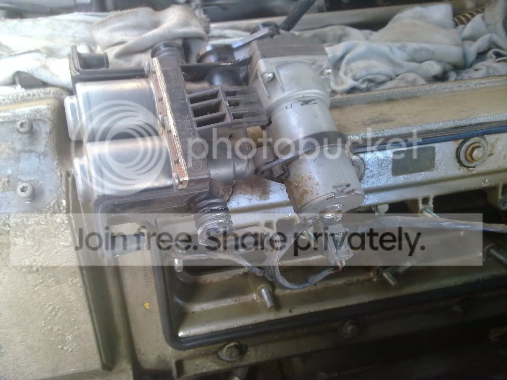

The famous heater valve system which last was priced at R2800 when I changed mine.
At that price I was not going to just ignore it so here is a pic of my R2800 heater control valve.
Ermmm did I mention that the valve is R2800?
9 456 780 Nm, that sounds about right :thumbs: :biglol:

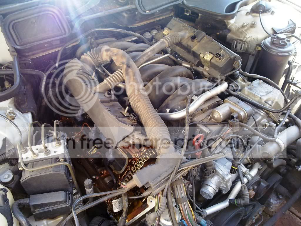

Front main oil seal looks as though it is sweating.
Please remember BMWs do not leak.....they sweat :D

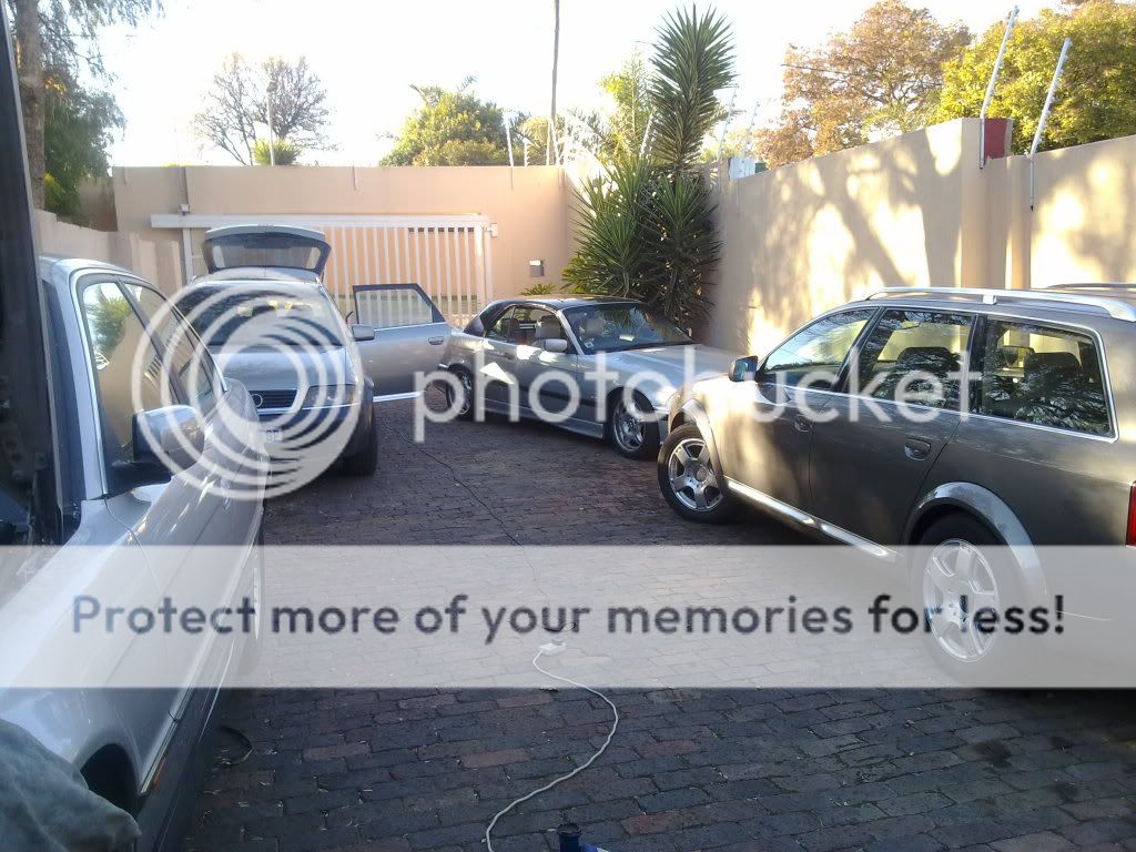

This is a pic of "Pearl Harbour"
The silver Allroad is mine The brown Allroad is Chesters although Chester is known to commandeer the silver Allroad on the odd occasion and the silver e36 belongs to my son Alexander.

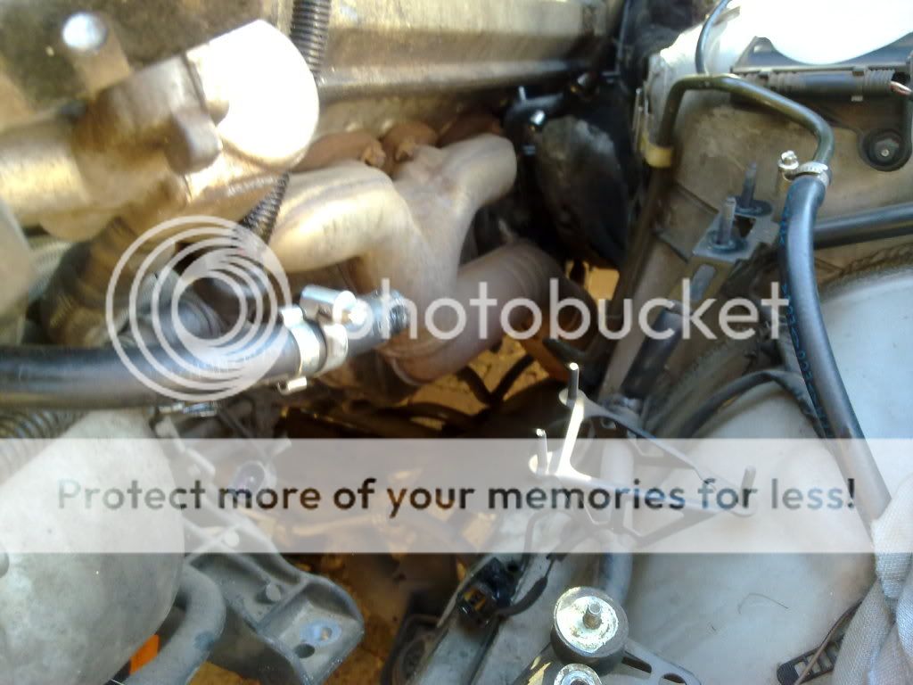

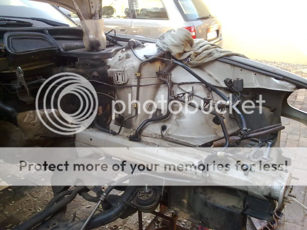

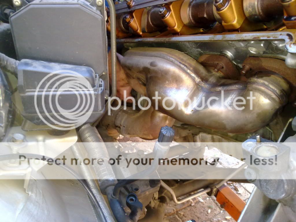

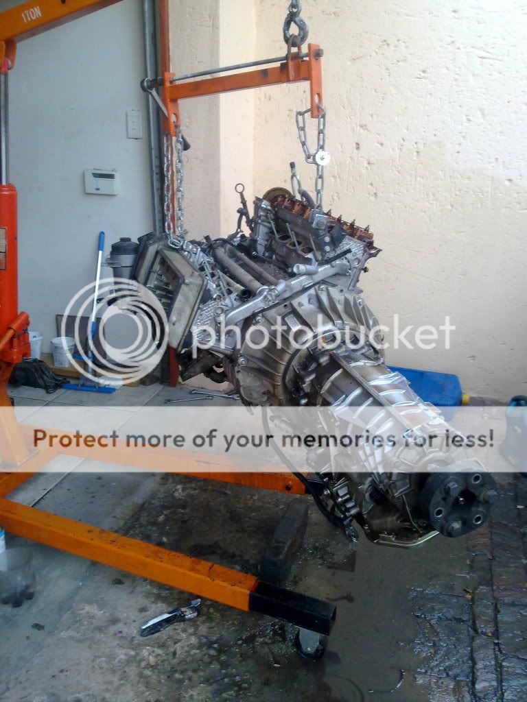

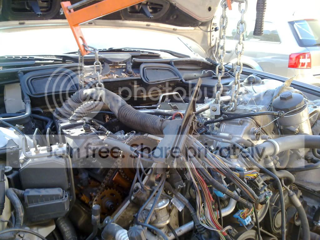

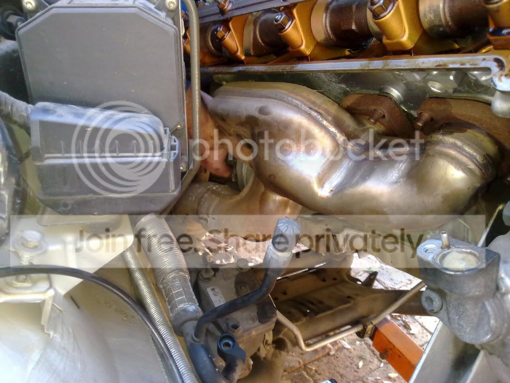

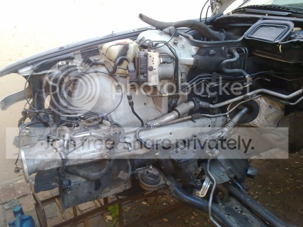

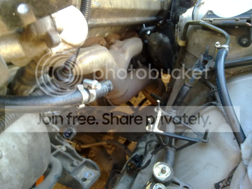

Highly recommend that the right hand side exhaust manifold is removed just about here or it will foul against the steering box. You will have noticed in the previous pic that the bonnet is raised to a 90 degree position. The bonnet brackets are drilled and tapped so as to allow a bolt to be inserted and fastened that way there is no danger of it flipping backwards on the screen or on your head.
Compare the left hand clearance to the pic before.

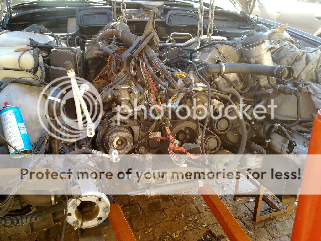

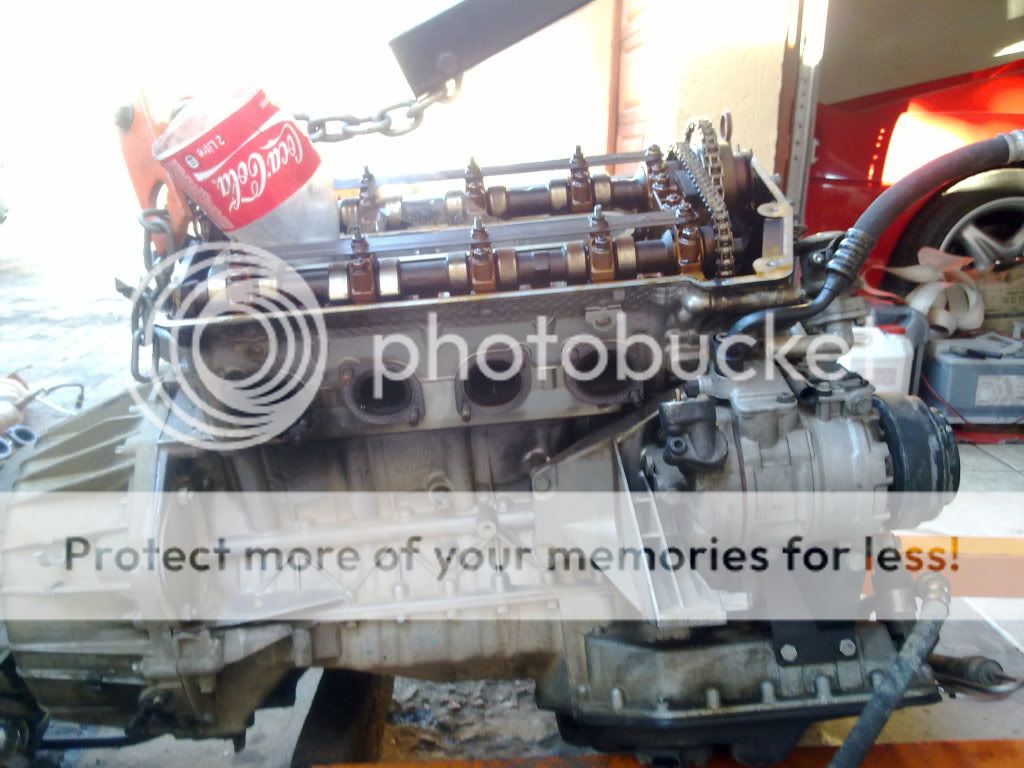

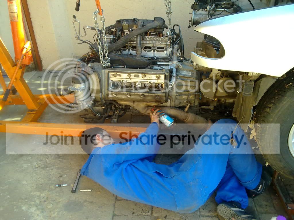

Out the engine bay and having some Q10 sprayed on the exhaust manifold nuts Leonard did you hear what I said? NUTS :rollsmile:

For our experts can you see anything strange on the colouration of the exhausts? Right bank no4 looks peculiar to me with what almost looks like blow by but it is not.
Left hand engine mounting broken.
I shall need to replace both now so if anyone has any ideas on how I can save some money I am all ears.

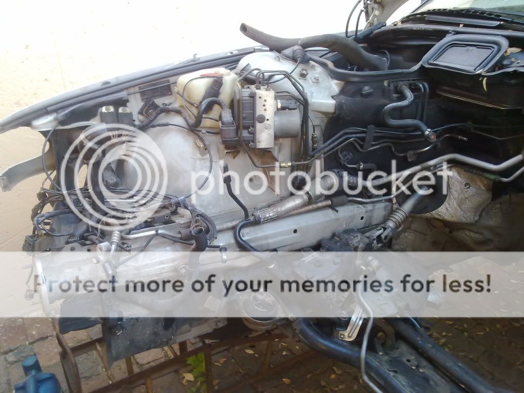

Right hand of engine bay you can see the steering box is huge and it interferes with the pre cat.

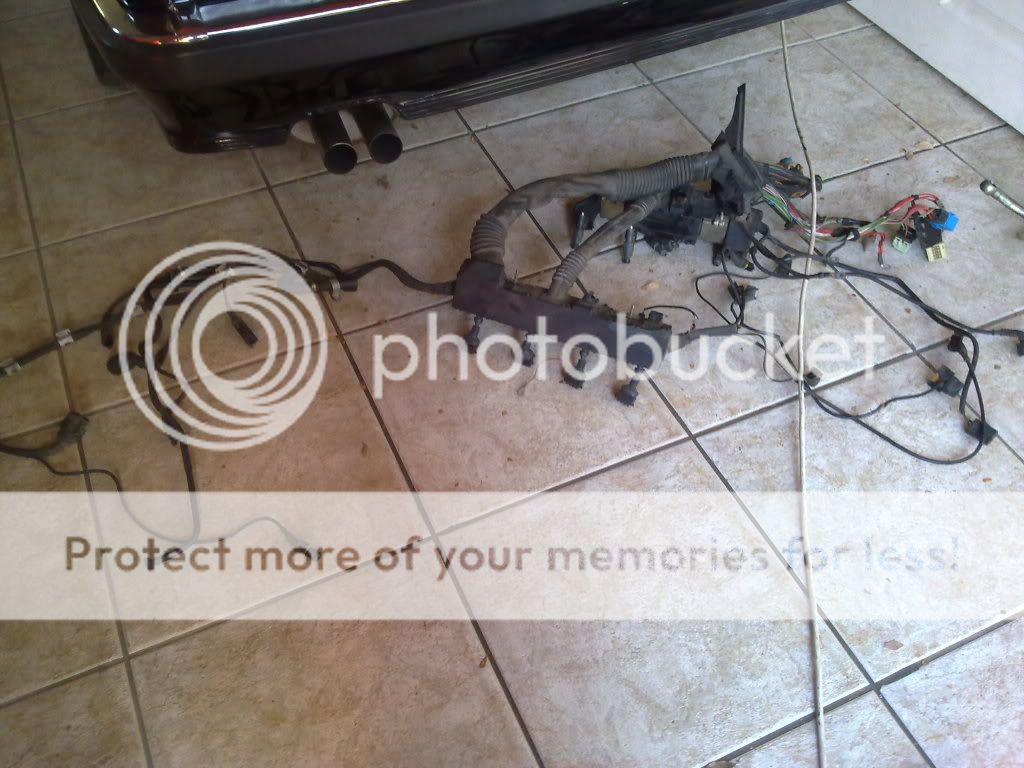

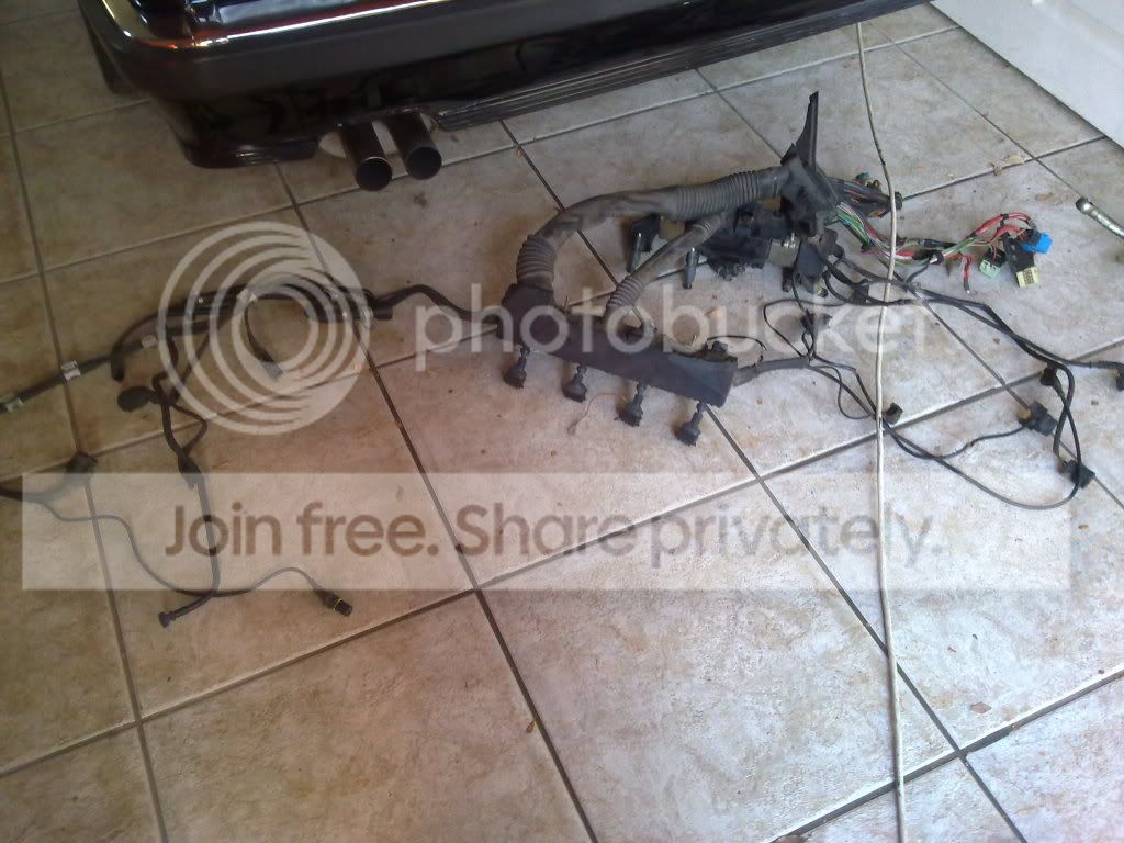

A pic of the wiring harness.
I applied some heat on to it prior to total removal from the gearbox and engine.
For 12 years and +200km it is still in pretty good condition.
My intention is to clean it with paraffin whilst keeping it "warm" with a hair dryer and lay it out in what would be its normal position.

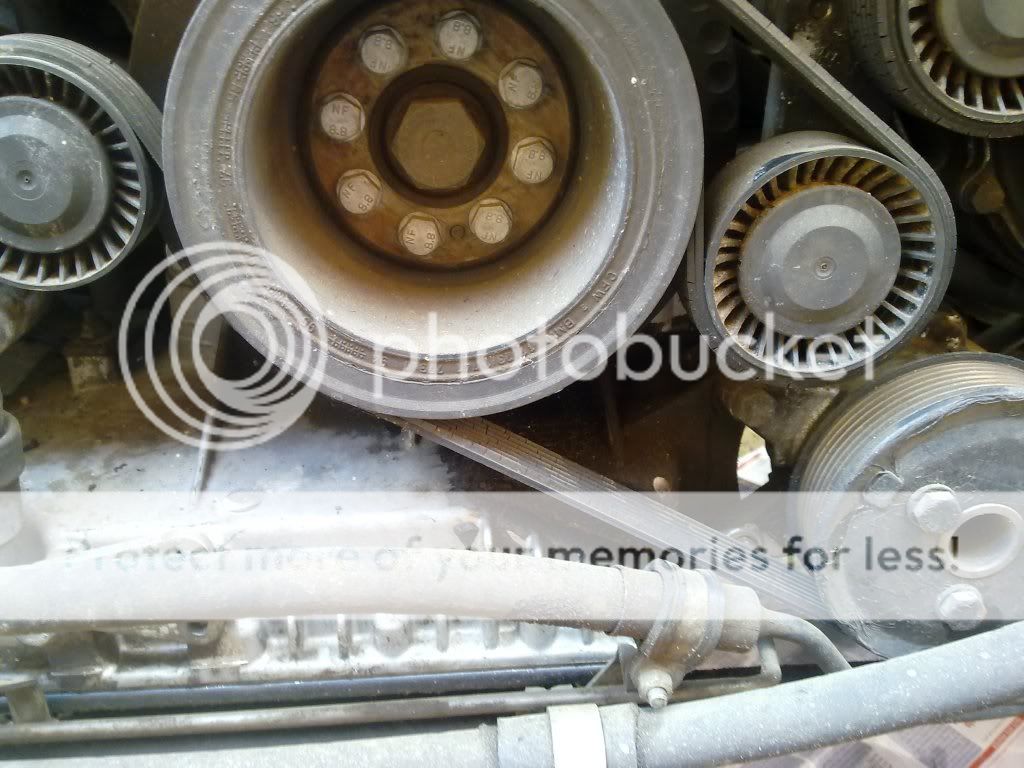

You are correct the bottom stud was loose and had drifted away from the exhaust manifold thus causing a leak mixed with oil from the cylinder head cover gasket.
It is a bit of a mess now that I have had a close look at it.
I want to search and find if I can loosen the Vanos system in such a manner so as not to buy the special tools which are close on to R6000 as I will only use them once and it will be a waste of money.
I recall some time back that I had read somewhere that if the motor was placed on to Top Dead Centre one could remove the Vanos unit and replace it without the special tools?
I guess a bit of searching is in order.
If anyone knows about it please give me a shout:thumbs:
